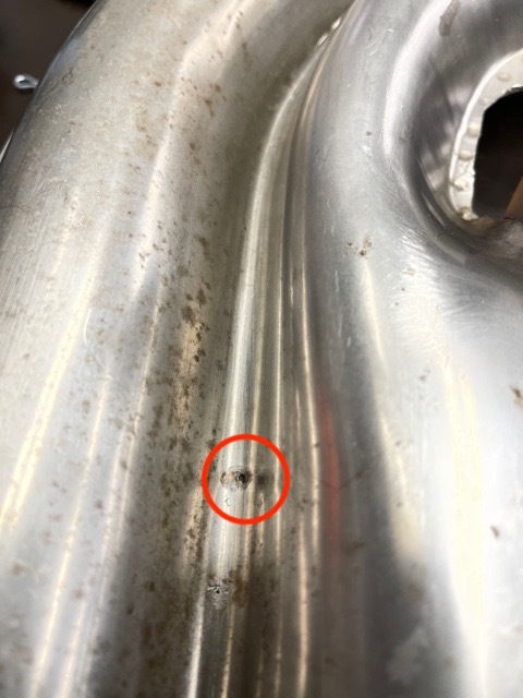

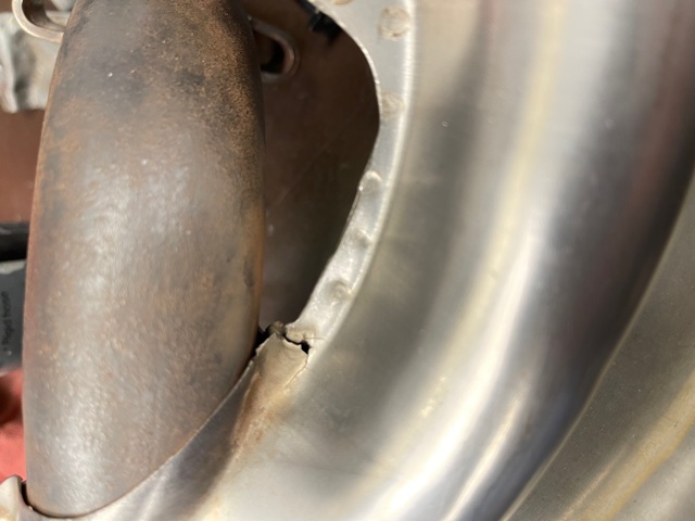

I noticed a tiny hole and a couple of little cracks on the edges of one of the exchangers. Is this cosmetic or something that needs attention?

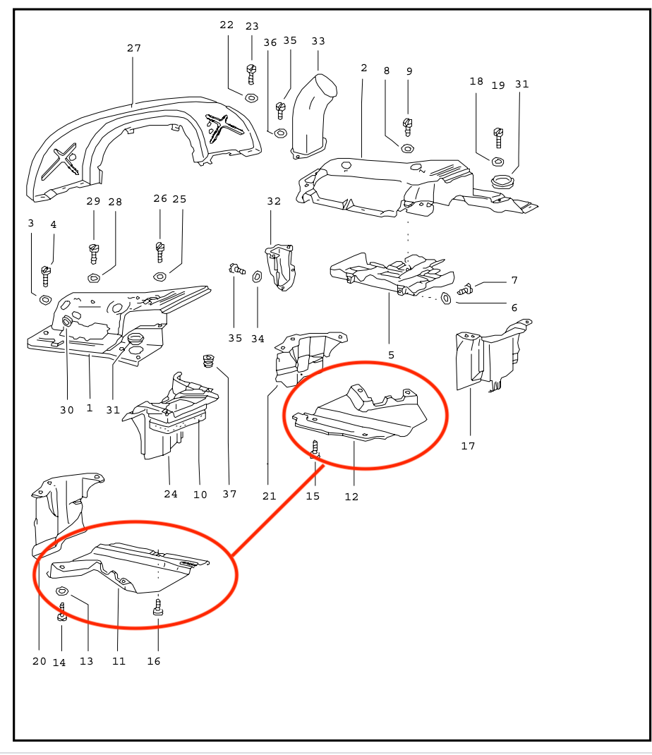

And of course the Tins, do they go on before or after the exchangers? I have found a spot for most of the other tins, and these are the last two. Please don't tell me I have to remove everything to get them on... ha.

Pinholes or cracks in the outer shells of the exchangers are fine and will only result in losing a bit of heat. The ones in your photo are minuscule and you won't notice and difference in the cabin when the flappers are open.
If the exhaust pipes within are cracked, throw them out. The only way to test them is to do a pressure test to find out if they leak.
The tin you've circled in the diagram fastens to the underside of the exchangers and are installed after the exchangers are installed.

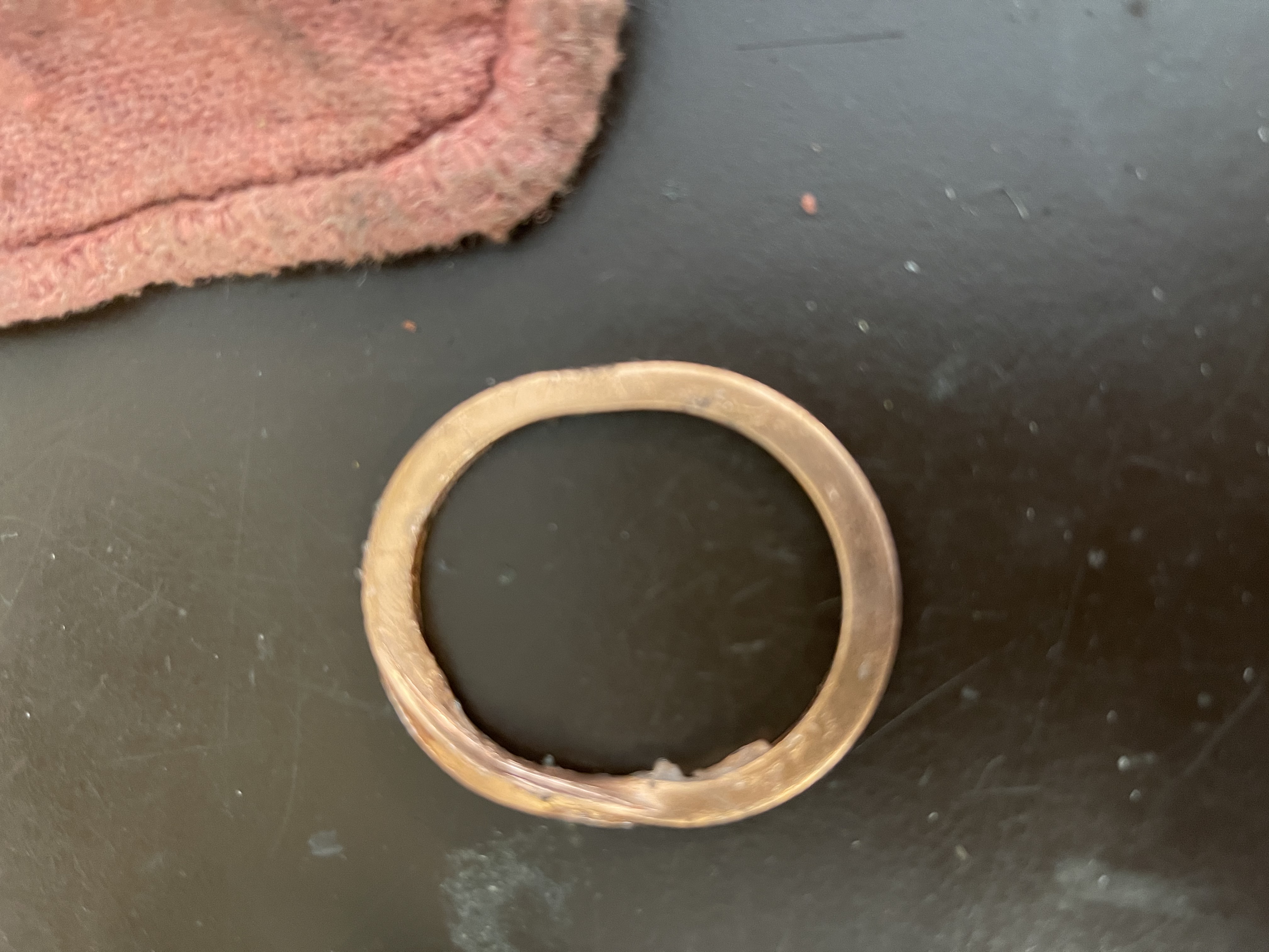

Speaking of close calls on a much lighter note my ssi install averted a catastrophe by going light on the torque and checking the copper washers positioning.
Had to take the right side heat exchanger off.
And there you have a washer that wasn’t on correctly. Luck would have it I was able to pull it out without damaging the head. Sorry for the blurry pic.
Double checked ssi level and put in a new copper washer (I used Vaseline to make it stick) and guided the ssi back into place and torqued everything down.
Left the torque at 12ft lbs. everything looks good now.

Nice catch on the copper gasket.

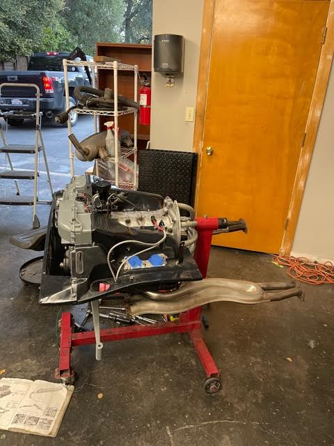

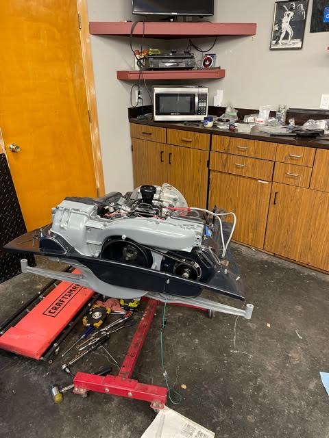

Here's a couple of pics of my progress on the engine.

What year is this diagram for? 75?
Parts 32 and 33?

The DR side WAG in the illustration is for a tailshift. SS the rear rod runs below the curve. Pass side is common for TS and SS.
