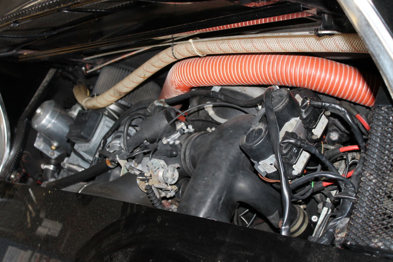

I'm talking about the fan, located in the engine bay, used to push air through the Heat-exchangers. When my engine was in the previous car, it had a system seen in the photo below. I don't remember if it was a good solution or not, and believe I have since lost the fan.

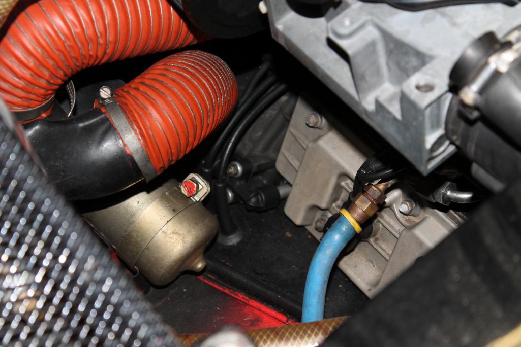

Originally, the previous installation had the heater-tube going up and over the engine. To make it look cleaner and supply more air-flow, was thinking to put a blower on each side of the engine, supplying each of the ducts that lead to the cabin, photo below.
I wasn't aware the motor in the photo was a stock 914/4 part, shows how much I know. I'll put up an add in the classified section. (IMG:style_emoticons/default/bye1.gif)
