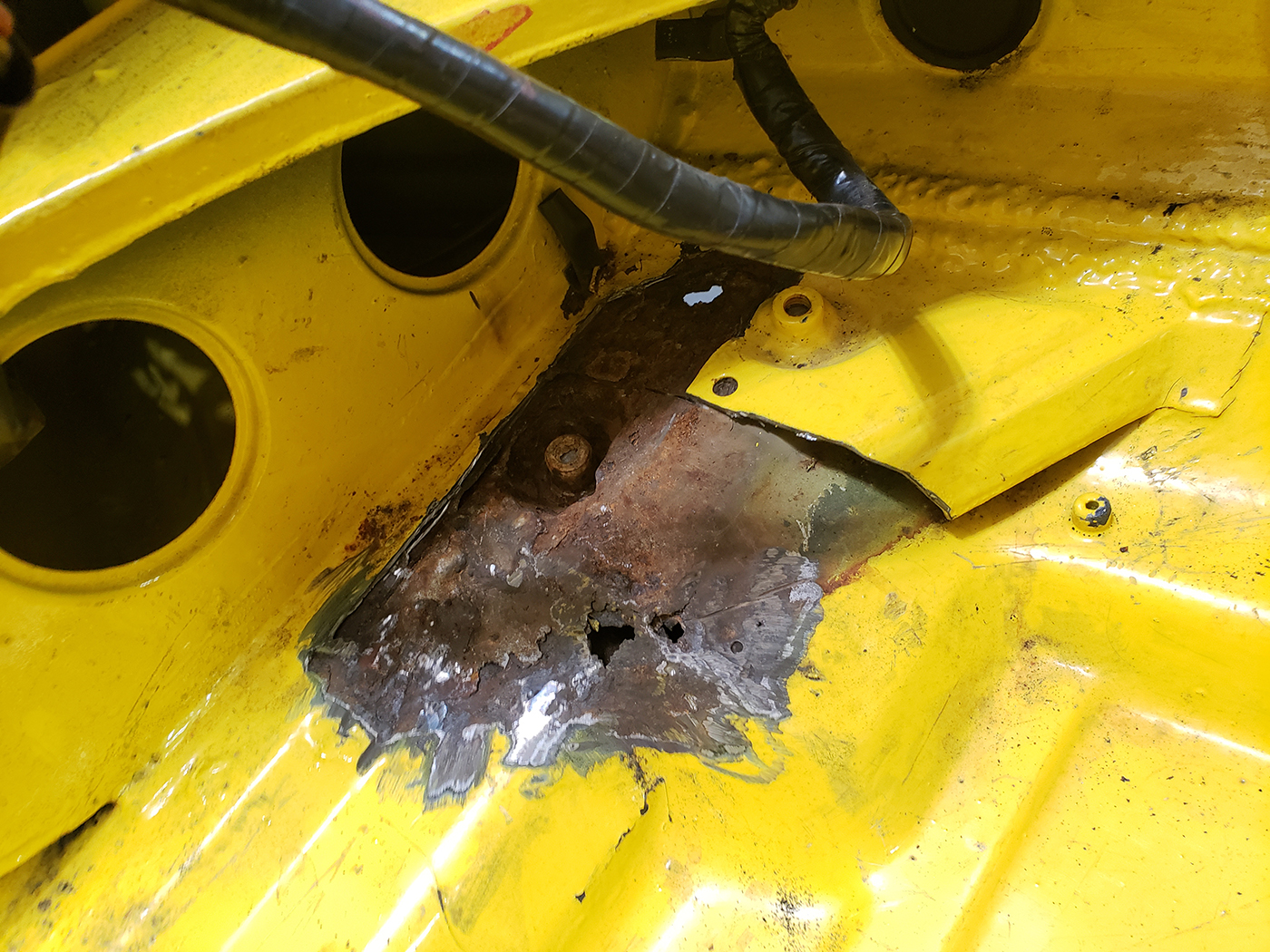

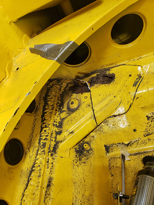

Has anyone done this repair?
I have to get in to the sheet metal of the trunk on the drivers side as it is through the whole way.
And I also need to replace the brace pieces
Any input on what you did is appreciated.
Fab patch panels by hand?
graft in section from a parts car?
are any of these parts available from a restoration company?

Not a normal rust point in my experience.

I think resto design might have the piece you need. Like sixer said, it’s not a common rust spot so probably on a lot of parts cars.

Look at RD website they have everything that you will need to fix that. Don't bother with a parts car section. New metal is the way to go after all it's holding your front suspension in place.

I agree with mepstein and Luke M,
I found the same issue when I was rebuilding my 1972 last year...I started with "custom patch panels" and found metal thinning in several areas.
Wound up buying the front pan section as well as the passenger front triangle piece (mine looked like it trapped moisture between the two metal panels and corroded from the inside out).
Good luck!

I agree with Luke. If RD has the metal, it's the way to go.

Be cautious about the positions of any replacement pieces. If you move the suspension mount points it will lead to future headaches.

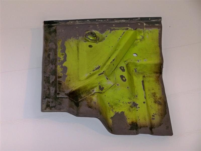

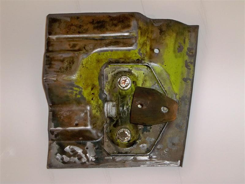

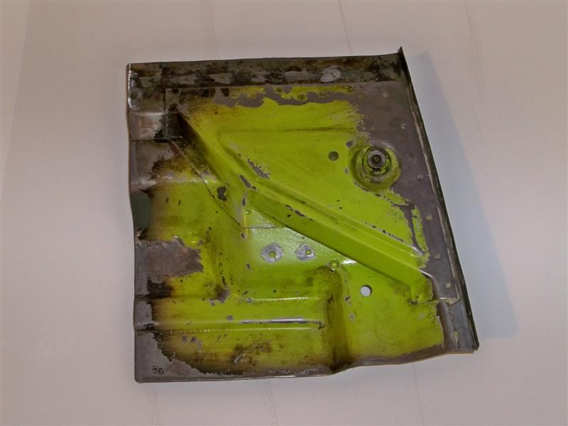

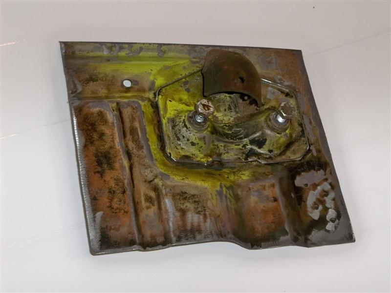

This is how I did it

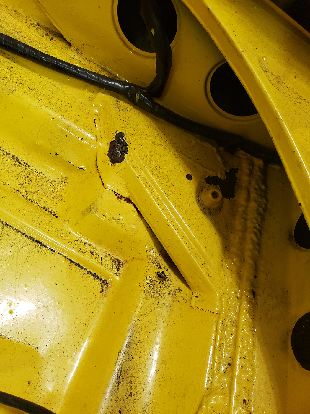

Check the inner fender behind the strut for flex creases.
Hopefully not.
Seems like it took a good hit on the mount.
