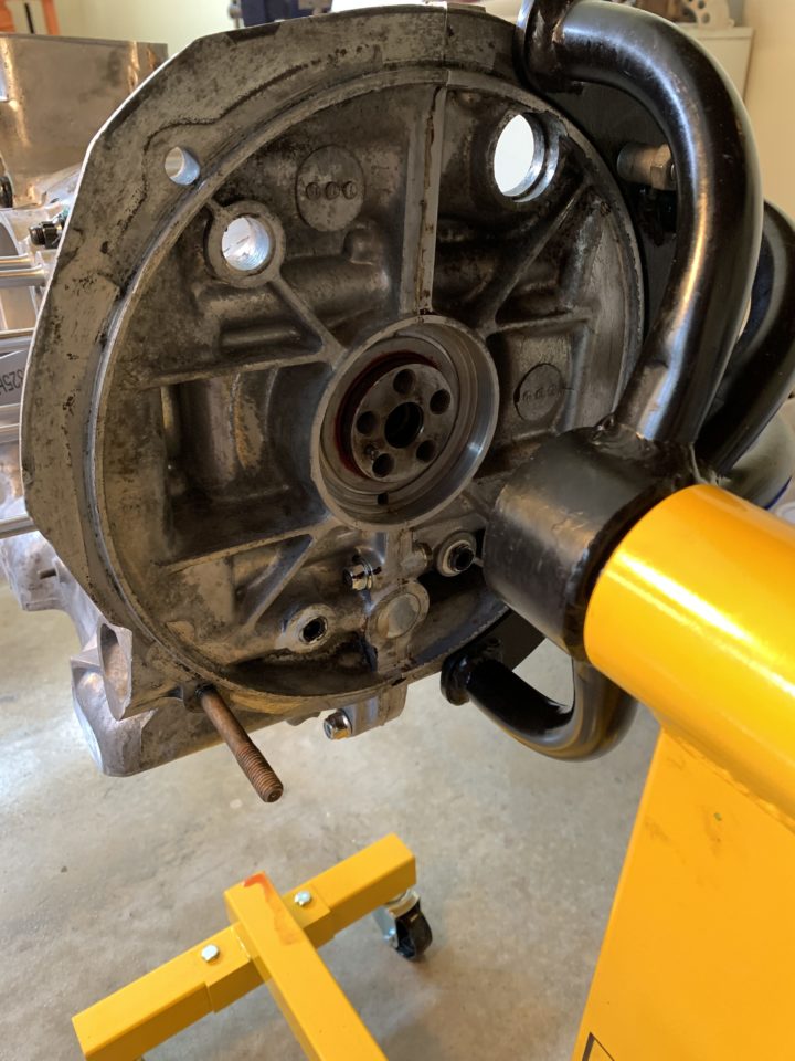

Well things have "progressed", even though it always seems like its two steps back and one step forward. I bought the Crower springs, and they look nice. I had intended on doing the guide boss machining myself, but then this happened:
(IMG:http://www.914world.com/bbs2/uploads_offsite/www.patsachs.com-7353-1619882899.1.jpeg)
Seems like the theme of this thread. I should change the title to "Broken studs of all sorts!"
So I dropped both the heads off at my machine shop to get the springs fitted and to have the stud bits removed.

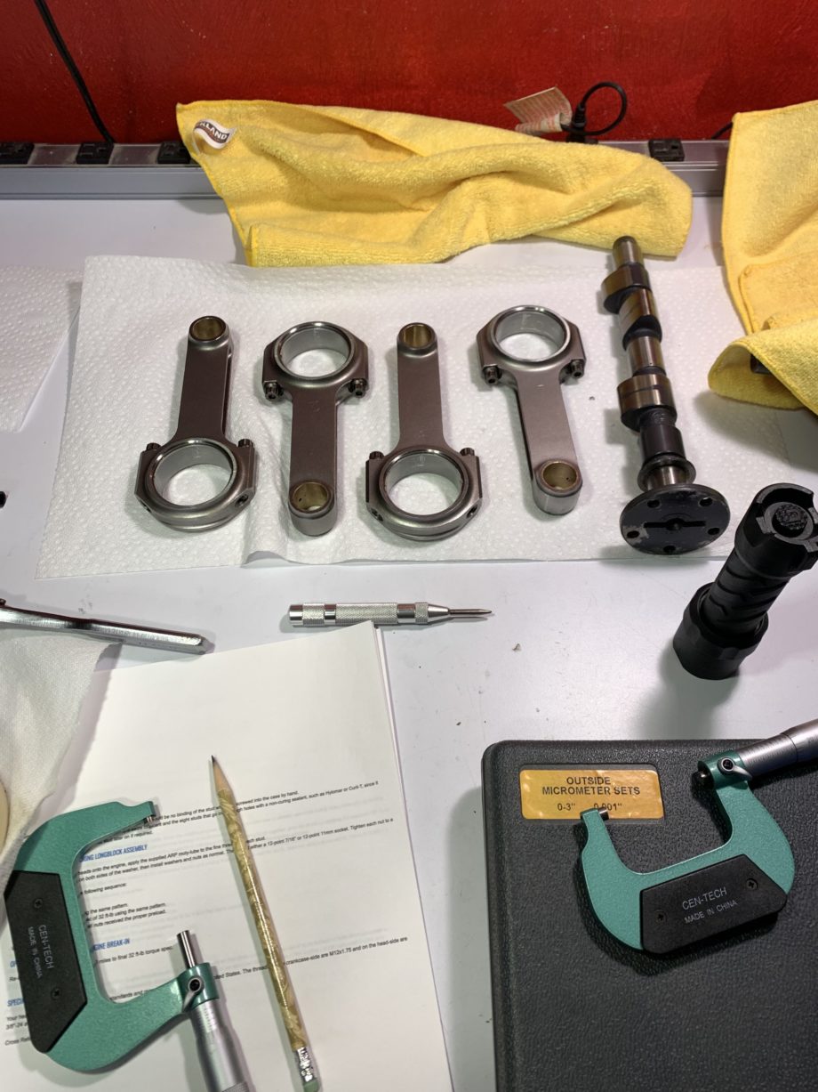

I mic'ed for the second time: crank, rods (these were balanced/clearanced for me, so they were perfect), bearings, and the engine case. I had done this already, but wanted to practice the "measure twice" principle, especially since I did that almost 10 years ago, lol. Luckily everything seemed good, and I was getting about ~.0025" clearance on the rods, and .003" on the main bearings. So those are at least good to go.

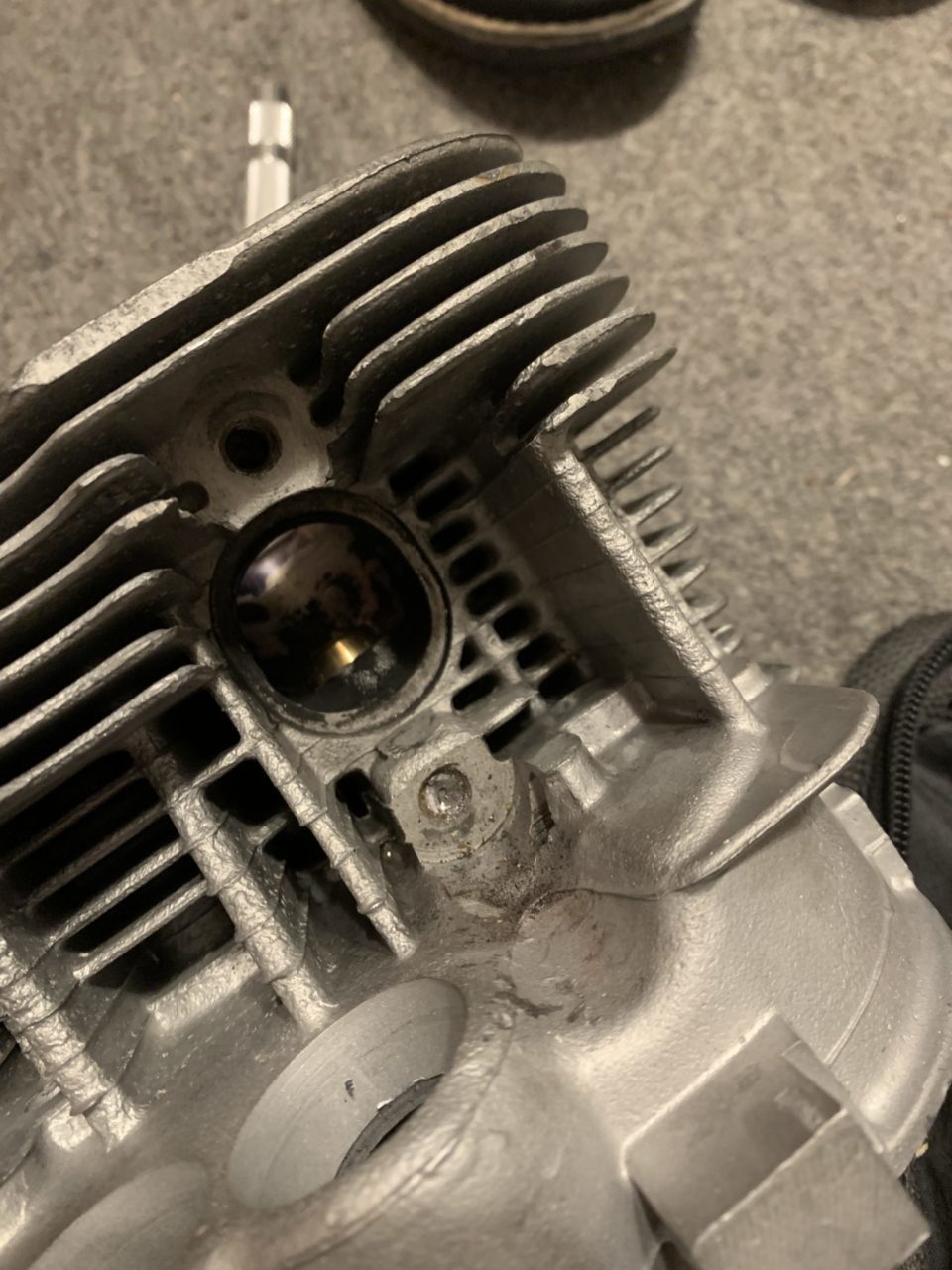

I finally got all of my head issues solved. I had the same machine shop get that broken stud out that did the stud from my case. They do great work. While they were doing that I also had them install these:
(IMG:http://www.914world.com/bbs2/uploads_offsite/www.patsachs.com-7353-1629386540.1.jpeg)
So they are good to go!

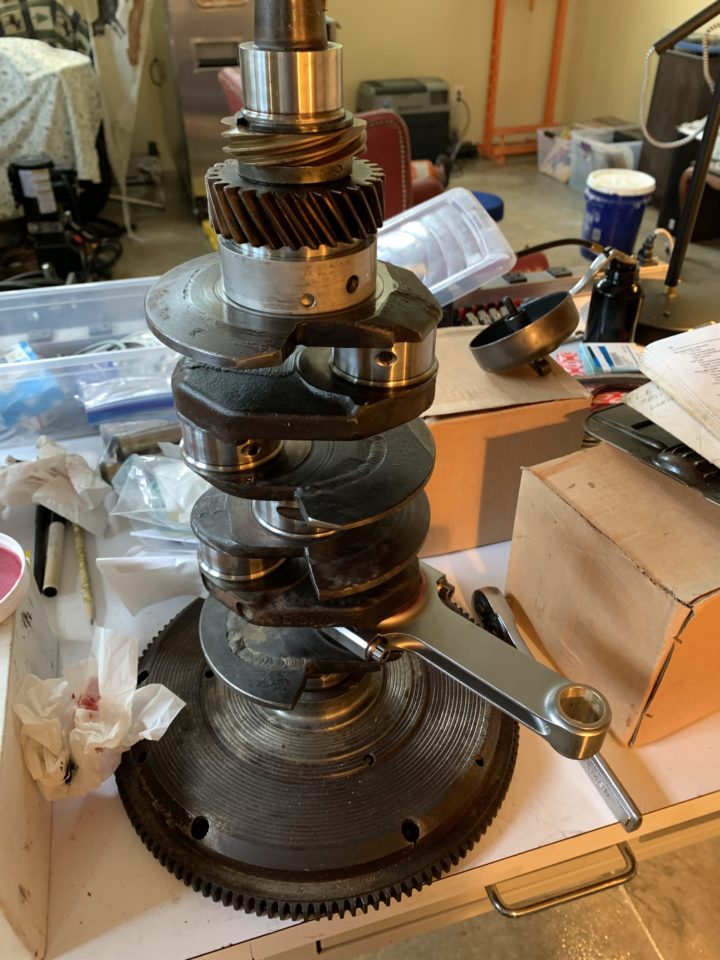

I managed to do the final assembly of the crankshaft and rods.
(IMG:http://www.914world.com/bbs2/uploads_offsite/www.patsachs.com-7353-1629470932.1.jpeg)

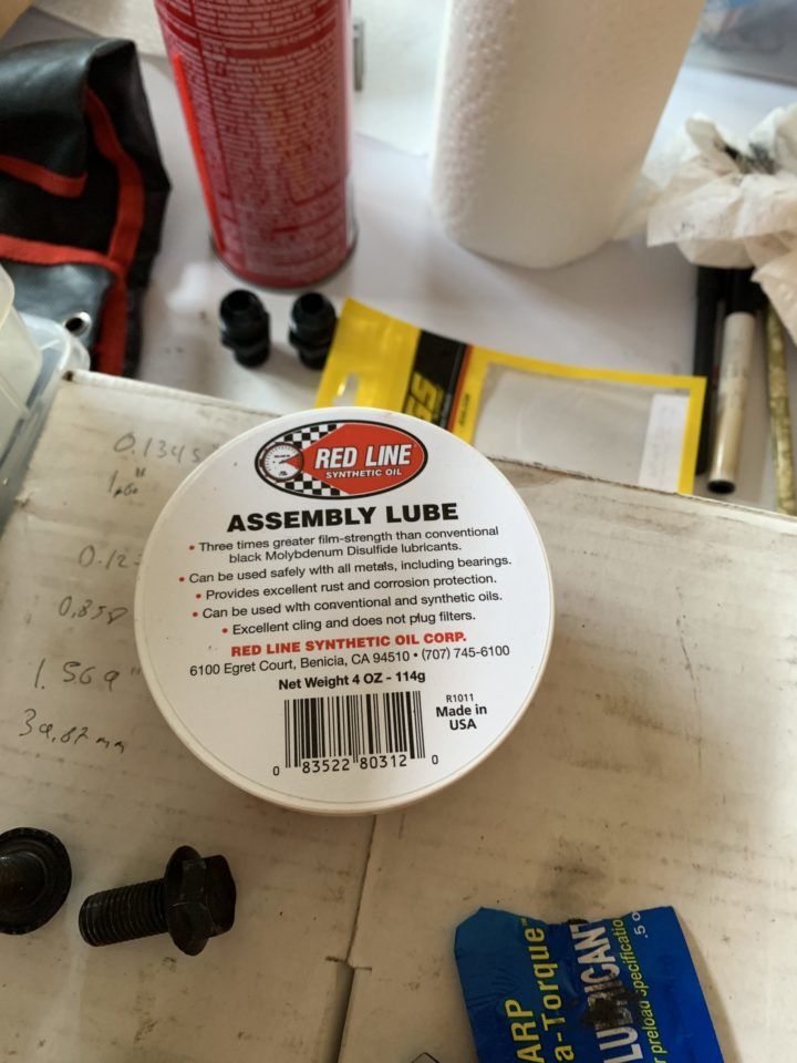

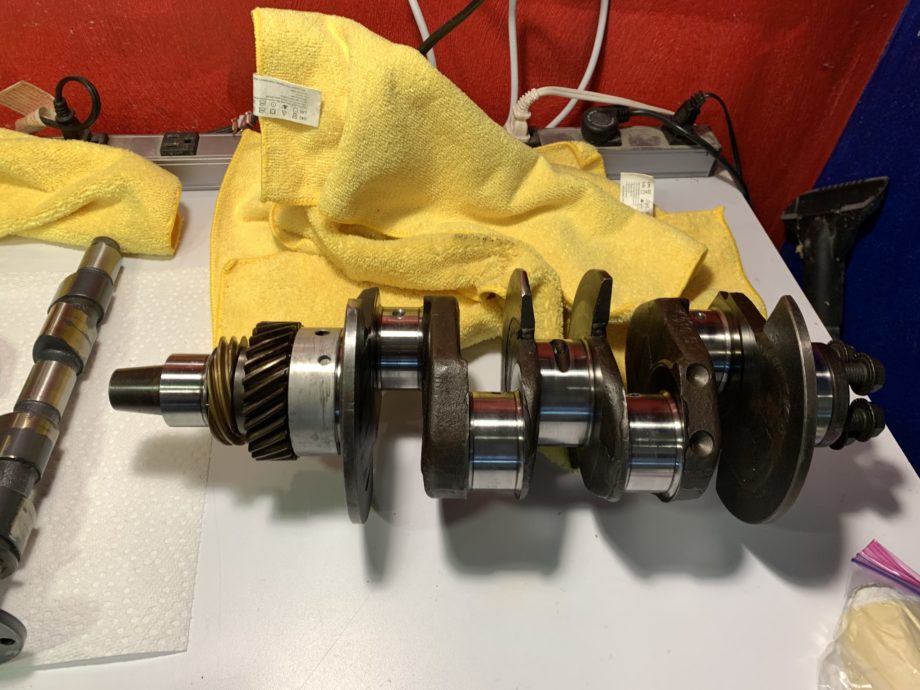

Then I lubed everything I needed to lube with these fancy products:
(IMG:http://www.914world.com/bbs2/uploads_offsite/www.patsachs.com-7353-1629470933.2.jpeg)
(IMG:http://www.914world.com/bbs2/uploads_offsite/www.patsachs.com-7353-1629470934.3.jpeg)

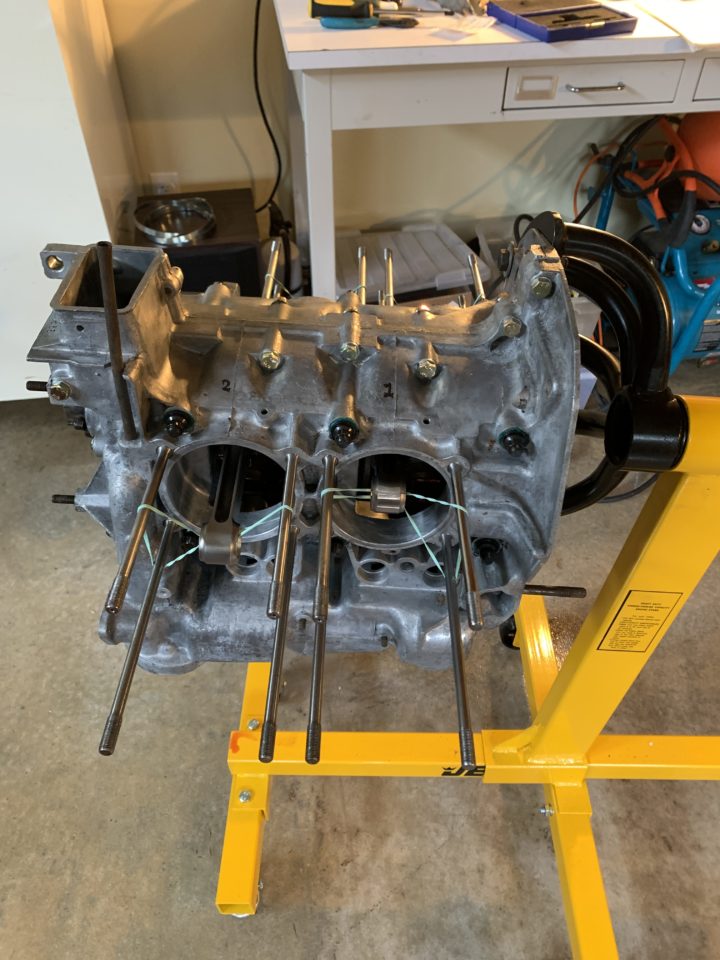

And then assembled it all into a single package using the "type 4 store" recommended sealing (Curil K2 for case). They have been sitting so long apart, I was amazed at how easy they slid together:
(IMG:http://www.914world.com/bbs2/uploads_offsite/www.patsachs.com-7353-1629470934.4.jpeg)

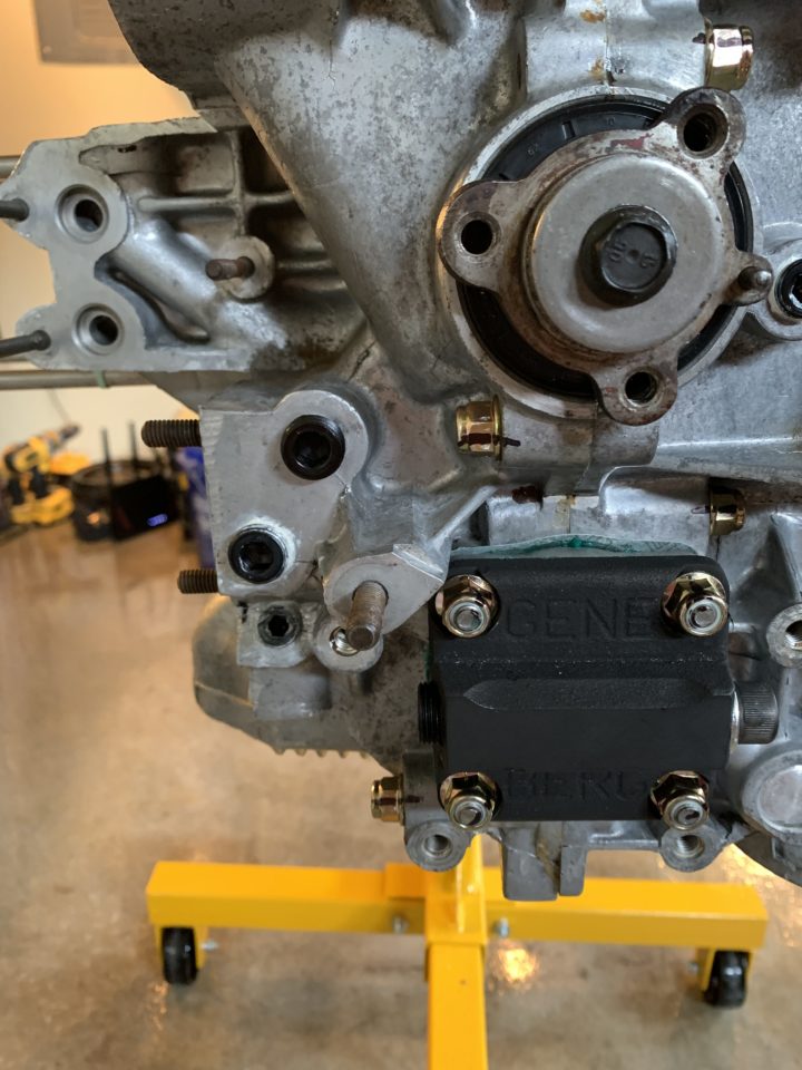

I then turned my attention to the oil pump. I had installed a set of the longer studs, so when test fitting everything seemed to go together well. I had to do some further clearancing on the pump back as well as my cam bolts, which surprised me as I bought everything claiming to be set up "for type 4 engines". Anyway, the pump I decided to go with was a 30mm Schadek from the type 4 store:
Oil pump (full flow)
The reason for this was I decided I want to run a front mount oil cooler, and a full flow system. I installed the pump and cover, and I did something that I couldn't find any reference to elsewhere. I used a very thin coating of Curil T on the pump body and with BOTH gaskets. I dont want any leaks. We will see if this works. All installed and buttoned up. If anyone manages to read this far: I used the same Nylock shoulder nuts I used everywhere else on the engine, do I need to put sealing washers behind these?
