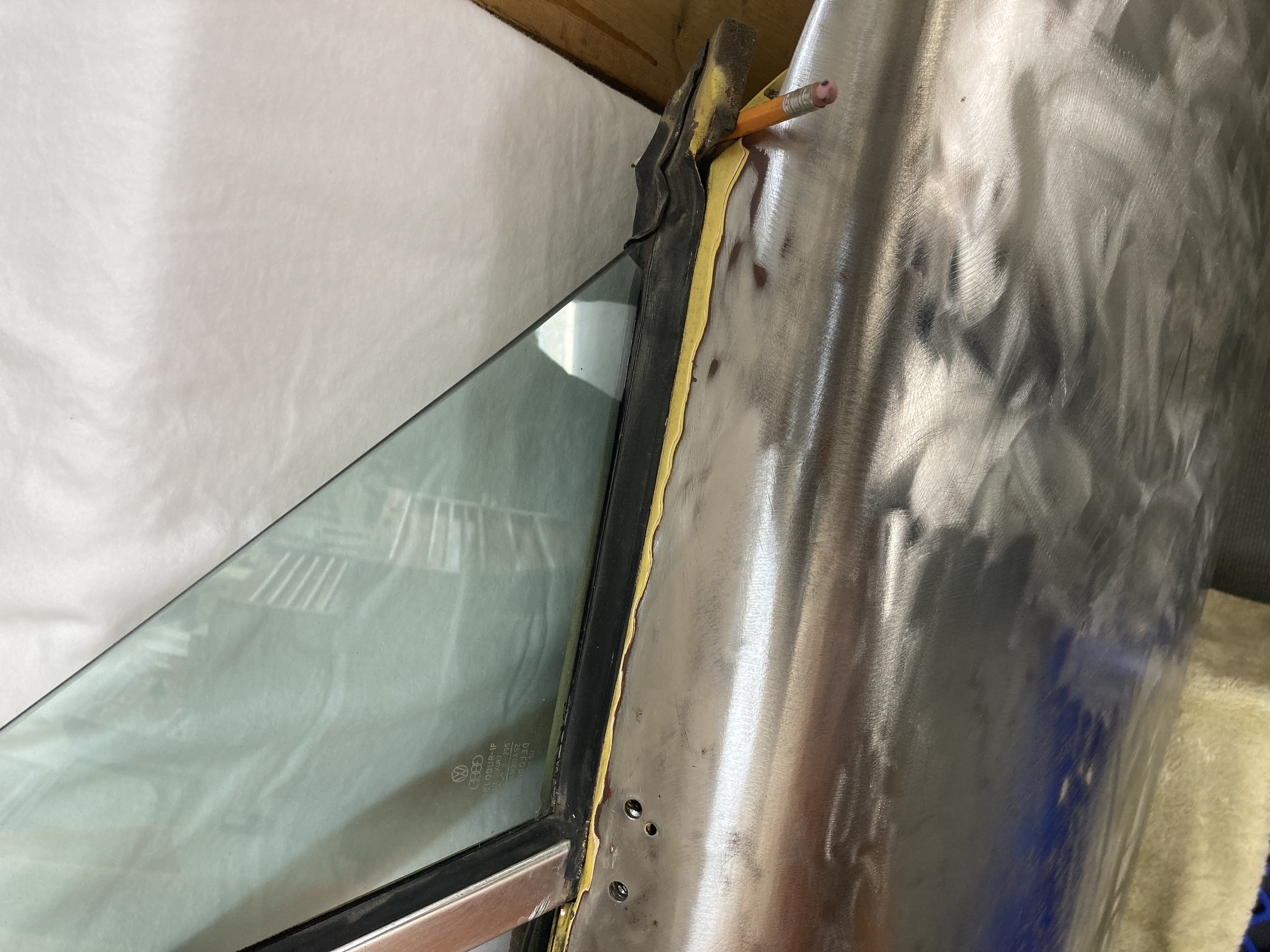

Trying to go to bare metal on a 1976, to prep for painting. Would like to remove the seal around the triangle door window for ease of cleaning and painting. Not willing to go to the trouble to totally remove the window frame and mechanicals. The question is; "How hard is it to remove and replace that seal without breaking it?" Pic shows window with pencil under the end of the seal. Would appreciate any help.

I doubt you can remove it without first taking the frame out
remove the lot, its not that big a deal

Remove the plastic cap on top of the triangle window. Pull the top of the triangle forward toward the front of the car to remove it from the seal. Remove the seal. Done.

The plastic cap is separate from the seal and held on by one or two phillips scews. The fun part will be putting that little window back in. Not a fun job.

which is why I think its easier to take the frame out, there is a nut (13mm IIRC) on the inner door panel (the door card needs to be removed) and a couple of phillips screws underneath the door

I'm not sure about that. The seal is wedged in pretty tight to the door. It's easy to get the triangle back in the seal on install. The hard part is hammering that seal down without the triangle popping back out. I've never tried pulling one out with the window in place but I'd personally feel safer pulling the glass first. I do agree the whole mechanism should come out for a bare metal respray. I think it would save time in the long run.
