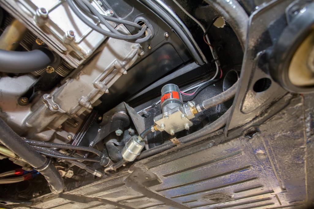

Good thoughts. Just for shits and giggles here is a pic of the current install. Should have done a front trunk install or maybe look for a quieter pump.

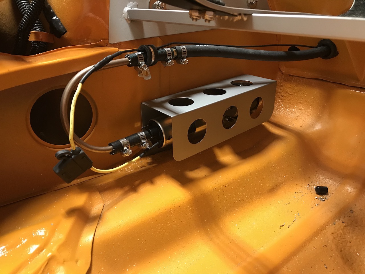

ON my GT Tribute I'm not staying on GT theme. so mine is upfront and only has the rubber insulated shield over the u-clamp. Under a Modified fuel tank with good access for service and fuel filter. I can only hear pre-start up. Best, MarkAttached Image

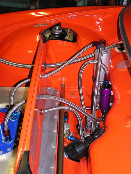

Here is my fuel system

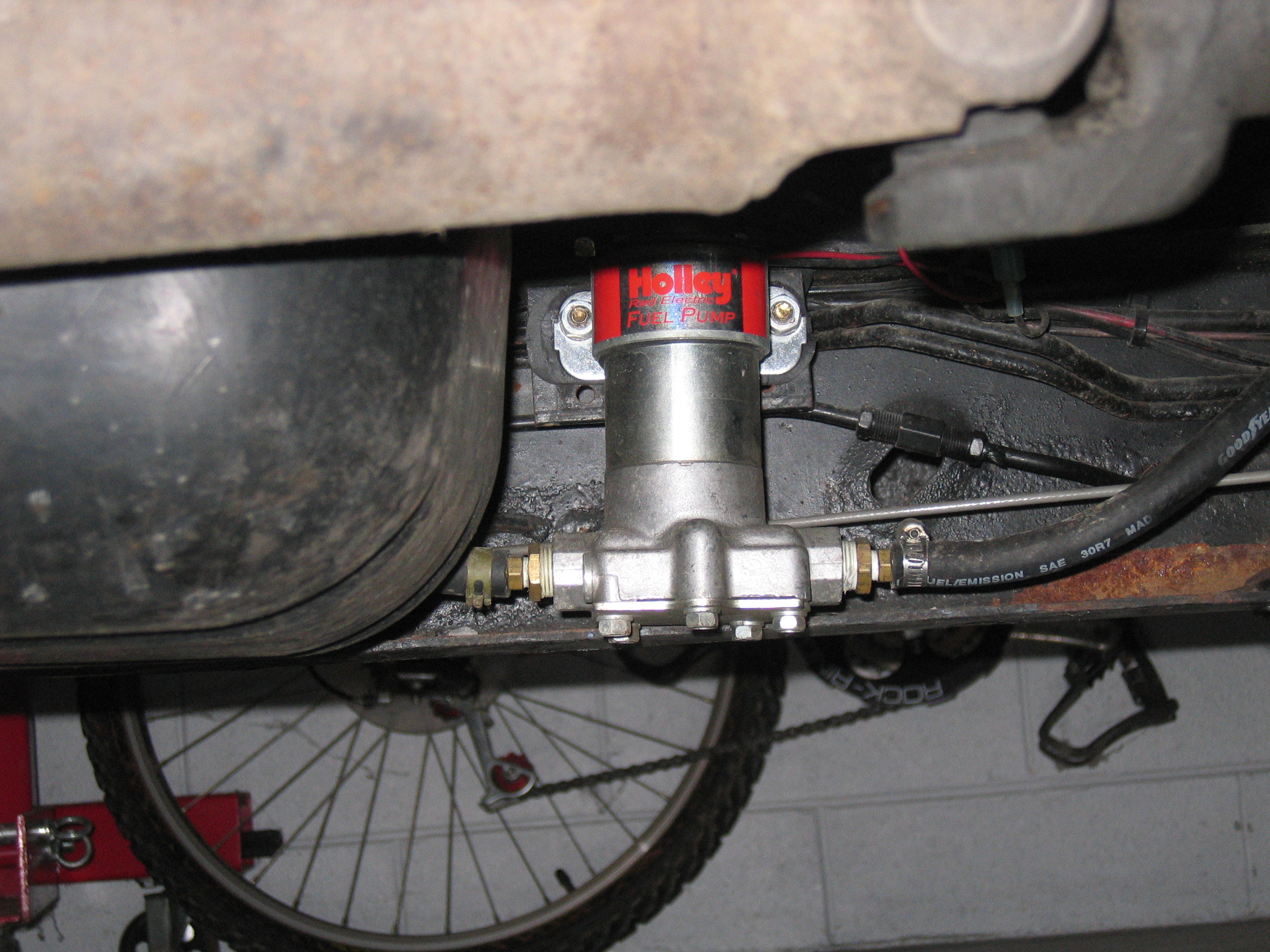

It's a frikkin noisy pump. I use it on my truck and it's mounted everywhere with rubber- the ring around the pump is rubber lined, the ring is rubber mounted to the bracket and it's rubber mounted to the frame (IMG:style_emoticons/default/dry.gif)
