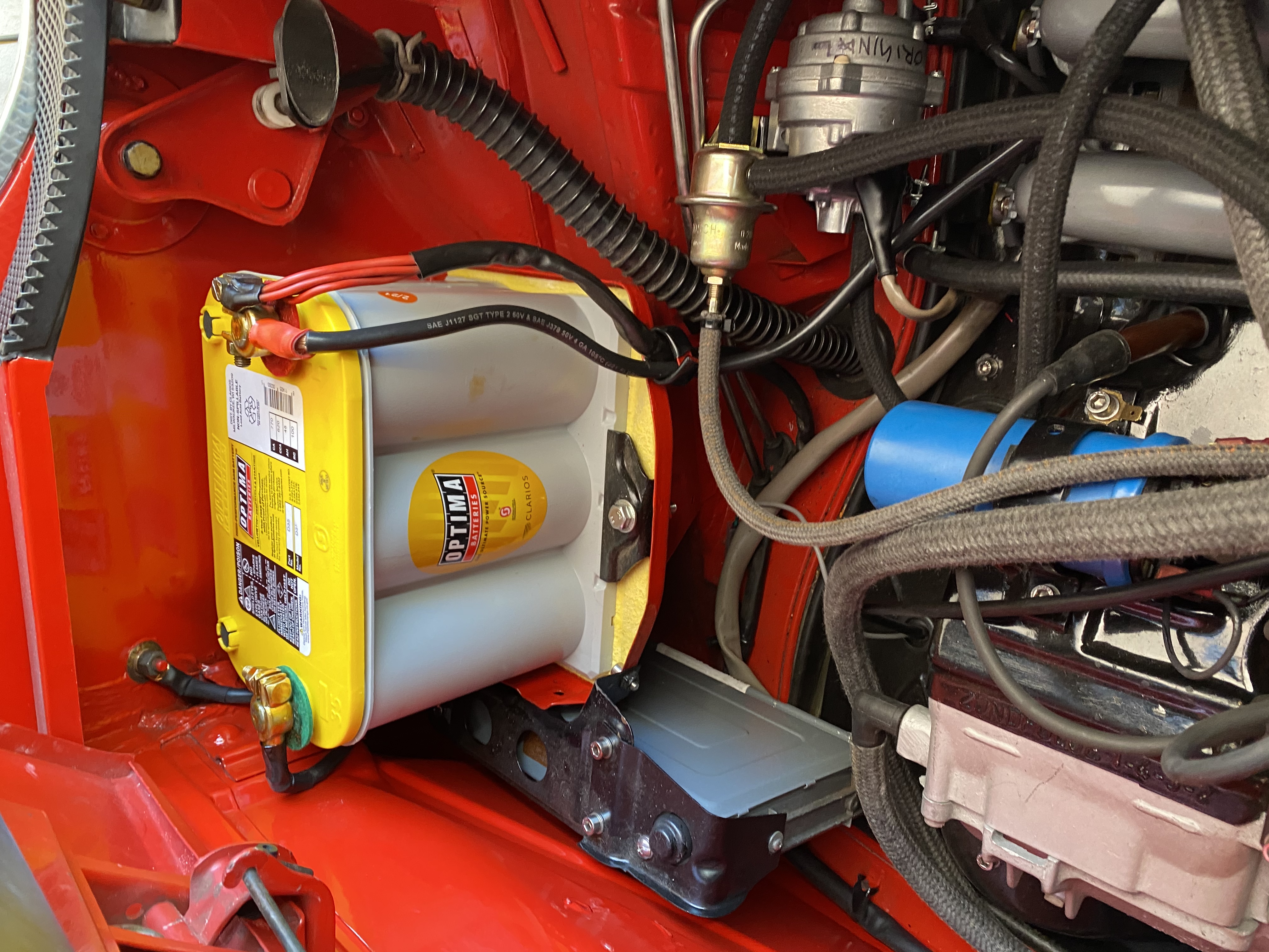

I installed a D36
It was a little tall so I had to reroute the positive battery cable a little bitAttached Image

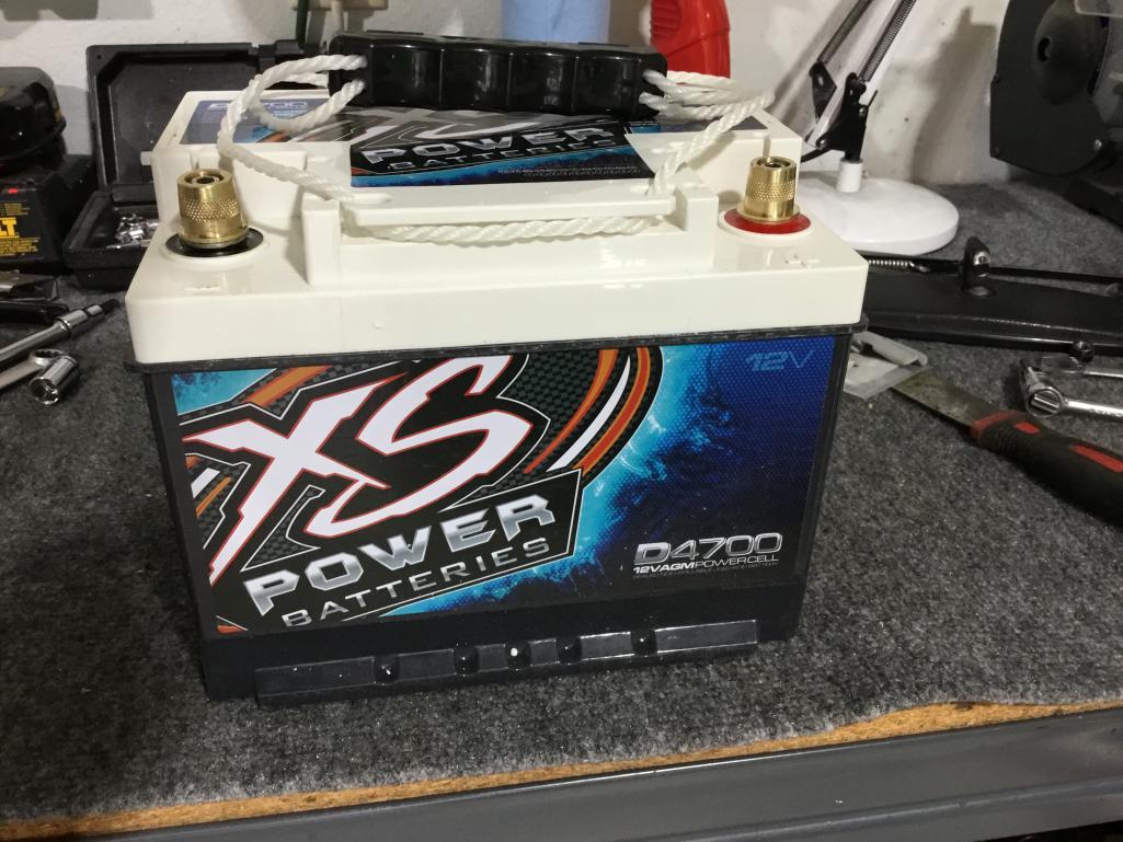

This is the one I put in my car and that I recommend:
I purchased this AGM battery made by XS Power (model D4700) from Jegs onllne.
$279.99 including shipping plus you need a set of $10 terminals.
Specs:
12-Volt
CA: 760
CCA: 668
Ah: 62, 2000W / 3000W
Max Amps: 2900
Reserve Capacity: 110 Minutes
Weight: 42.2 lbs
It fits perfect in the battery tray and the factory hold down works as it should.

Nice that it fits like stock, but that's expensive AND heavy. Yikes.
