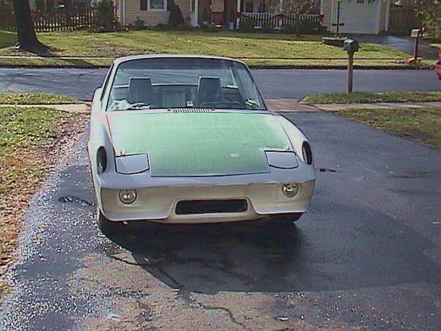

I'm looking for advise on going fiber.
I installed a Rennsport 916 bumper my '72.
I want to flare the wheel wells now. Can someone
comment on fiber flares 7", 9", 11" what size is best?
7 front 9 rear or 9 front 11 rear?
Converting to 5 lug seems straight forward but I need advise on
wheel offset and tire size.
I intend to continue to use the 914 as a weekend, good weather,
country road driver, (no concourse racing). Just want bigger tires,
little stiffer suspension, and evetually upgraded rotors and calipers.
My interest is to convert to higher horsepower after I finish the above.
