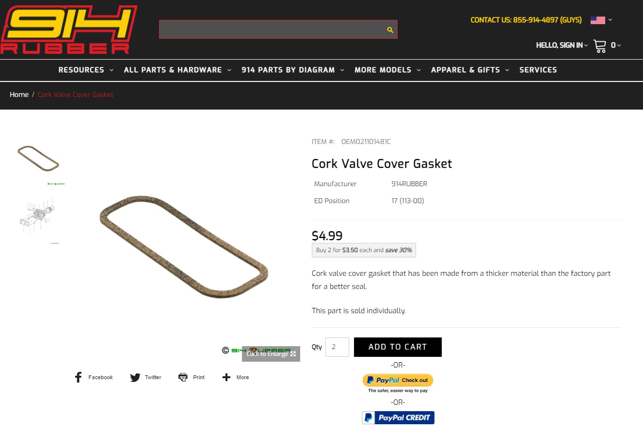

QUOTE(914Sixer @ Aug 12 2021, 12:45 PM) *
914Rubber used to have neoprene gaskets but I do not see them on website.
We have made the cork version slightly thicker to allow for the bale to be more relaxed. If the surface is flat they should be your best option. They cost more to make, and most go cheap to the VR brand. Yes they are inexpensive, but the bale is a known issue.
This is the one you want - https://914rubber.com/cork-valve-cover-gasket
Mikey914

Thank you everyone for the great input.
I did geek out and read the tech article link provided by GregAmy. Thank you!
My VW logo is upside down, which is stamped on the outside. What I don't know if it is upside down on the inside. Hopefully inside and out are the same.
I am ordering up another set of 914 rubber gaskets, that's what are currently on them now.
Initially when I installed them they didn't leak but after putting about 10 miles on the car the valve covers started to leak.
Certainly not a quality issue of the cork gaskets, but user error on the install.
The bail wire lock thing for the cover is extremely tight. Not sure how I could tighten that up even more.
