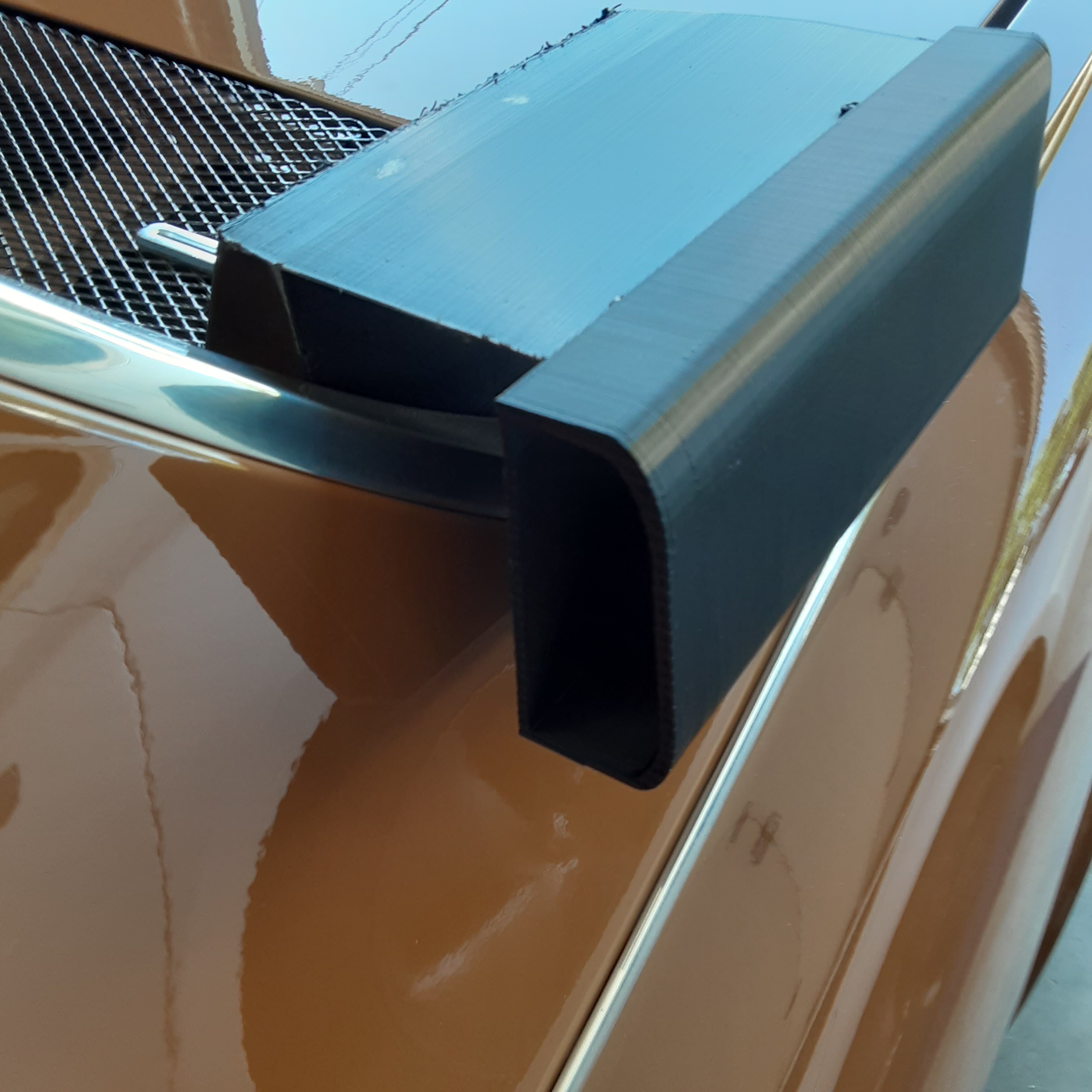

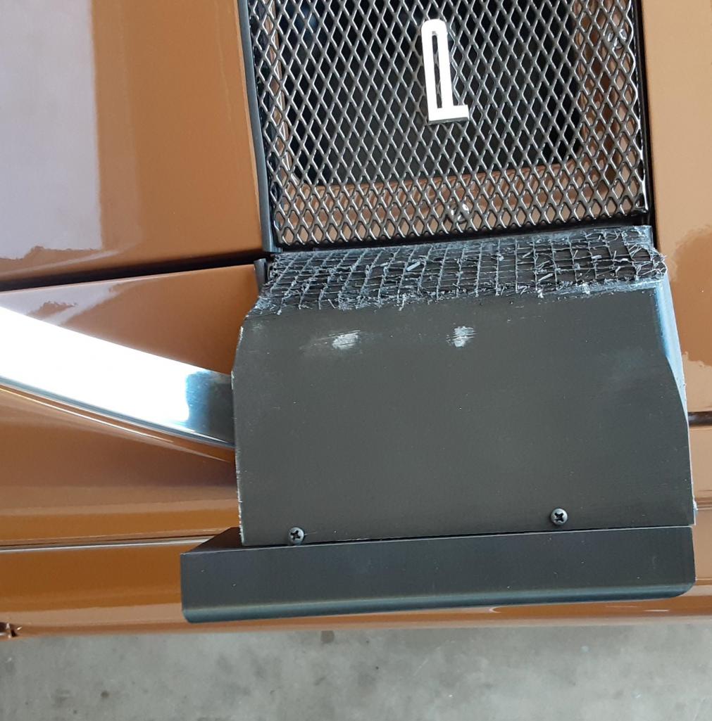

I'm guessing it's been tried, but is there a downside to forcing fresh oncoming air into the engine compartment? I've read that removing the rain tray does not help cooling which tells me the 2 engine compartment side vents are more than adequate to feed the centrifugal cooling fan; so perhaps increasing engine compartment air pressure and reducing relative air temperature would help.
So don't laugh too hard at the pictures (IMG:style_emoticons/default/av-943.gif) It's a first pass attempt.

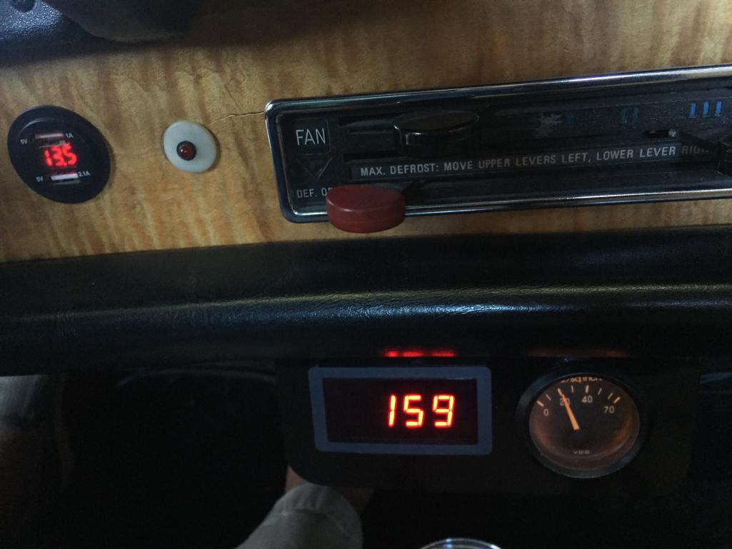

I did a couple of runs on my normal joy ride and am qualitatively seeing about a 5 to 10 degree head temp reduction and quicker cooling to normal temps after an uphill grade. Also cruising at 65mph in 5th I'm seeing about a 10 degree reduction in steady state temperature. I have a big hole in the back due to a 3D print problem and my duct tape keeps on flying loose so not getting full duct air. I just have a VDO head temp gauge on #3 plug. As many of you know the VDO has 50 degree hash marks; so not real accurate reads.
So is it correct that head temps are not affected by outside air temp, that's an oil temp thing?
Has anyone tried this? The stock grating is still in place. Can I be doing any harm?

I think Jake R said removing the rain tray made no difference to engine temps, so I doubt removing the lid would improve fresh airflow through the fan.
I'm just guessing here but my assumption is the airflow over the engine fresh air intake area does not provide an efficient supply for the engine compartment. By forcing air into one intake port, I'm hoping to provide a flow of fresh air to constantly evacuate the engine compartment (through the opposite port and seam leaks) and provide positive pressure to the fan intake.
I do need to redesign the intake for better fit, mounting and printability. Still learning the capabilities and limits of the 3D printer.
Didn't want to reinvent the wheel if someone has already tried this and has results. Also wanted to get opinions if I could cause harm to my car of which are not obvious to me (IMG:style_emoticons/default/confused24.gif)

I would use a temperature compensated thermocouple setup on your #3 spark plug instead of your VDO gauge.
The VDO gauge, although good looking, has the connections between the K-Type TC and the voltage leads in the engine bay which will basically give you the temperature delta between your engine bay temperature and your head temperature, which is not accurate.
Using a new ring type TC with longer thermocouple wires would allow you to make that connection in the cabin which would be cooler and closer to room temperature (temperature at which the gauge is factory calibrated) but still hotter in the summer time than room temperature.
Having a temperature compensated gauge will ensure your head temperature measurement is accurate no matter what your surrounding temperature is.
In your current setup, changing the ambient air temperature in the engine bay may affect your reading independently of the head temperature.
The results of your investigations are only as good as the quality of your measuring setup. (IMG:style_emoticons/default/smile.gif) Good luck with your project! (IMG:style_emoticons/default/smash.gif)

Here's a much more accurate thermocouple set-up.
Components: J type TC with 14mm spark plug ring & 10' extension, Cold junction compensated digital readout all very inexpensive, look on E-Bay

I know the VDO gauge is not that accurate, but at least for the year + I've been using it it has been consistent. My understanding is that higher engine compartment temperatures would cause the VDO to read low. I can't imagine forcing fresh air in would lead to higher ambient, so at least my gauge will error "conservatively".
As to what I'm trying to accomplish: Just trying to find another way of improving our cars. I actually don't have an engine temperature problem, but lower head temps is always better. I guess the bottom line is I'm just playing and thought I'd share (IMG:style_emoticons/default/smile.gif)
