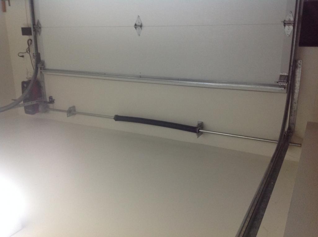

Let the answer to "how you will I use the lift most" inform your decision.
Is the 10 ft clearance inclusive of the door in its open position?
If the priority is for servicing the car only and not storing a car on it, then a 2 post or scissor type.
To service it and store a car on the lift over another car - 4 post - but with only 10 feet clear, you will be limited to another short car below...like another /6!
Bend Pack is a great lift maker.
PS I would worry about a 2 poster in our seismic zone unless its braced at the top, to the house.
PS...I have thought that a recessed pit with a floor level removable cover (steel plate?) and steps down into it would be an interesting solution for routine matenance. Not drivetrain removal.

That's a good point re the open garage door. I will do hi-lift doors like I have in my current garage regardless. I will measure tomorrow but the garage is deep enough, I believe that the 2 posts would be forward of the garage doors. But I will measure and figure that out. If the 2-post does not fit (I really think it will) then I would do another in-ground scissor lift. Mine is really easy to use and a really low-profile visibility lift. My wife thought it was a very good choice.

There’s a reason pits are no longer used. They are dangerous.
You can’t just attach a lift to your ceiling. If the lift did fail, you could potentially bring down your ceiling or worse.

Shops mostly use 2 post for mechanical repairs and scissor lifts for bodywork. It just depends what you want to do in the garage.
The nice thing about a two post is that a car can be stored under another

Look in to the Liftmaster wall mounted opener. 3800PLD is what I had installed during the garage finish. The space eating ceiling mounted drive motor and chain/belt track is eliminated. My doors clear the surface mounted lights by 1/2". The legs of a 2 post will fit in between the door lift rails. Subtract the car height, when on the lift before it hits the ceiling, from the actual working height. Attached Image

That Bendpak Grand-Prix is one sweet lift. I was considering it for my low ceiling garage and inquired about long term car storage and it's not recommended to use a two post lift even for overnight storage.
Do people do it, of course but there's always a risk involved.
The only manufacturer that will certify their 2 post lifts for car storage is Mohawk, they even have separate adapter that pick up the car under the tire to prevent suspension issues.
