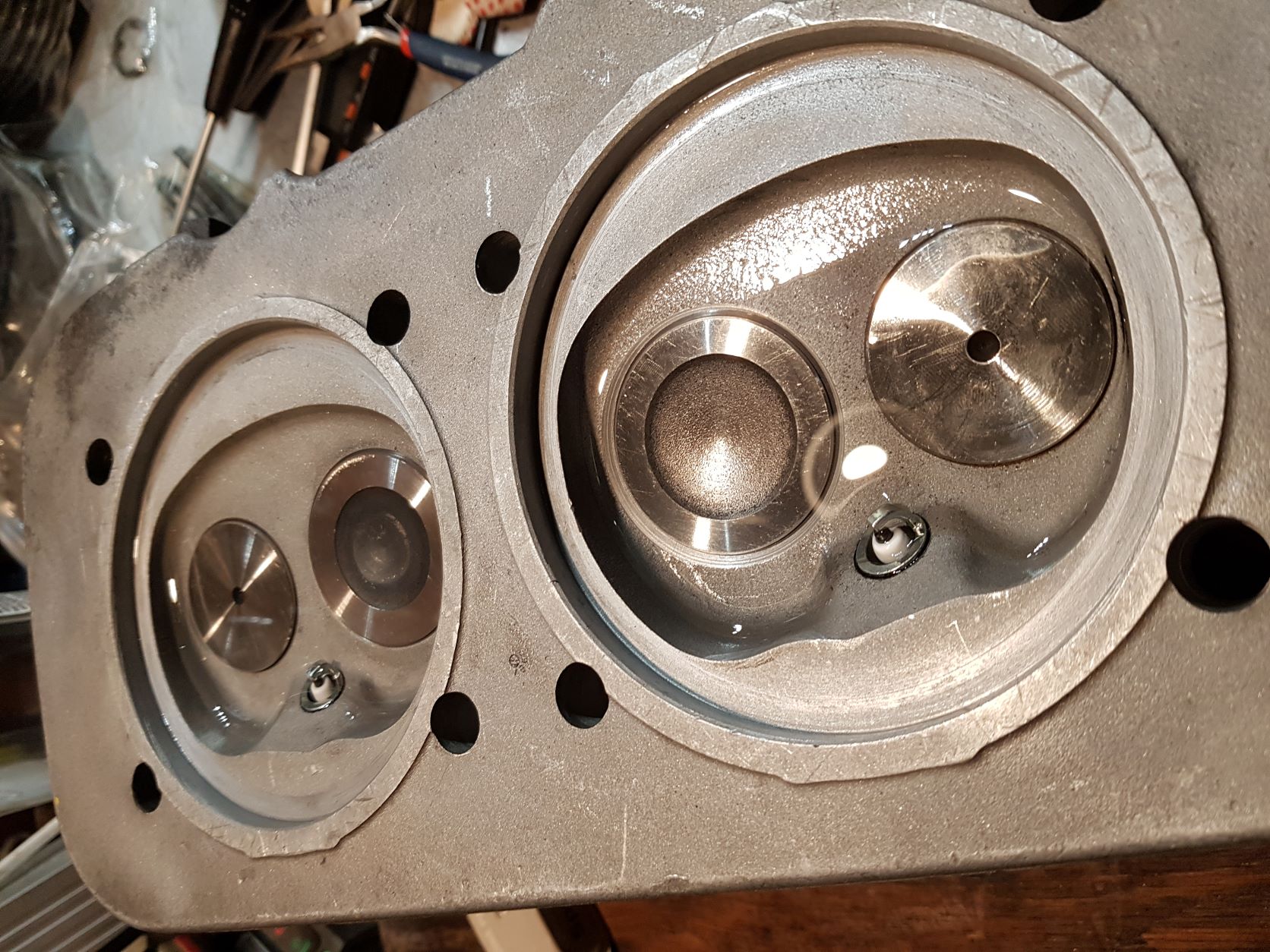

Still waiting on the heads from the machine shop, but halleluhua they are ready!!! and I can collect tomorrow, so back to engine for next update.

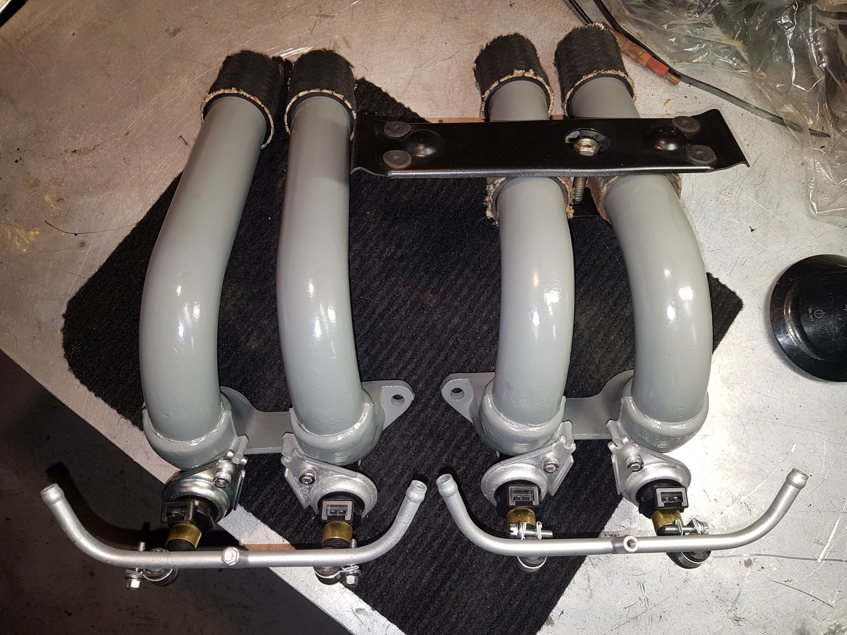

Since i was stalled on the engine front i was getting on with others jobs, intake runners and new injectors all ready, and then onto fresh coat of sunflower yellow on all the trim bits, wanted to outsource the wheels completely but no one would take them on, didn't like dealing with the metal rim, so got on with it myself , well with help of someone striping them, and polishing up the rims, I'm happy with the result cant wait to get them on the car after the paint dries for a few days more.Attached Image Attached ImageAttached Image
JeffBowlsby
post Sep 9 2021, 04:10 PM
Post #43
Posts: 9,222
Joined: 7-January 03
From: San Ramon CA
Member No.: 104
Recommend you rotate the injectors 90 degrees which will make the FI harness connectors so much easier to install.

Thanks Jeff, i had no trouble getting them in? well is been a few weeks and i pushing to get on the road before winter, thankfully our weather has been good and tomorrow will be big day.... putting the engine in.

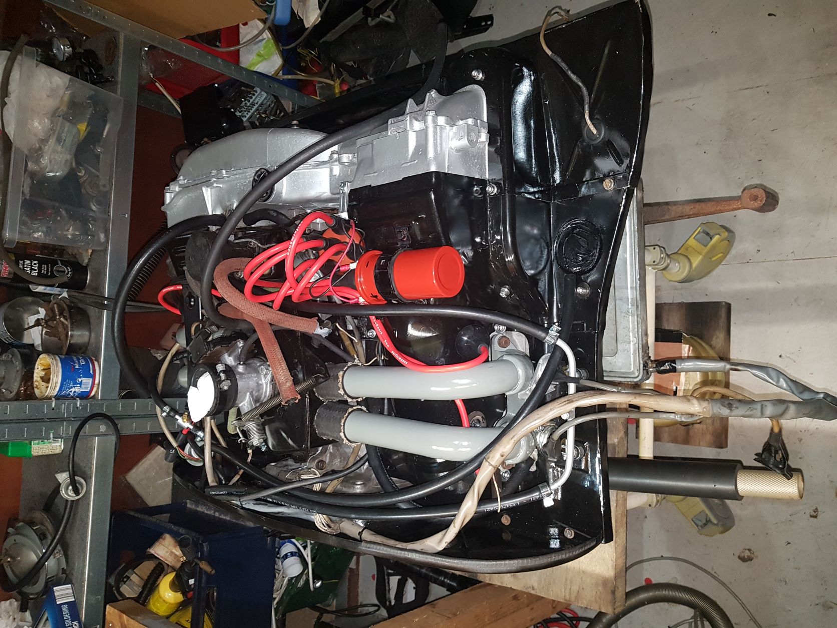

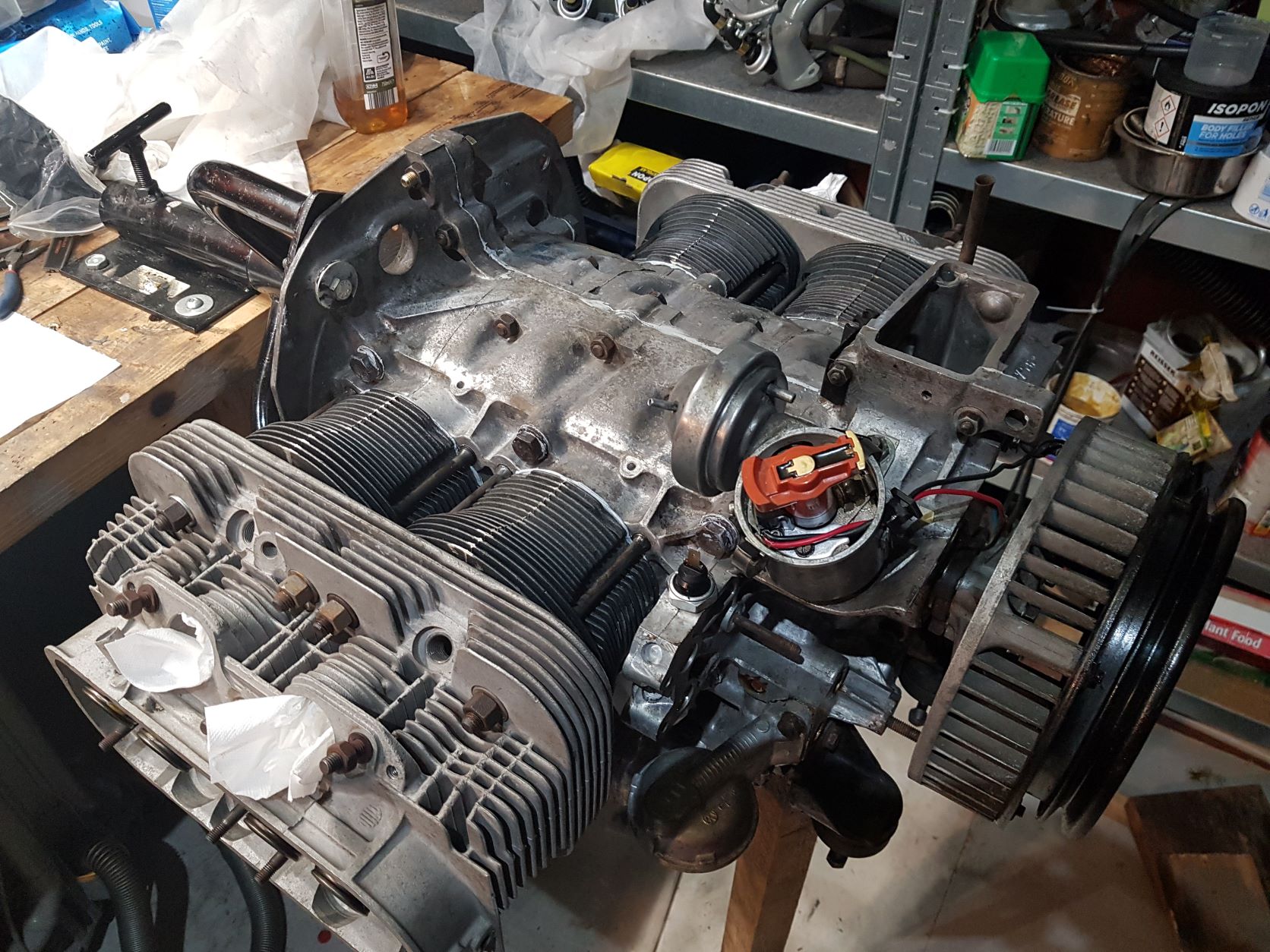

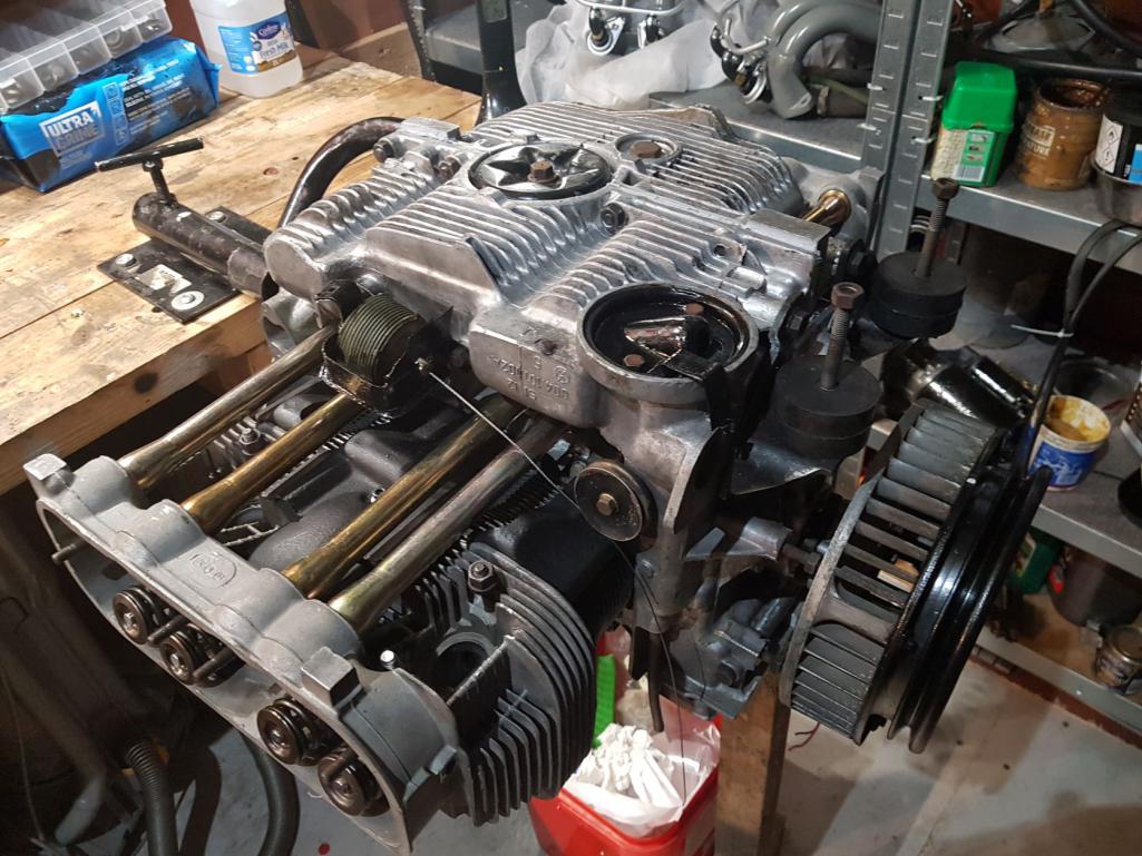

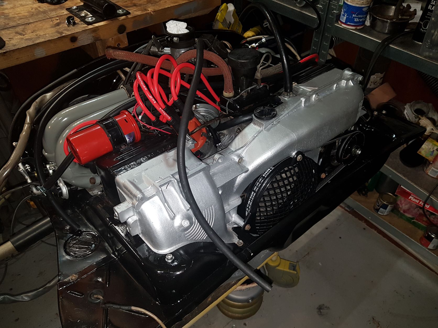

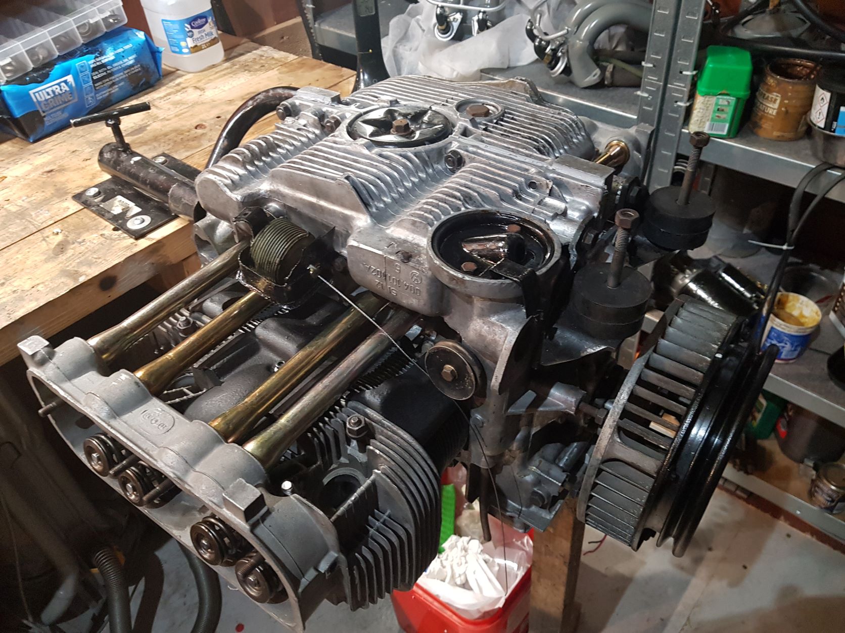

I finished the engine rebuild of the past few days, I'm keeping it mostly stock but have put revised cam (elgin 330-1) and new jugs and pistons 2056, did all the bearings new valves and guides so hopefully enough to see it through a good few years and give small power boost. i estimate 8.7 compression.
As space is limited I need to move the engine to near the car, and then mate up the transaxle and slide it in.
in between working on the 914 got a few days in Donegal with some other Porsche heads in the 928, some great roads and good to be getting out and about again!Attached Image Attached ImageAttached ImageAttached Image[attachmentid=808
937]Attached Image Attached ImageAttached Image

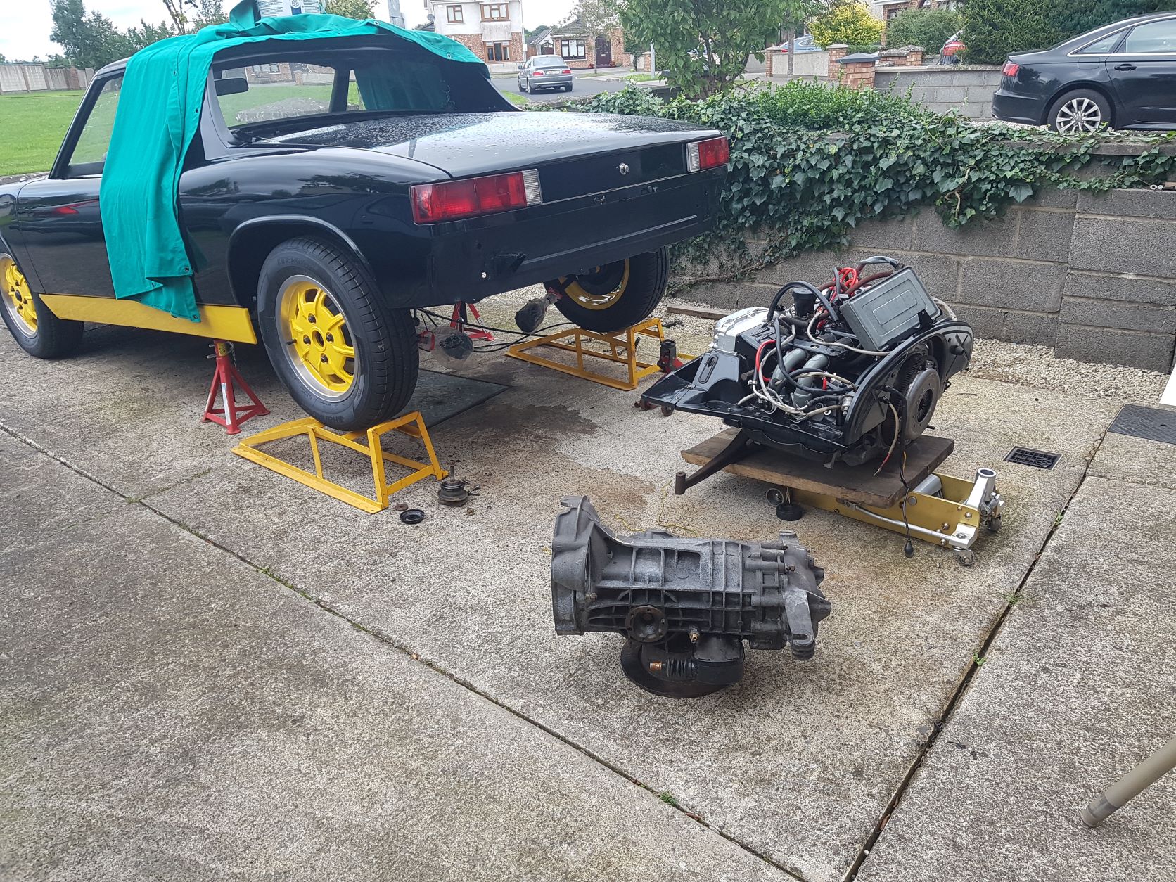

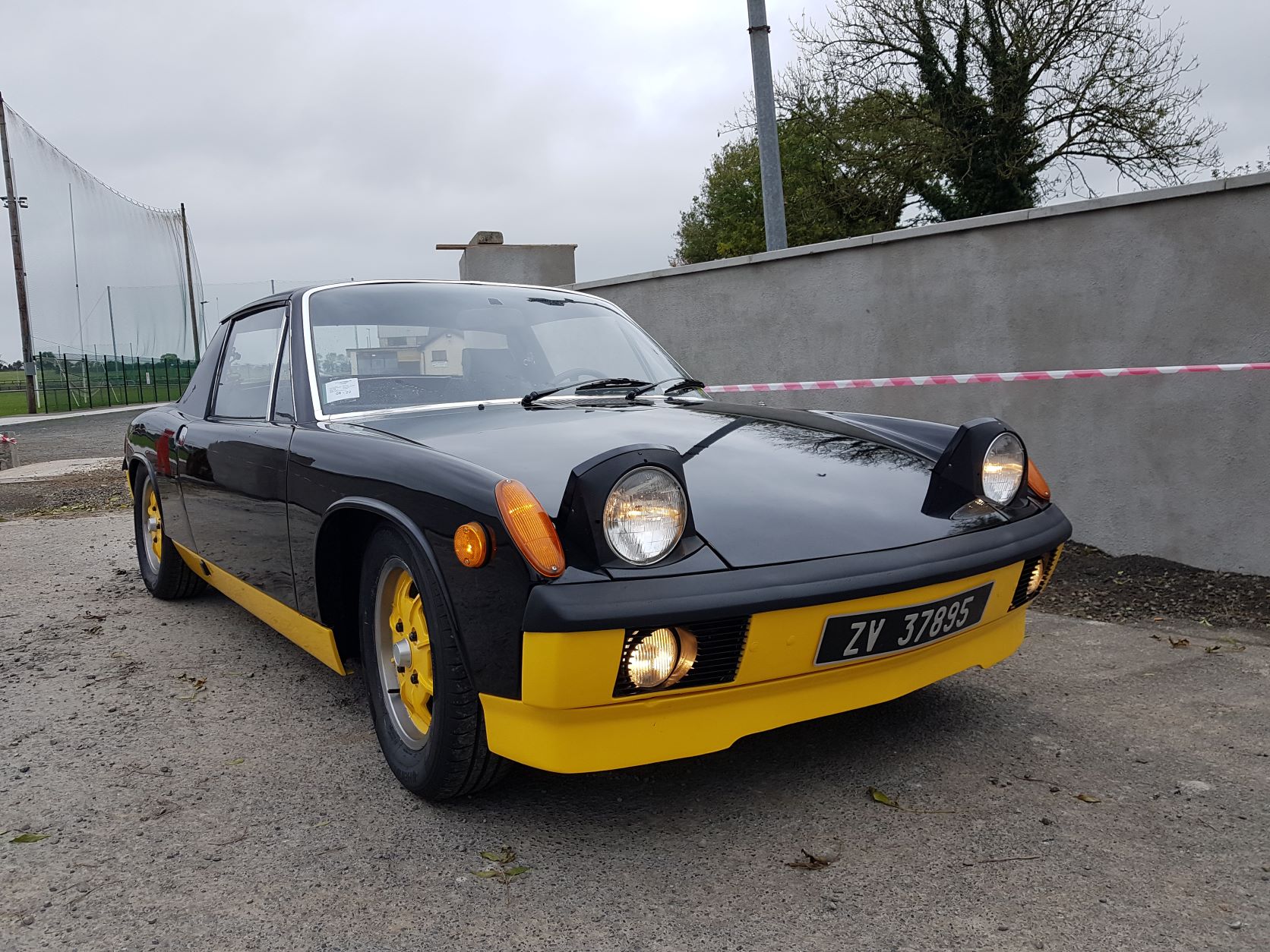

Took few days off work to get the show on the road, and as of today it is (IMG:style_emoticons/default/beer3.gif) .

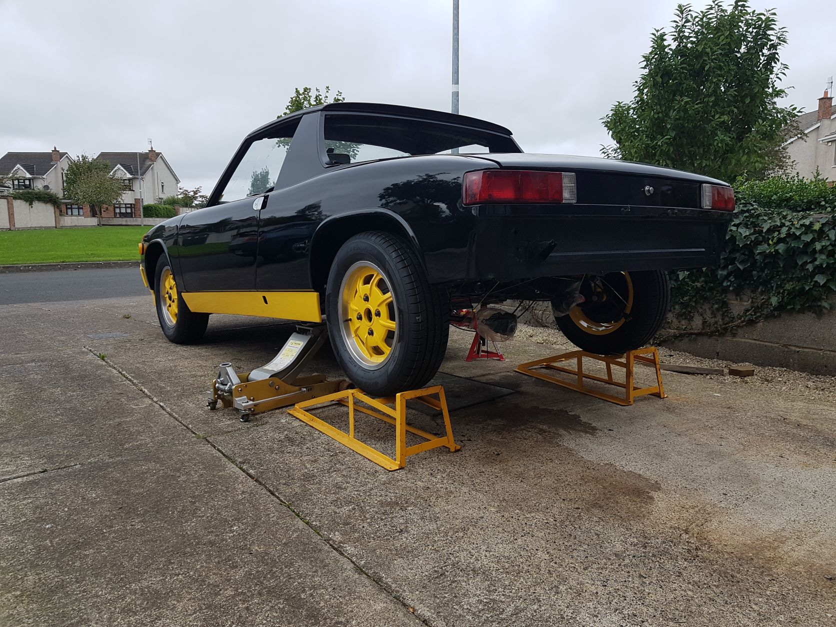

Moved the engine and gearbox out to the car, but them in place with a little help, then spend few days checking fuel, fluids, adding exhaust (poorly it seems as i have exhaust leak on number 4 at least, if not more), checking hoses, wiring - was quite nerve racking trying to make sure all was right but it started right up first time
Tried to do the 20 min cam brake-in at 2500 rpm, i was so busy trying to keep the rpms up it took me some time to notice the exhaust was way over heating do late timing. Stopped, cool don and added some advance and the engine was much more happy.
First test drive was today, here is a vid. (fixed the backwards tail light wires already!)
first drive
Biggest issues 1) voltage drop to the starter, or more to the solenoid, cleaned and soldered all the connections but it was still lucky dip, so put the relay "fix" in for now will go back to it later 2) exhaust leak from heads, kind of expected as I was fearful if torque those nuts much, hopefully a easy fix to loosen and re-seat them. 3) getting good idle, we not really as engine has been in less then as week and its nearly good, have holding around 1000 rpm when warm now 4) new coil faulty after running ok twice giving me a no start issue, not the fault I expected. 5) injector plug covers (new) had pulled them after the no start issue, they where bugger to get on on the bench, in the car they are near impossible.
In the next week will drive down to do import and first reg inspection and get a reg number. Then next few weeks will be for install of new 914 rubber door seal kit and engine lid - basically get it water proof .... and put a few miles on (IMG:style_emoticons/default/biggrin.gif) . then put it away from the winter rain until spring.... for the finishing touches
JeffBowlsby
post Oct 2 2021, 02:18 PM
Post #46
Posts: 9,222
From: San Ramon CA
Member No.: 104
Progressing along great!

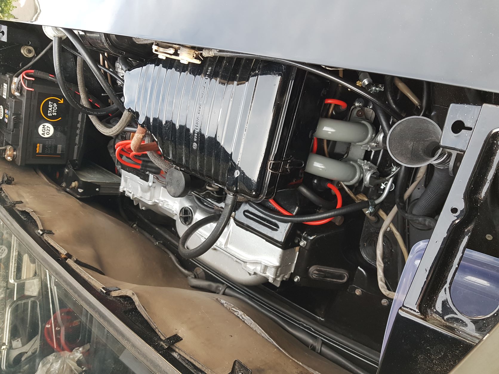

Noticed your two alternator harness grommets are not quite right, looks like you left the one off that fits to the back of the alternator cover (inner grommet). The outer gtommet slides over the central harness section with both branches in it, and inserts into the hole on the engine tin.
ddire333
post Oct 2 2021, 02:31 PM
Post #47
Posts: 91
Joined: 2-November 20
From: ireland
Member No.: 24,835
Region Association: Europe
hi Jeff, I need to go over things in the engine bay again, few bits i just put where i though made sense but might not be right, i need to cut off the extra alternator grommet, I put a 911 75amp unit in and there is no place in the back for the second grommet on it.
ps can you advise where the 3rd hose for the charcoal canister connects - i have one to the line from the tank, one to the air cleaner, but cannot figure out the single port on the alternator side of the engine bay, there is no place I can see for it to go although I see fan housing noted on some diagrams, there is no port on my fan housing?
wonkipop
post Oct 2 2021, 04:46 PM
Post #48
Posts: 5,480
Joined: 6-May 20
From: north antarctica
Member No.: 24,231
@ddire333 .
on a 74 1.8 with the charcoal can in the engine bay this is the port for connecting the blower feed to the can. but.....i don't know when it comes to 74 2.0s. someone else with a 74 with engine bay can would be able to confirm. (if it is the port would be open and a little sleeve is used that presses in to the port and the hose to do the connection).
later 2.0 L 912E uses this port for the can. though they are L jet 2.0s they do have the can in the engine bay. i think a feed off the other side of the fan was used on cars with the can up front near the fuel tank?

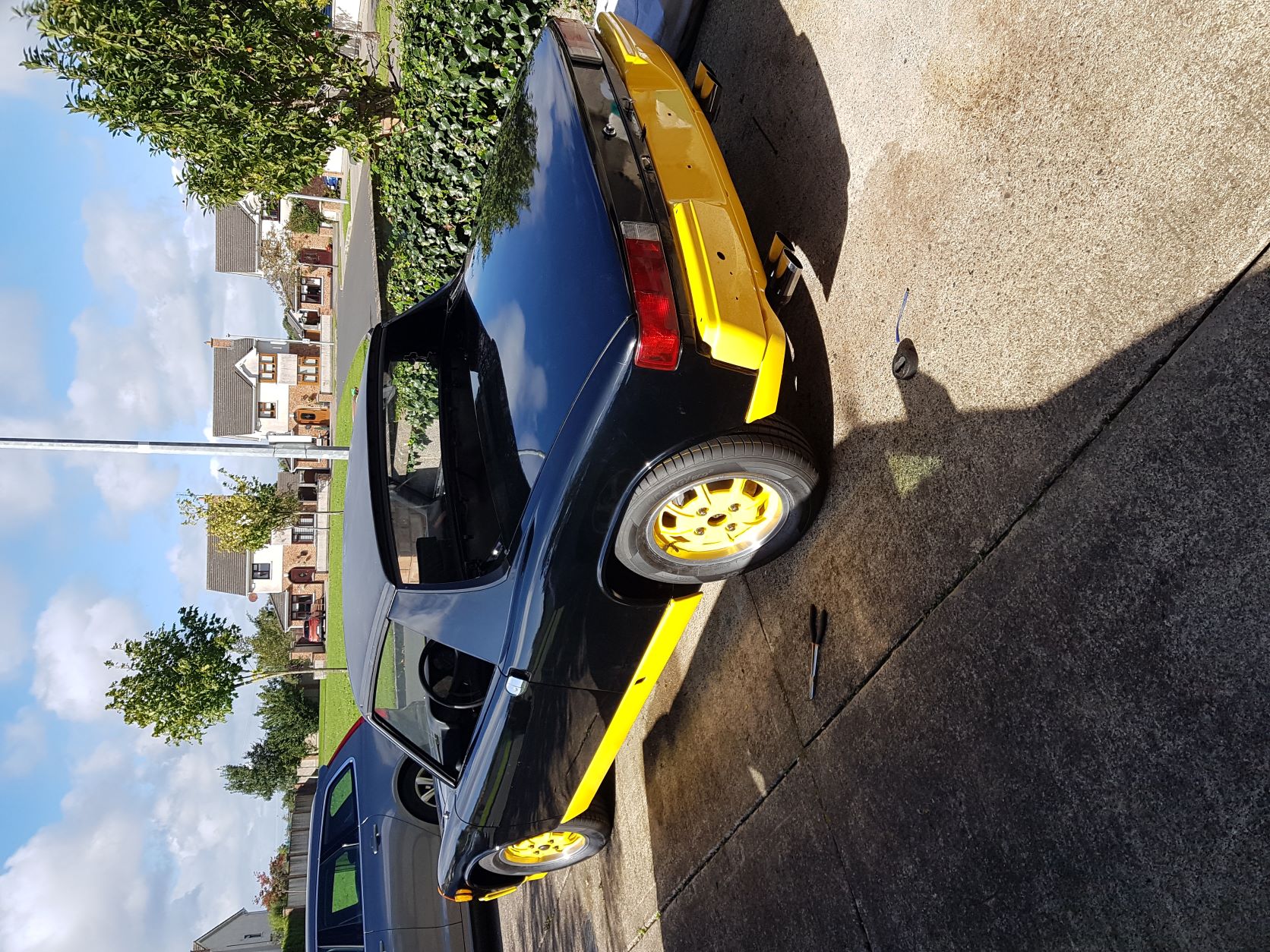

Got the reg plate friday so time to get out on the road, boy was was itching to!!
So got about 30 break-in miles done today. Still have to get alignment done so taking it easy but so far so good. Gearbox works well up and down all gears and the engine is putting well, giving it lots of short pulls from 2-4.5k rpm. Think I still have small bit air still in the brakes as they firm up on second pump, but have no leaks.
Will drive as much as I can before putting away in a week or so for the winter.
Will finish the interior in the spring and drive it!!!

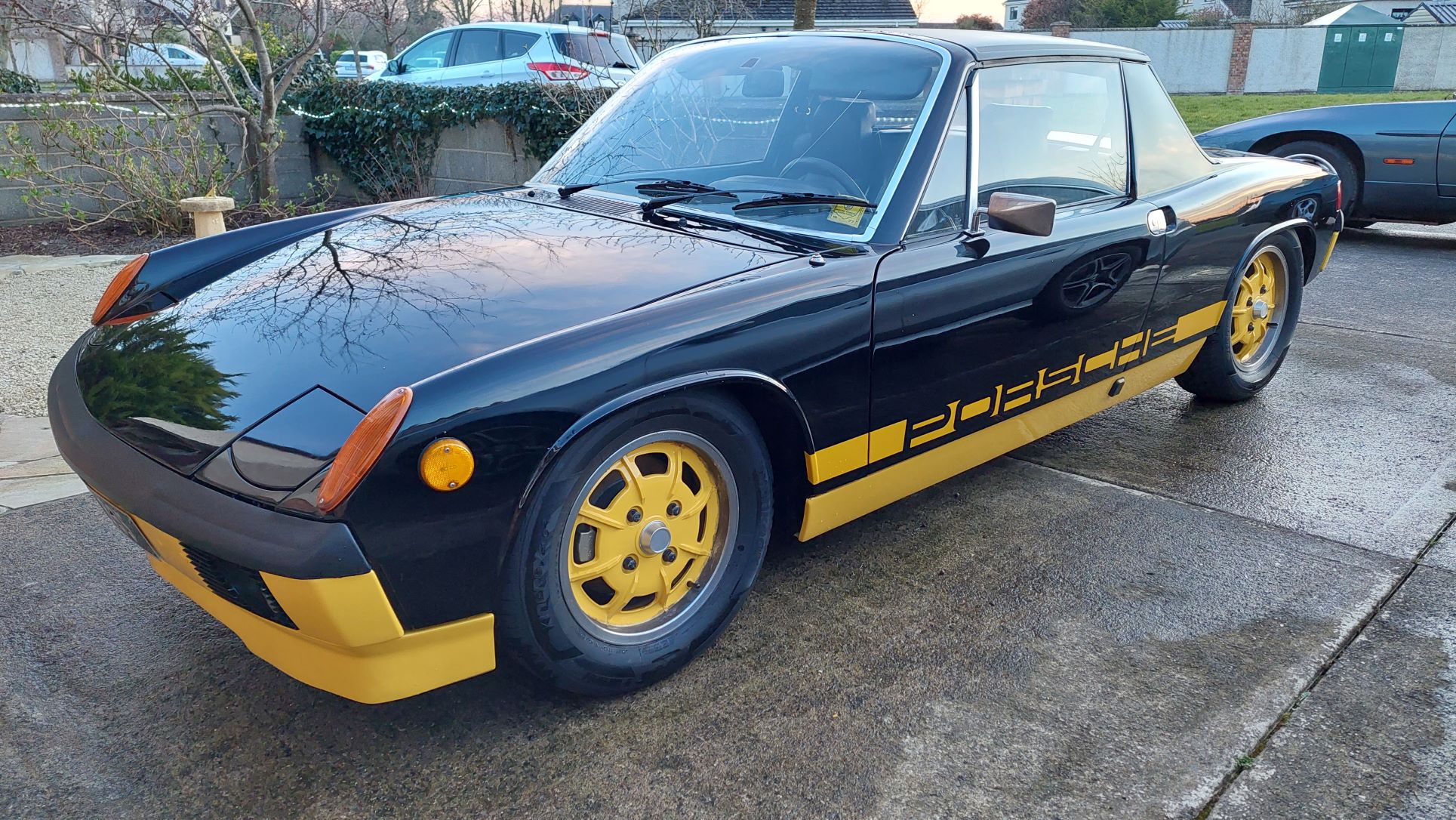

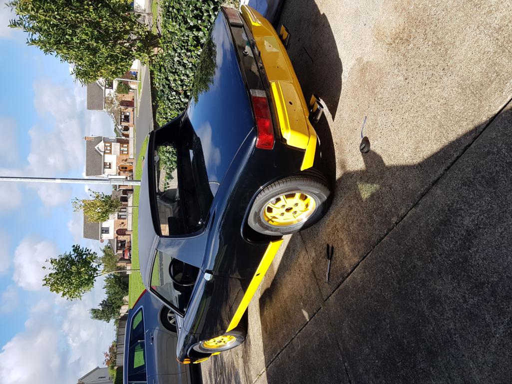

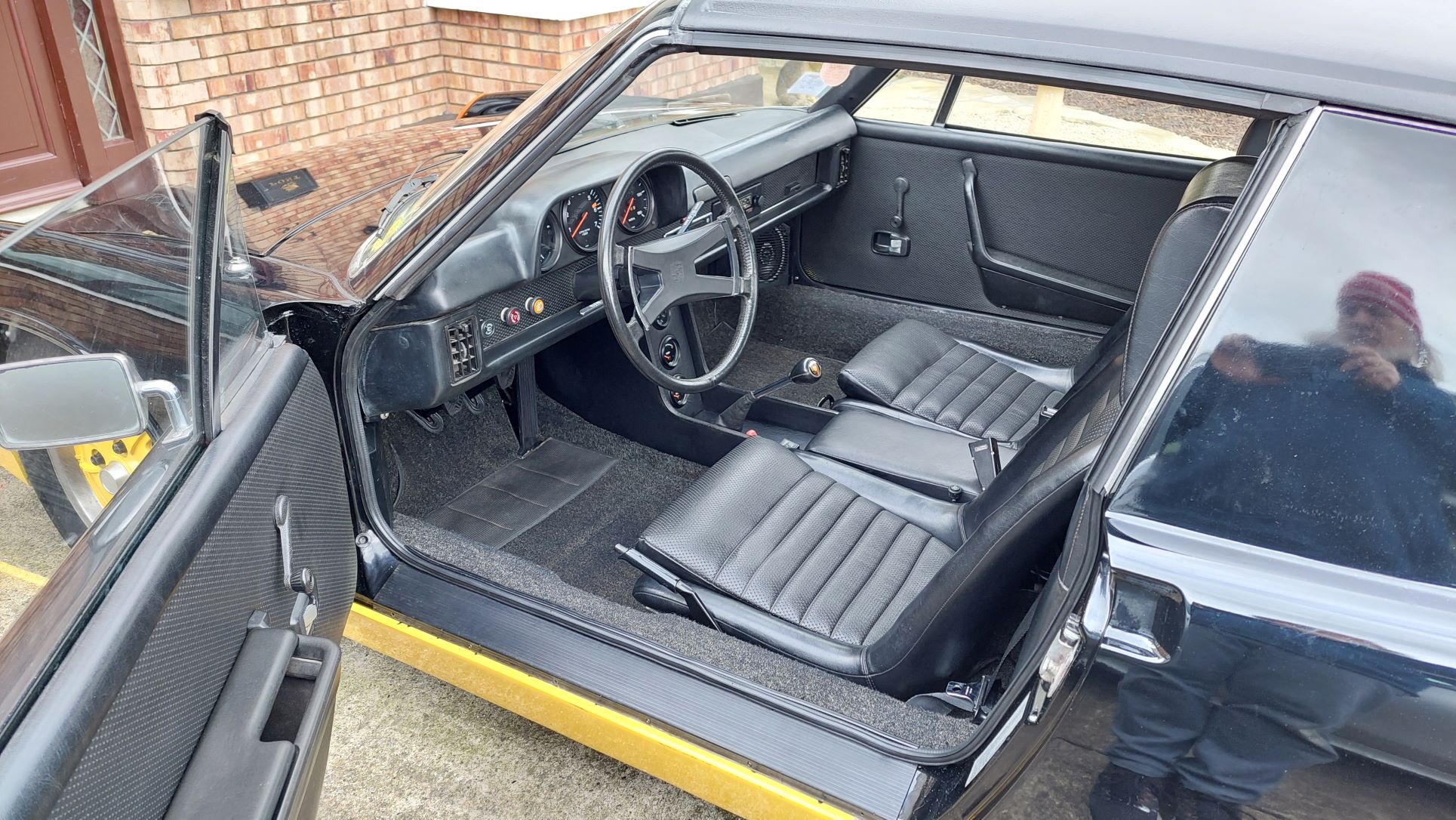

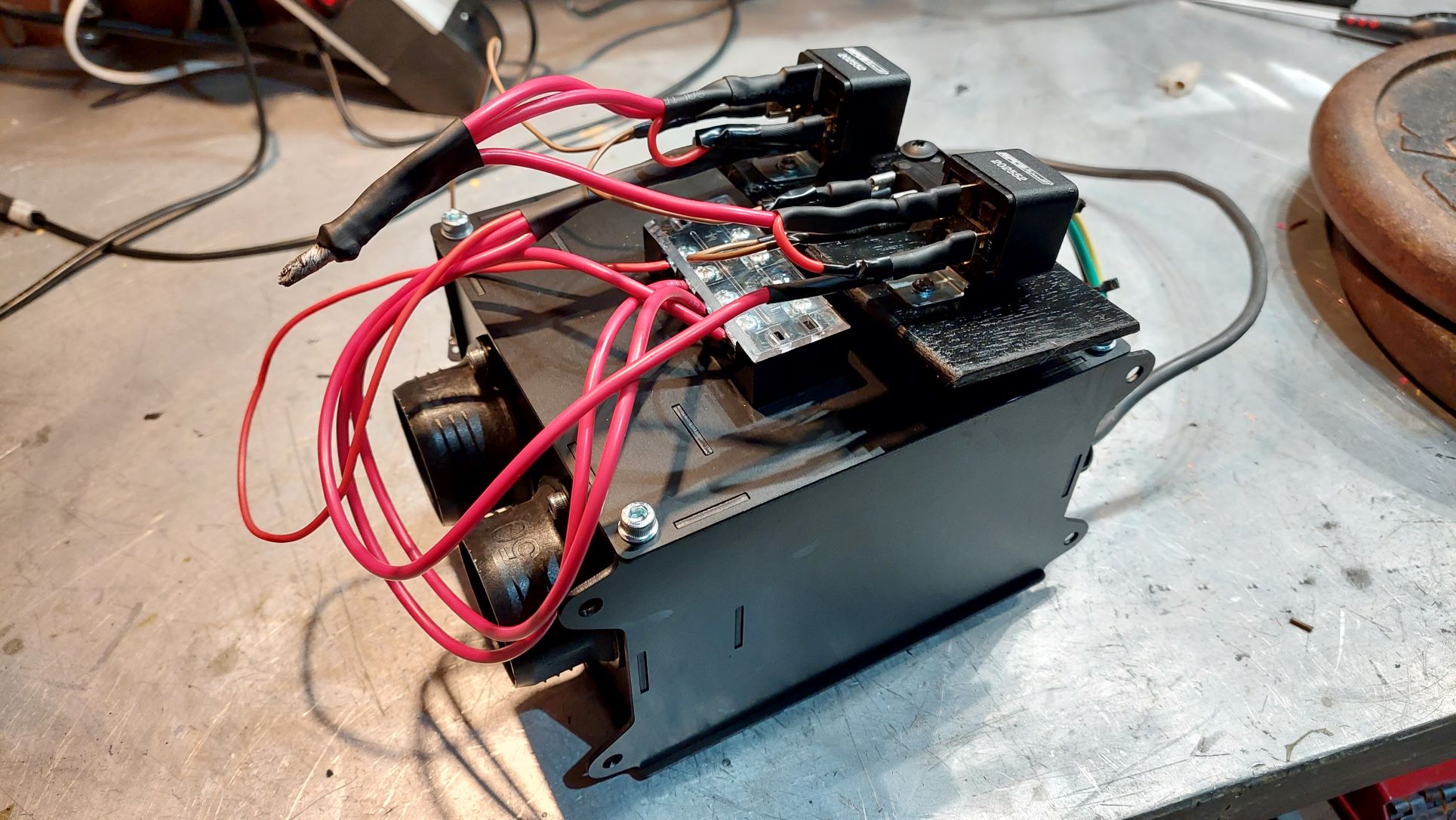

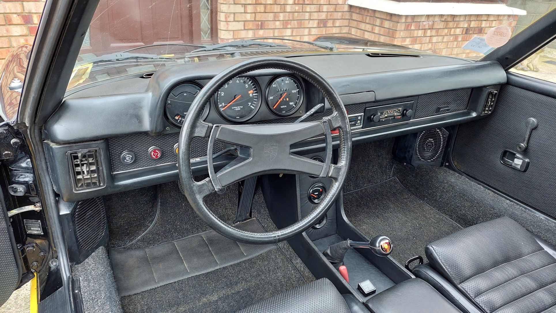

One year on and the restoration is complete (IMG:style_emoticons/default/beer3.gif) ... well you know complete for now. put the car in storage for the winter, spent that time repairing the seats and rest of the interior bits, was lucky it was all in good shape so mostly cleaning, and lots of new rubber.
Picked up a period radio, and put a compact electric heater inside of the center console, it a very tight fit but just goes. (as I was missing heat exchangers). This is the unit if anyone is wondering, needs an uprated alternator.
https://www.t7design.co.uk/12v-600w-ducted-...76-171-6ab.html
So out of storage at the start of March and got stuck in to installing all the interior back, and today the final touch was the side decals.
So just the post break-in oil change and valve adjustment to do, also want to check & adjust air fuel mix at load as think its a bit rich currently.
Have bits to improve, the sill covers and trim (rivet holes where messed up), missing the spare & tool kit, what more original exhaust, gear knob, new windscreen.....but will take mine time as plan to drive it now.
Attached Image Attached ImageAttached ImageAttached Image[attachmentid=829
