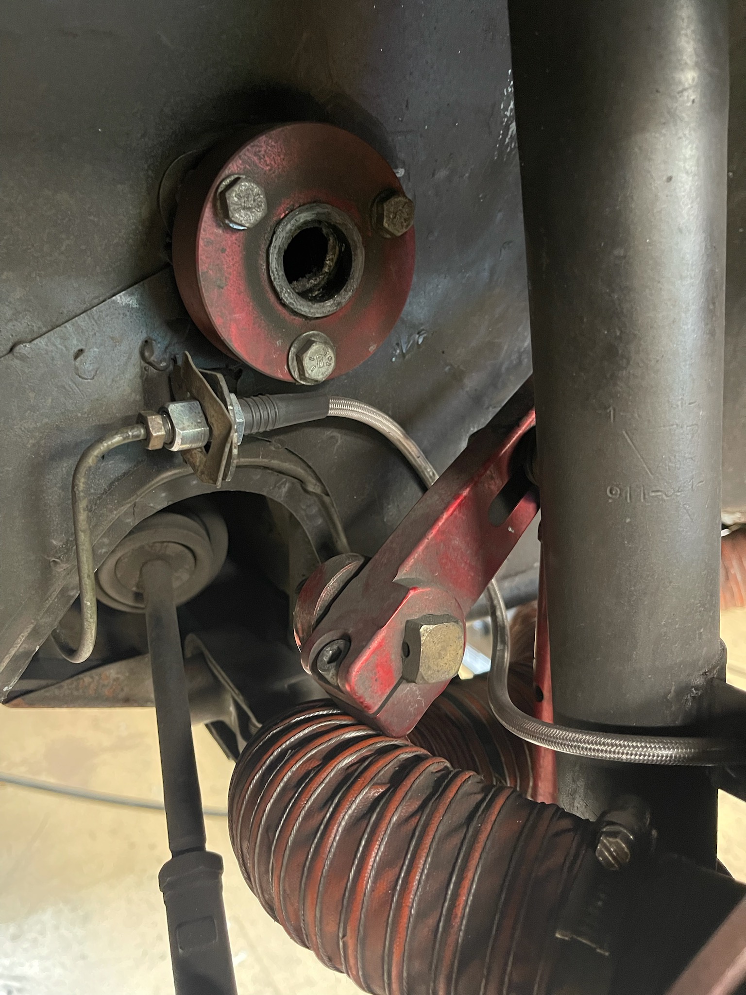

I thought I'd share these pics. I never believed that a sway-bar would break. Anyone else seen this before?

stownsen914   That's impressive. Sometimes it's hard to...   Sep 2 2021, 09:53 AM
Jetsetsurfshop   That's impressive. Sometimes it's hard t...   Sep 2 2021, 10:59 AM
stownsen914   Maybe we have a smoking gun. Sounds like a can...   Sep 2 2021, 11:50 AM
jd74914   Curious what the bar ends that are in the arm look...   Sep 2 2021, 09:50 AM
914werke   Is it a hollow bar ?   Sep 2 2021, 12:19 PM
Jetsetsurfshop   Is it a hollow bar ? It is a hollow bar.   Sep 2 2021, 02:38 PM
sixnotfour   hollow hybred..or lessbred..True hollows are thro...   Sep 2 2021, 08:10 PM
stownsen914   True hollows are through hollow Hadn't not...   Sep 4 2021, 06:10 AM
Jetsetsurfshop   Is the square end welded to the hollow bar? [/quot...   Sep 4 2021, 03:59 PM
stownsen914   I'd guess it failed at the weld (or right next...   Sep 5 2021, 06:08 AM

ChrisFoley   Obviously it had years of service at the mid to up...   Sep 5 2021, 08:23 AM
Jetsetsurfshop   Obviously it had years of service at the mid to u...   Sep 6 2021, 10:59 AM
stownsen914   I put a Speedway Engineering bar on the front of m...   Sep 6 2021, 12:25 PM
ChrisFoley   I put a Speedway Engineering bar on the front of ...   Sep 8 2021, 11:37 AM
stownsen914   I've been offering a 914 front anti-sway bar ...   Sep 10 2021, 07:31 PM
