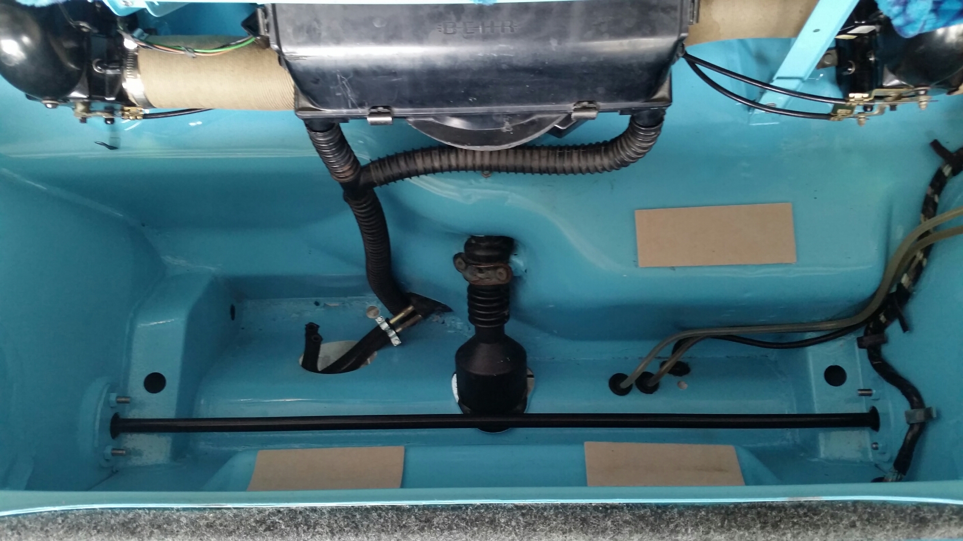

Two places on the front, and one on the back, driver's side?

Looks like a pad on the DS back, two places on the front, but what about the spot on the PS back??

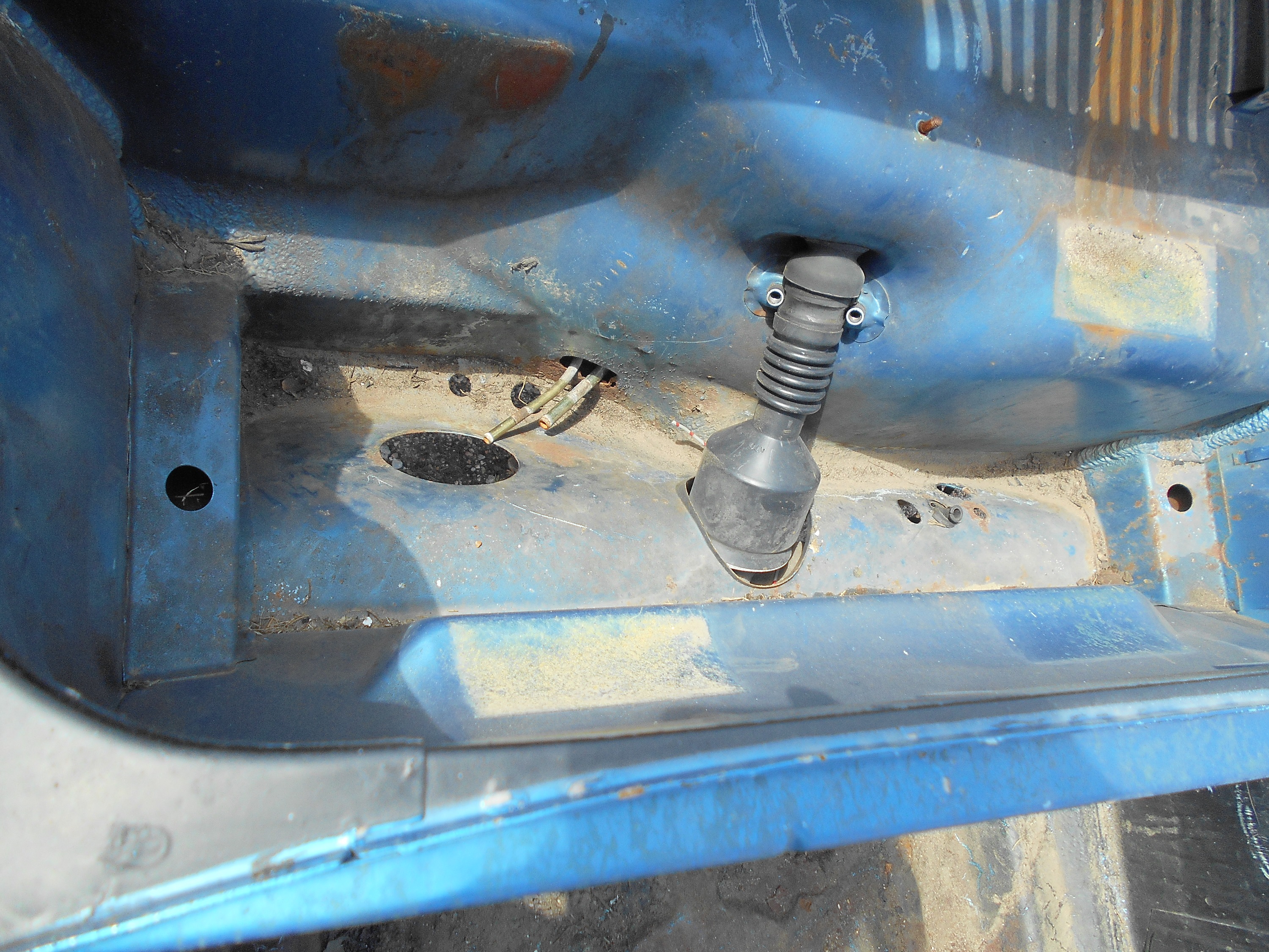

I add a pad as noted in your pic.. rusty spot
