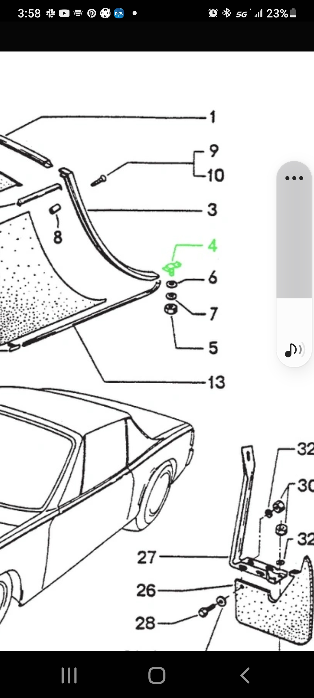

I want to replace the anodized stainless roll bar trim on my 1973 914. The top has a philips head screw, however, the bottom has a clip/spacer that is no longer produced. Does the trim have adhesive to hold it in place? How can I avoid damaging the vinal sail panel and reinstall the new trim? How can I save the clip/spacer at the bottom of the trim?

The nut for the clip/spacer is located in the top of the wheel well. It may be covered with stuff.

I just did this. Auto Atlanta sells the clips, but the stud is too short to get a nut on in the wheel well. Frustrating. I used a bolt through a right-sized washer that fits in the slot at the bottom of the trim. Used a little butyl to hold the bolt to the washer (jb weld would work better) and Bob’s your uncle. Note that the screw at the top has a spacer behind it so you don’t bend the trim when tightening.

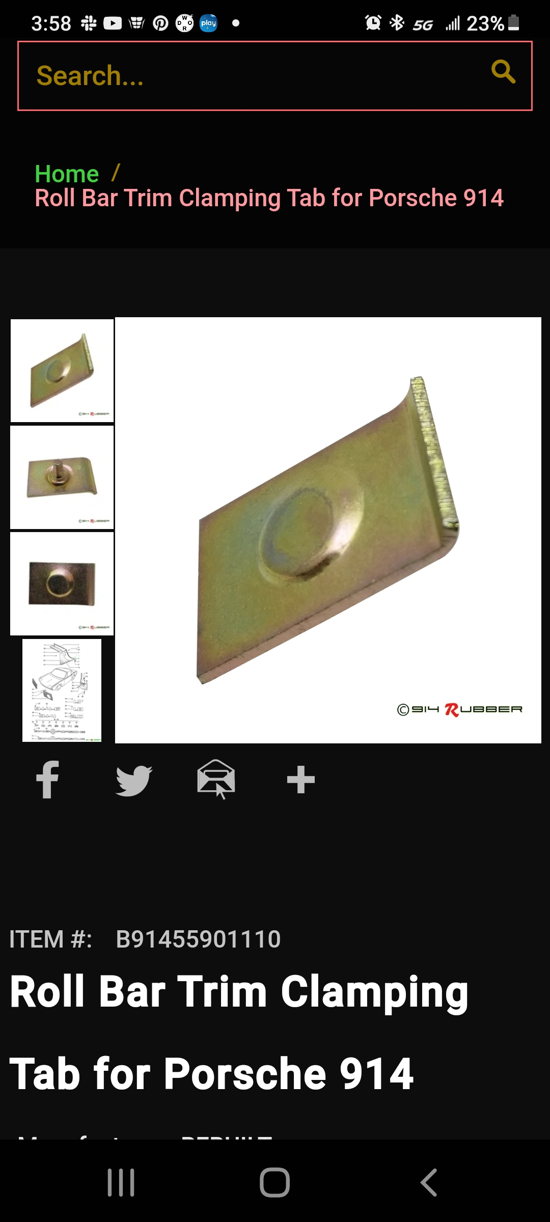

Got you covered
https://914rubber.com/roll-bar-trim-clampin...for-porsche-914

914 rubber to the rescue. Didn’t realize those were available!

Our next round on these we will make the "bolt" section longer.
