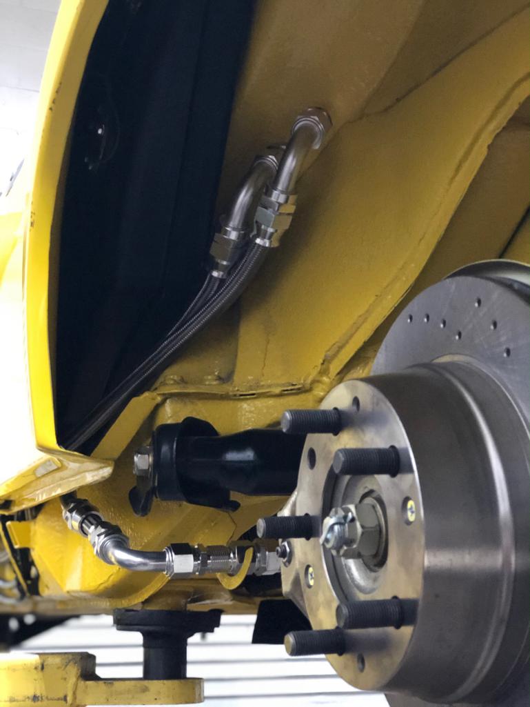

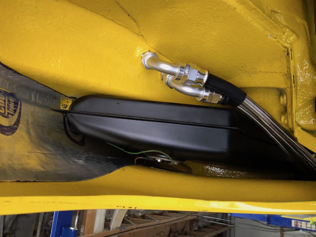

I did mine with flex AN12 lines on the left... under the steel rocker panel, through to the left front wheelwell, through the inner wheelwell panel near the brake fluid resevoir, down into the fuel tank cavity, through the left box section there, and through the back bulkhead of the front trunk.
A hole saw is my friend! The only real mod I needed to make was increase the clearance at the top left rear of the fuel tank. One AN12 hose easily fits. The mod needed to accomodate two.

example of flex SS on a six, my six
Bob BAttached Image Attached Image

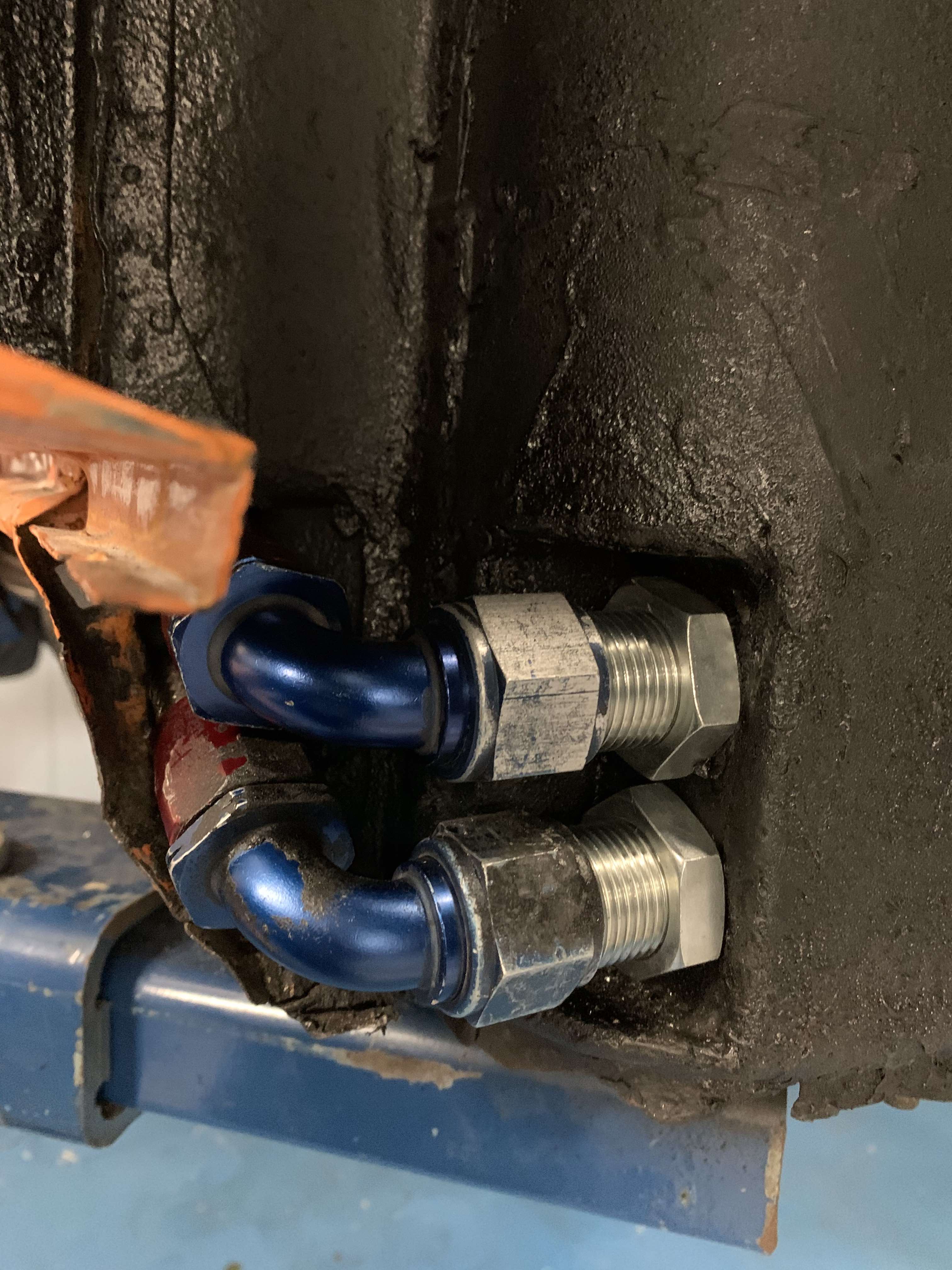

RiqueMar
post Oct 15 2021, 12:29 PM
Enrique Allen Mar
Posts: 2,264
Joined: 28-August 08
From: San Diego, CA
Member No.: 9,478

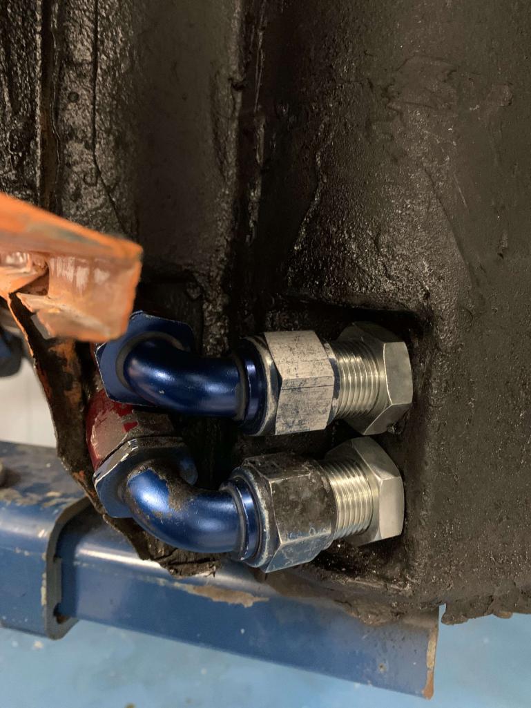

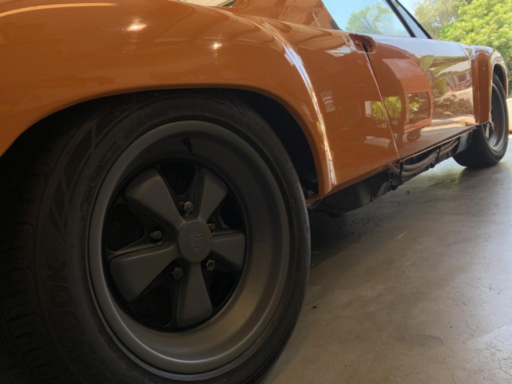

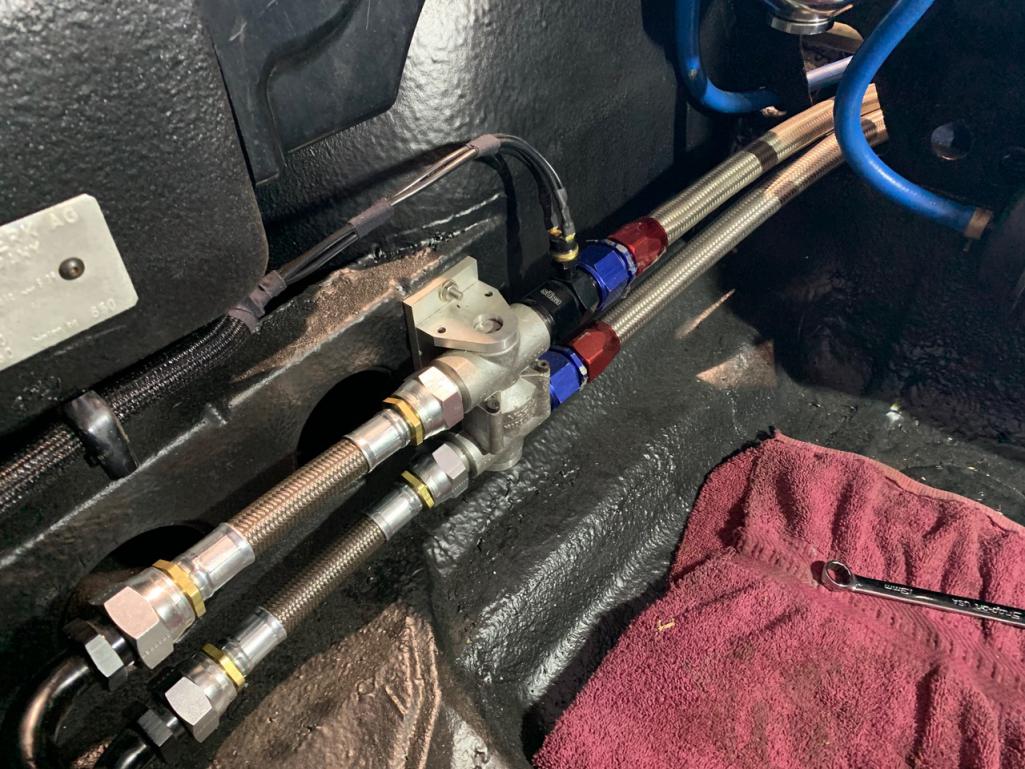

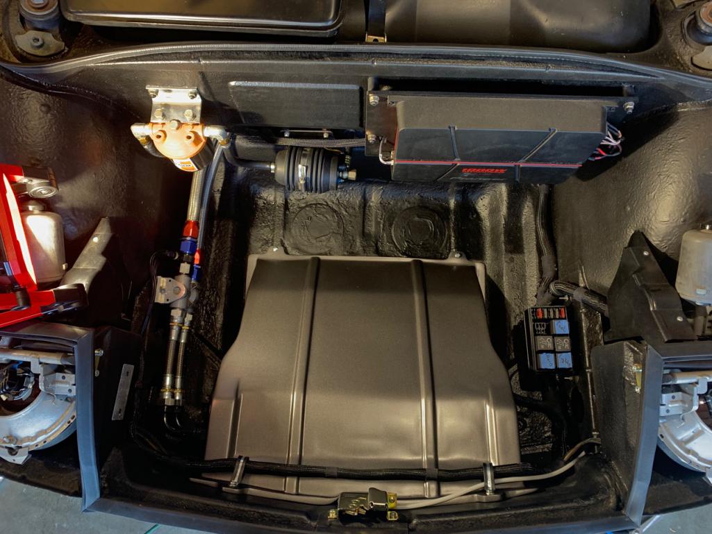

I too ran my lines on the passenger-side exterior, with the only difference being that my lines do enter the cabin via a bulkhead mount to avoid running in the wheel-well. More photos on my build-thread, but sharing a few here.
