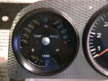

Has anyone built a 3 in 1 gauge like this?

Dan Root is the creator and I have one in my black 914-6.

Did Dan come up with the patterns originally? I got my kit from Don (formerly of Don & Glen's swap meet fame) back when he was working at Pelican the first time. (Or was it just before then?)
They're not hard to build, but making the face-plate (the part you can see) and making it look nice are not that easy. The back plate shouldn't be too tough to make. Just remove gauge modules from their backing plates and lay them out on some flat stock, then mark where the holes need to be. Hmm, you'll have to have them stuffed into the gauge housing, I guess, to see where they need to be in relation to each other.
Or you could borrow a backing plate from someone who has one.

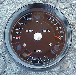

Here's mine I made from a kit. Unassembled kit came with my car so I don't know who it came from.

How many times am I going to do this before I learn? Here's the pic:

I made the back plates for the Don kit way back when, Don had better luck with the fronts. I said I would make another set, but don't have time or really want to deal with it. So if someone whats to pickup the ball, I can send you all the info I have. Send me a PM.
I can give you prices and drawings on how they are made, instractions etc. Stan gave myself and Don permision to build these, it was a pain, it was royal pain in reality.

I have a tripple gauge kit, but my faceplate really is CRAPPY compared to those shown in this thread. I bought my kit from a friend of a friend and the deal kinda went sour. I got the kit but was less than pleased with it.
I didn't use the faceplate that he provided. I wish I had one of those faceplates only without the center chrome button.
I looked further at the link (in an earlier post) and determined that it is an identical kit to what I recieved. I have all the instructions (including templates to have the gauge faces re-screened), the backplate and two faceplates (one with button, and one without). The guy was nice enough, but the quality was not what I had expected. However, after looking at the others, my faceplates look identical to the pics above.

Cool looking gauge. How come the first picture showed the pressure and temp gauge with the correct angle on the silk screen but the kit used 911 vertical gauge parts? I wish this was still available!

(IMG:http://www.914world.com/bbs2/html/emoticons/biggrin.gif) I didn't invent the kit, but have put a few together and know how they work. You basically have 2 pieces to the kit and instructions. You need your 914 fuel gauge and a 911 combo gauge.
I think my first kit came from Stan and second from Don? I can't remember now. The last one I put together now resides in Craig's black 914-6. I actually wish I would have kept the gauge as no one has put together another kit since. It is a PITA to do. You have to shell out $$$ get the face peice machined, painted and silk screened, then make the back piece.
I do know the kits, if someone wants to send me the stuff, I would put in the time and $$$ to start making them again. The last 2 times I purchased the kits, they were around $100, so I would try to keep them at that same price level.
