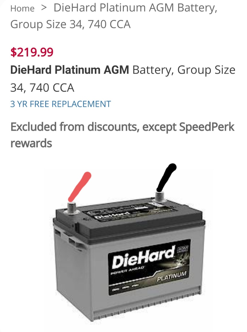

I've looked into this DieHard (AGM) battery; does require a small bit of edge triming off off the left and right side of the battery tray. Always been a DieHard fan, also use Optima Red as well.
