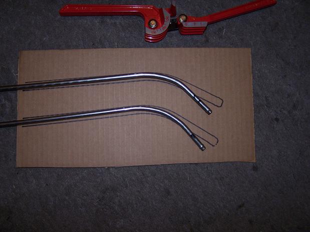

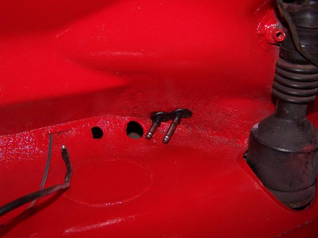

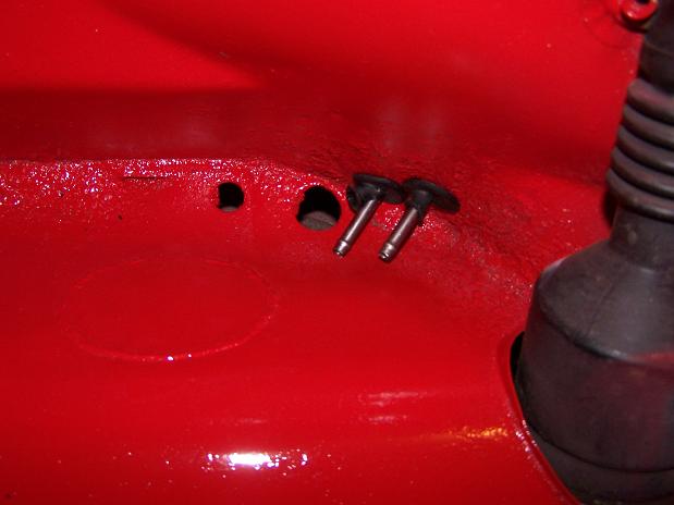

I had an issue with Tangerine Racing tubes as well. The issue was the bend at the gas tank was not enough to allow room for the hoses to connect. I had to further bend them to allow room for the hose connections.
Here's the initial install. The pipes point right to the front wall.
So I further bent the tubes to give more clearance.
Now they fit better and I could easily get the hoses over the tubes. It doesn't look much different in the pictures but the fit was much better.

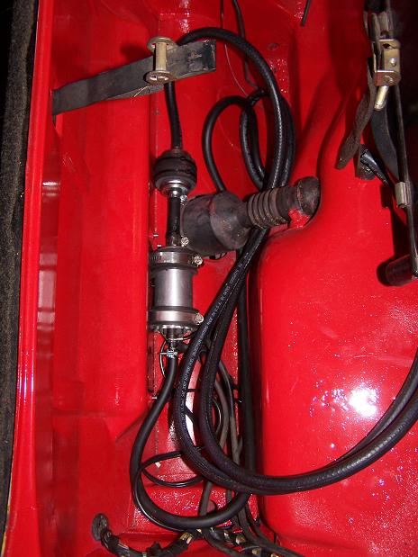

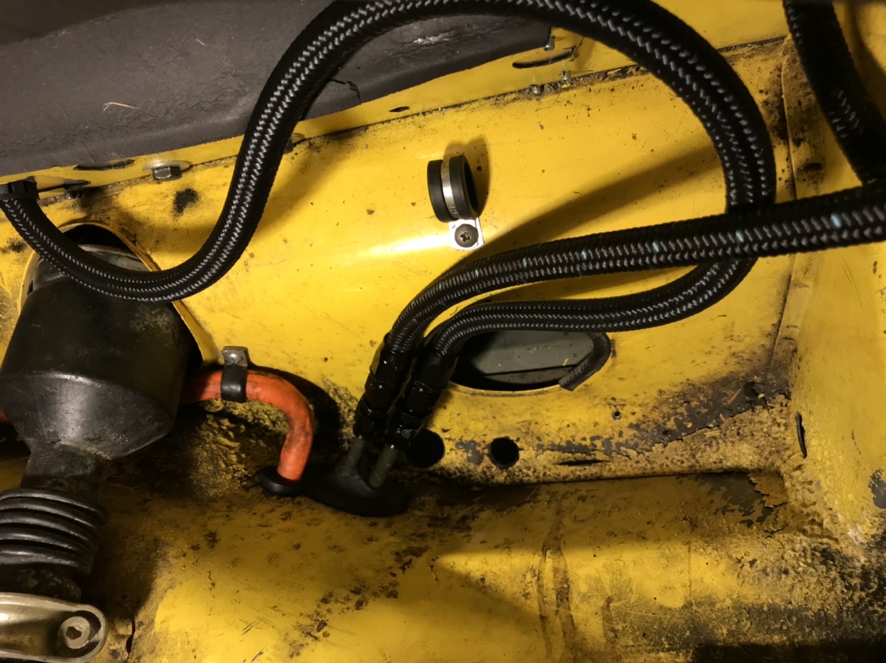

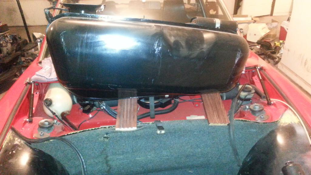

I opted to not connect the lines directly to the gas tank as I didn't like being under the car making connections and especially if the tank needed to be lifted for any reason then trying to disconnect the tank. I even welded closed the round access hole.
The hoses are routed to the driver side where I mounted the fuel pump.
The hoses do not kink and the extra hoses allowed me to do all the connections above the car and if the tank needs to be pulled, just lift the tank. I can still run the engine with the tank lifted. Also allowed me to check for leaks once all the hoses were connected.

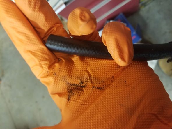

Ian sent me a note that some fuel hose I sent him was giving off black residue when wet with gas so I took a sample of the hose I had in stock and left it in a jar of gas for a month. It didn't let off any residue, but its possible that the previous spool of hose from Gates had an issue.

I purchased my kit a while back so you probably don't have that batch anymore. The first picture is with just a few drops of gas. The second is after pulling the lines off the tank.Attached Image
The line seems fine once it dries just seems to kink easily. Ill see if the Napa stuff is usable.
