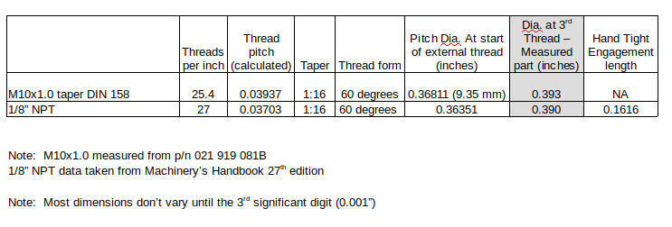

I think you misunderstood. No adapter needed. Just thread the 1/8" NPT in. Done.
I don't expect folks to take me at face value. It is the internet after all. (IMG:style_emoticons/default/happy11.gif)
Here is a side by side comparison of 1/8" NPT spec obtained from 27th edition Machinery's Handbook vs. DIN 158 spec that I could find on the web. Was actually surprised I couldn't find the Metric Pipe Thread Spec in the Handbook so i used what I could find on the web and actual measurement of VW sender P/n 021 919 081B
You will see the thread forms are the same until you get to the 3rd significant digit. Since pipe taper threads work via interference fit due to the taper, what happens is that you will get a little bit earlier or later engagement when the thread forms (primarily due the Threads per inch differences) are intermixed. However, the liquid tight seal will still be established by the interference fit of the tapers and thread forms.
As noted previously, the thread forms are not exactly the same. However, they are close enough that M10 x 1.0 taper and 1/8" NPT have been intermixed on 914's for decades and many people never even noticed that they had done it.
Metric thread form sources:
https://www.pressol.com/informationen/spezi...in-158/?lang=en
and
https://www.yumpu.com/en/document/read/3032...aryland-metrics

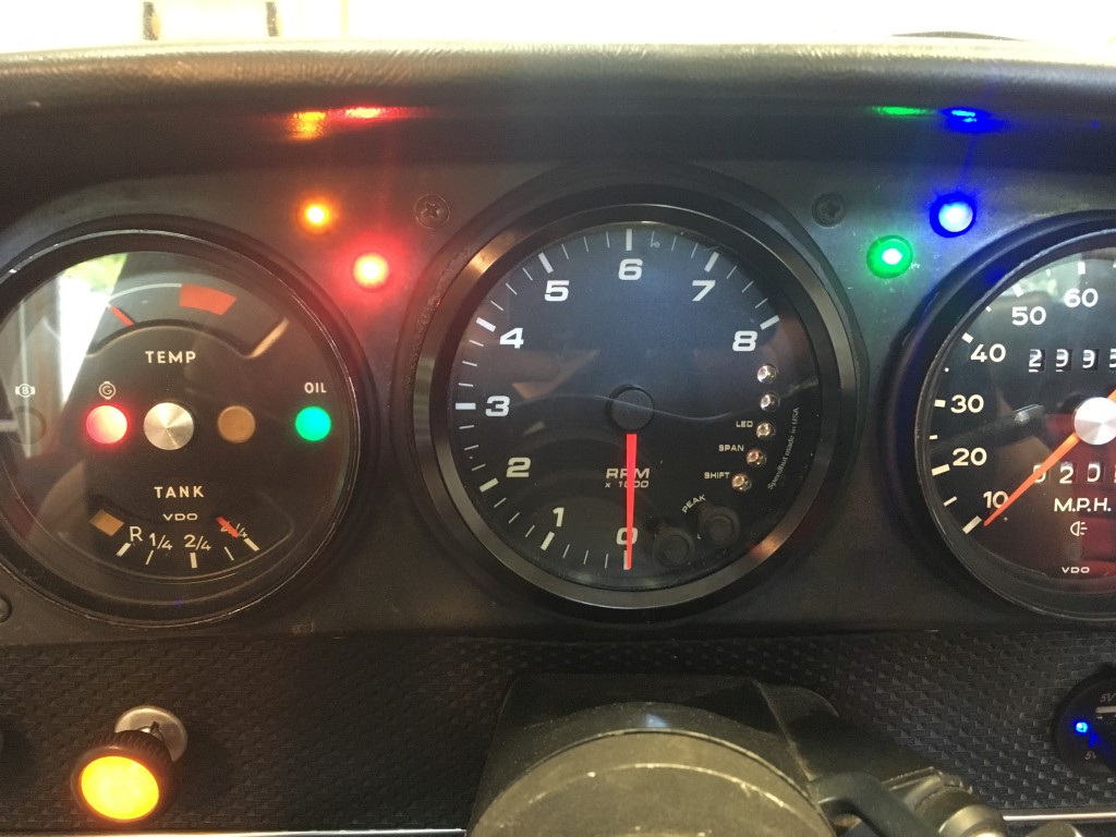

And if you want to improve the visibility of that light, $25 in LEDs and some wire and piggyback terminals helps.
Yellow - GEN
Red - oil pressure
Blue - high beams
Green - turn signals
(Yes, I changed the oil to RED! I dont know why VWPA used red for the GEN warning and green for the oil pressure...)
This did not require any mods to the car's wiring; I used some male-male terminal piggybacks/jumpers/whatever you want to call them. I did drill holes in the overlay panel butthose are not had ot find cheap if you need to go back.
