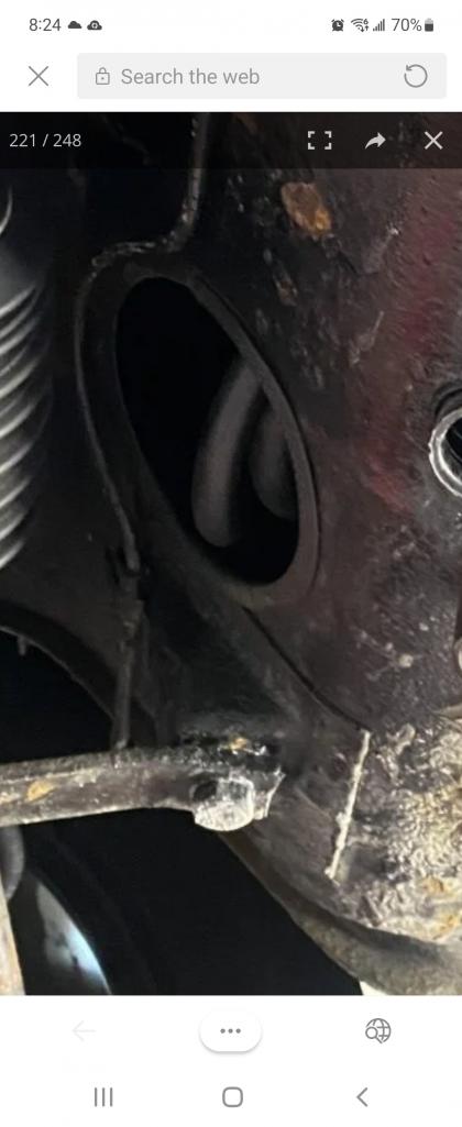

Good morning, trying to identify this cover. Mine is missing.
To access fuel lines under the gas tank from under the car. Haynes calls it a "gravel cover"......need to find one, once I know what to call it. (IMG:style_emoticons/default/blink.gif)
(Picture is from the car that just came up on BAT)
Thank for any help/direction.
QM

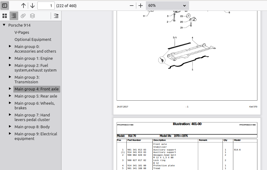

Download parts diagrams from Porsche Classic:
https://www.porsche.com/usa/accessoriesands...partscatalogue/
Restoration Design sells a nice reproduction & 914Rubber sells the seals

"Protective plate" per the PET. Not too much protection here, it's 20 gauge steel

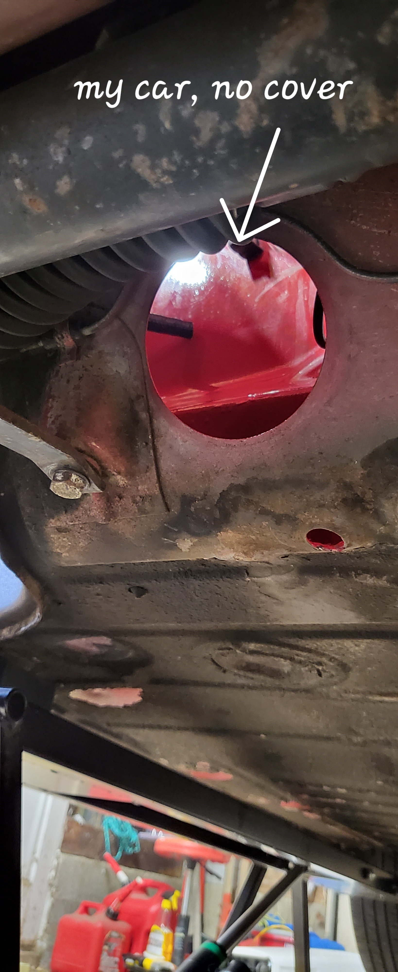

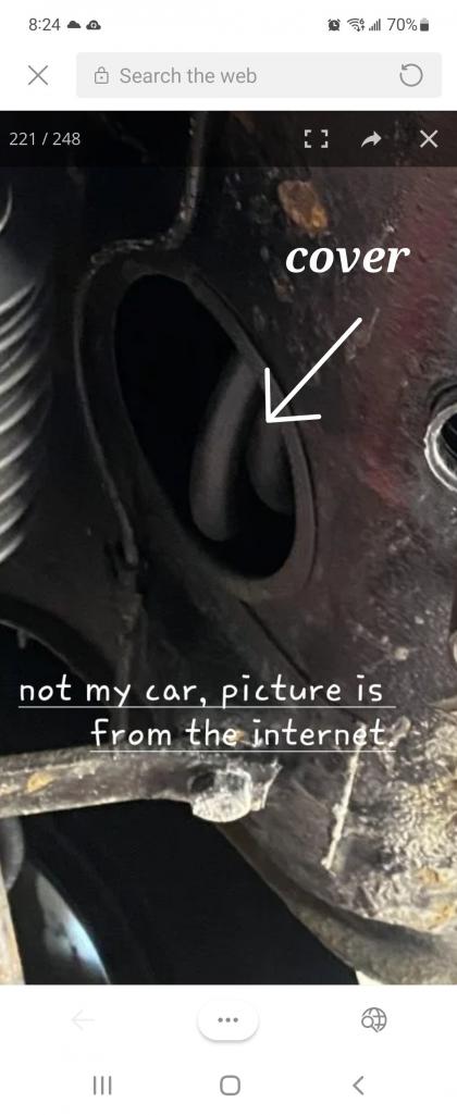

Thank you, yes the plate is missing too. But, I'm looking for the round cover/plug. Looking at the first pic. Behind the round cover, are the fuel lines connected to the fuel tank.

QUOTE(Quinn Moore @ Apr 29 2022, 08:29 AM) *
There is no cover for that opening. You need the protective cover (gravel shield)

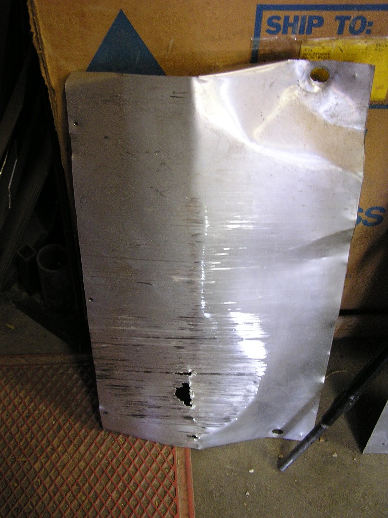

to the original poster:
I've never seen a "plug" on that hole
in the picture you can see the welting that the factory used.
yes those are the gas lines... protected from the sharp edge of the hole by welting
you need the "skid plate" or "dust shield" or what ever you want to call it.
brant

rack and pinion cover, we have new and used on the shelf, 914 341 161 00

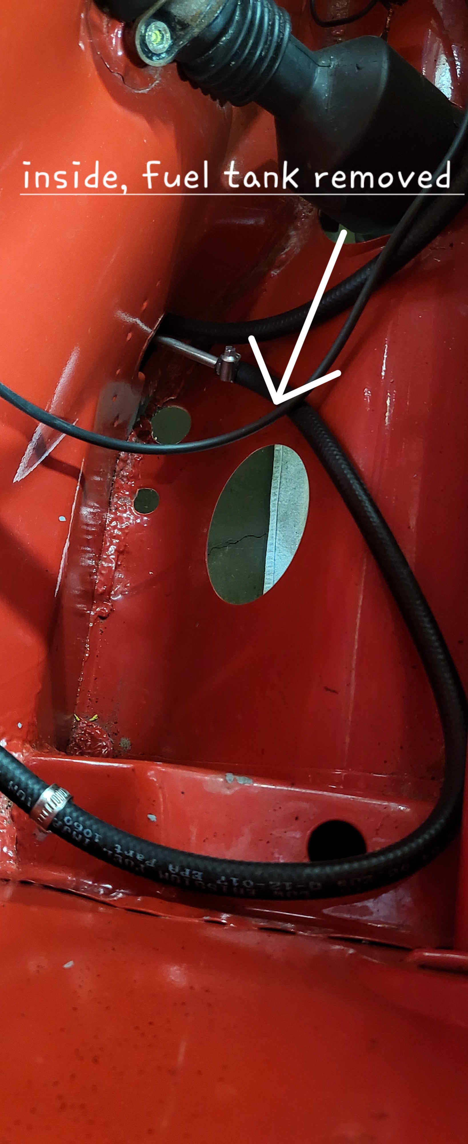

QUOTE(Quinn Moore @ Apr 29 2022, 08:46 AM) *
QM
More pics might help. I am missing 914 341 161 00. But, in this instance I'm talking about the round hole.....(fuel tank has been removed for cleaning on my car).
Thanks again, QM

yep, no cover or plug for that 4 inch diameter hole.

Yup, what everyone else said. There is no cover for that hole. In the picture you posted that you pulled from the internet, those 'pieces' you see inside the hole are not 'pieces' of a cover, they arer the two fuel lines.

Thanks everyone for the clarification! I "see" it now. The fuel lines as Rob-O pointed out. I will install the rack and pinion cover.
Sorry for the goose chase, eyes aren't what they used to be.
QM
