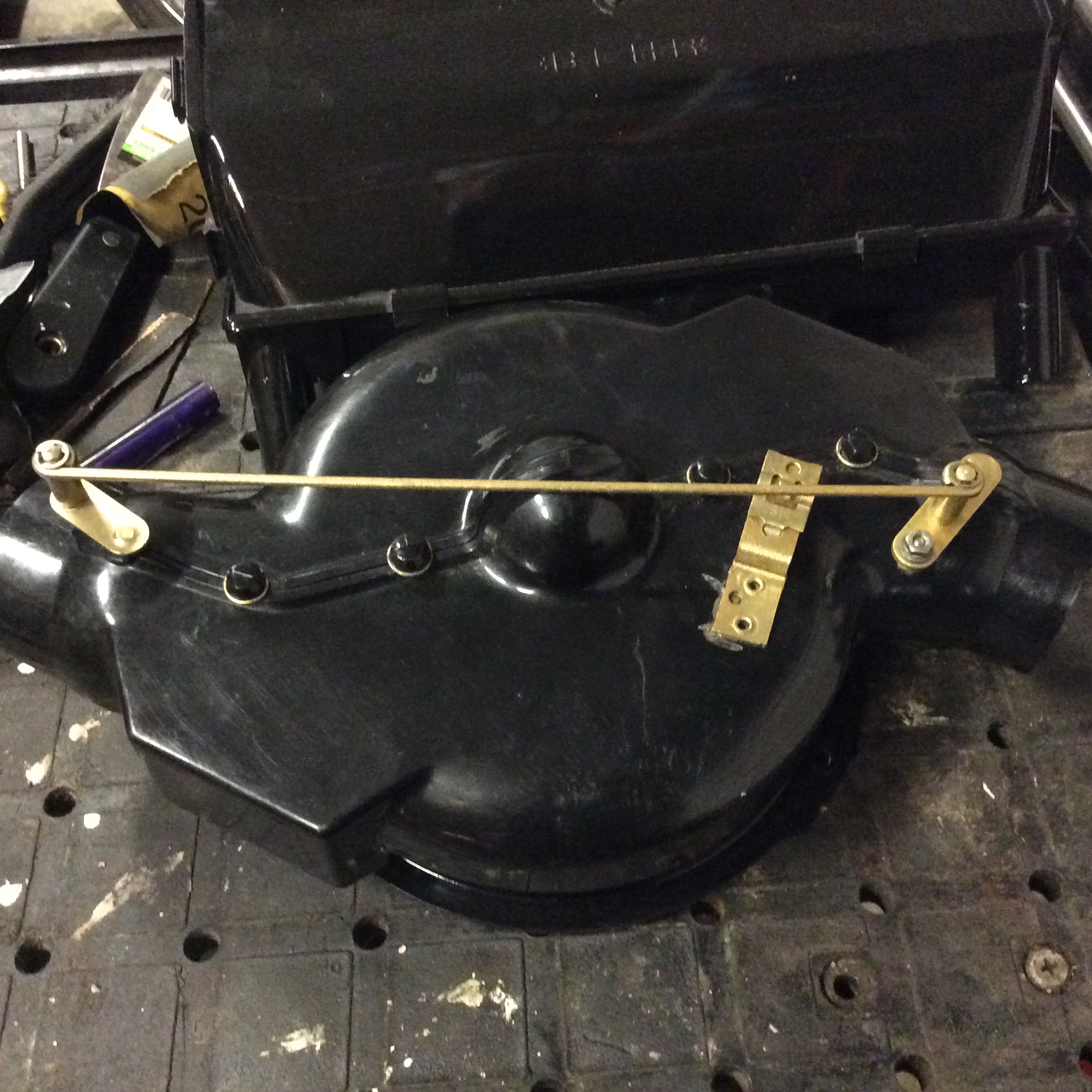

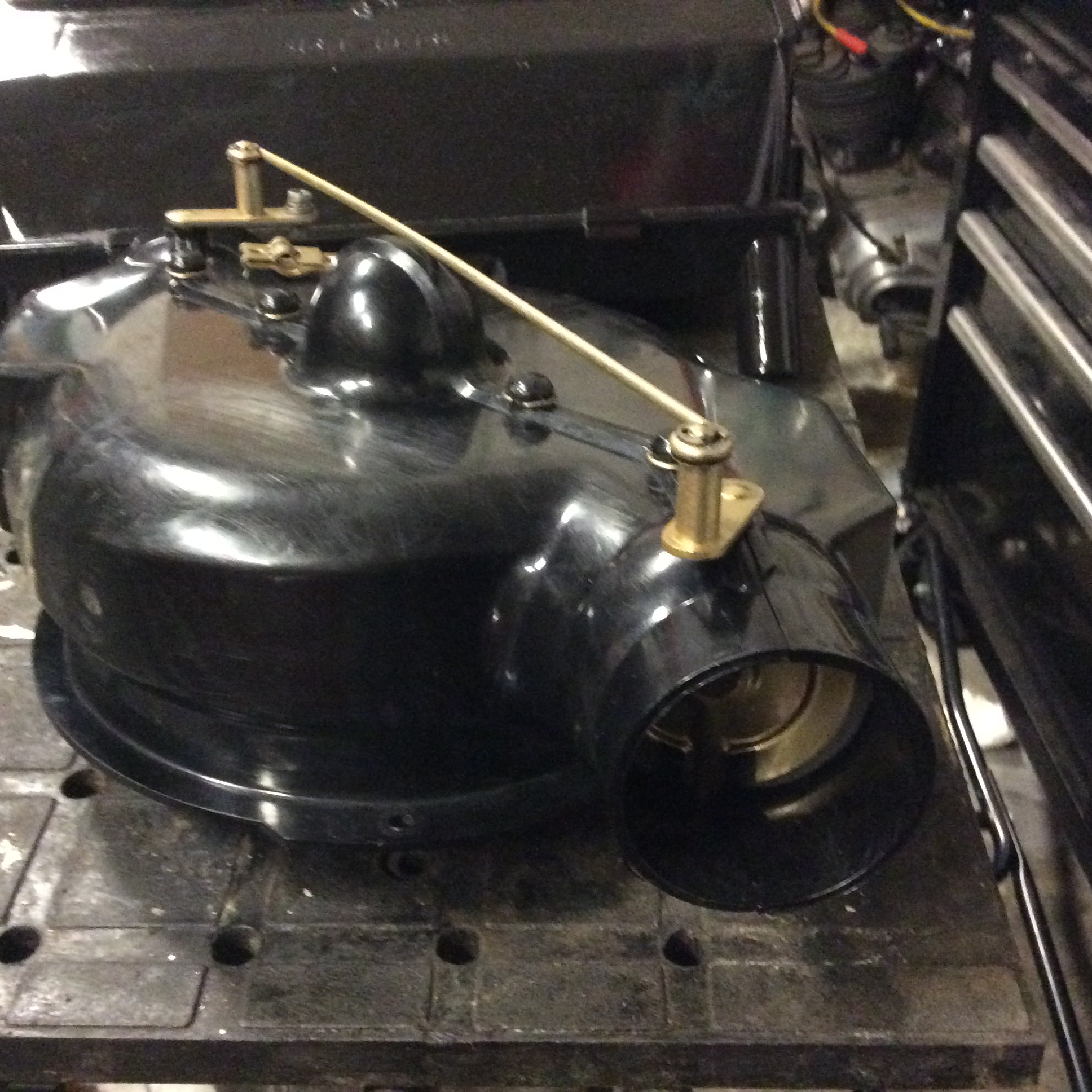

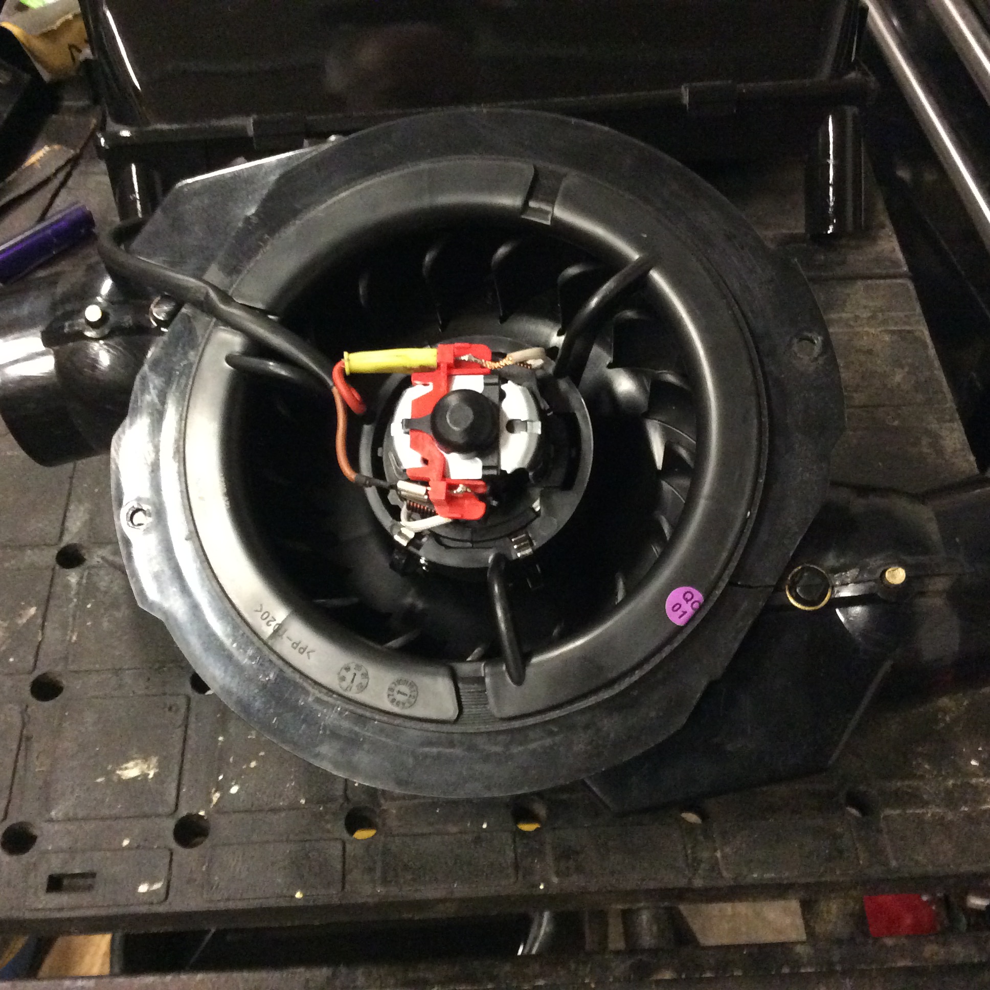

Here’s a few pictures of the fan unit. It’s a URO, 914 rubber gaskets for the motor housing and flapper valves. I used gold VHT wheel paint for the metal hardware.
