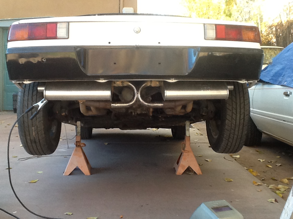

Front yard mechanic
post May 7 2022, 03:02 PM
Posts: 1,439
Joined: 23-July 15
From: New Mexico
Member No.: 18,984
Scab your ownAttached Image

QUOTE(Front yard mechanic @ May 7 2022, 02:02 PM) *
(IMG:style_emoticons/default/smile.gif) please fabricate some safe jack stands (IMG:style_emoticons/default/smile.gif). I love reading about and watching your work (IMG:style_emoticons/default/smile.gif)
