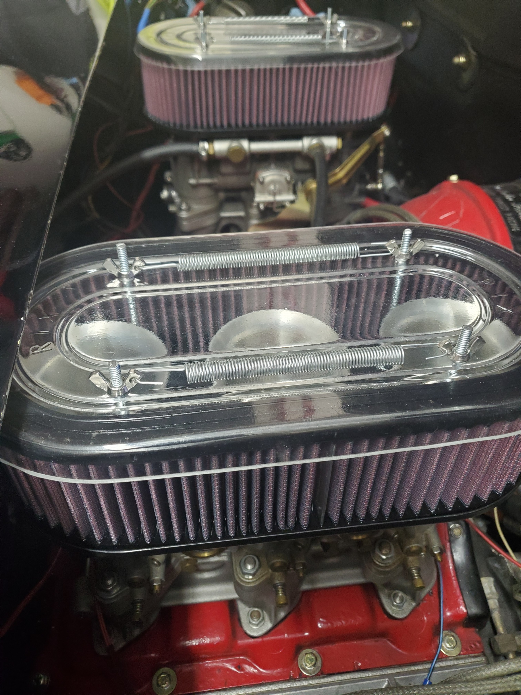

I have been having quite the time trying to get non-stock air filters to fit inside the engine bay. The 4,5,6 side has no issues, but the 1,2,3 is hitting the trunk lip. I have cut some of the seal away (smh new seal) to get it to fit. I just ordered what I thought were a new set of k&N for $220 only to find out it was one. This setup is a little slimmer than the aluminum K&N by about a 1/4 inch. So it might work, I just hate dropping $440 on a set of pods when I have a set of pods.
What are most doing for this? I saw ITG has a pair for under $400, but they look (IMG:style_emoticons/default/barf.gif)
I don't even know how rain hats would even fit, but I'm sure I have seen some. I know Ben is running clear plastic tops which look to fit just under the lip. I am running the mad dog OEM mount. My carbs sit a little taller due to phelonic spacers. Are people running a slimmer profile filter?
Edit: Running Zeniths

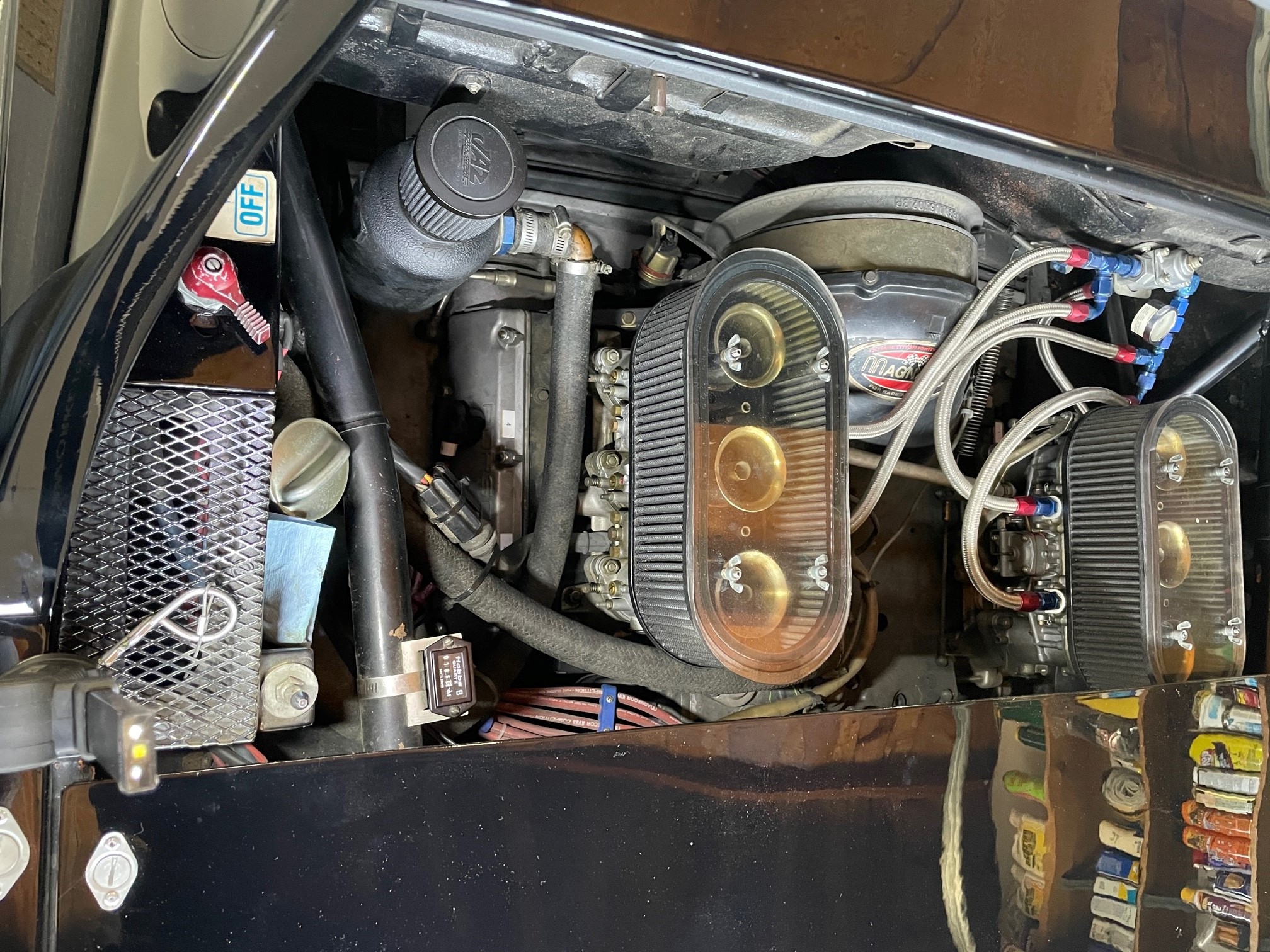

I am running PMO hats but rix 914 parts has a cool clear rain hat for a 6. That would be my dream. I run stock intakes just and FYI.

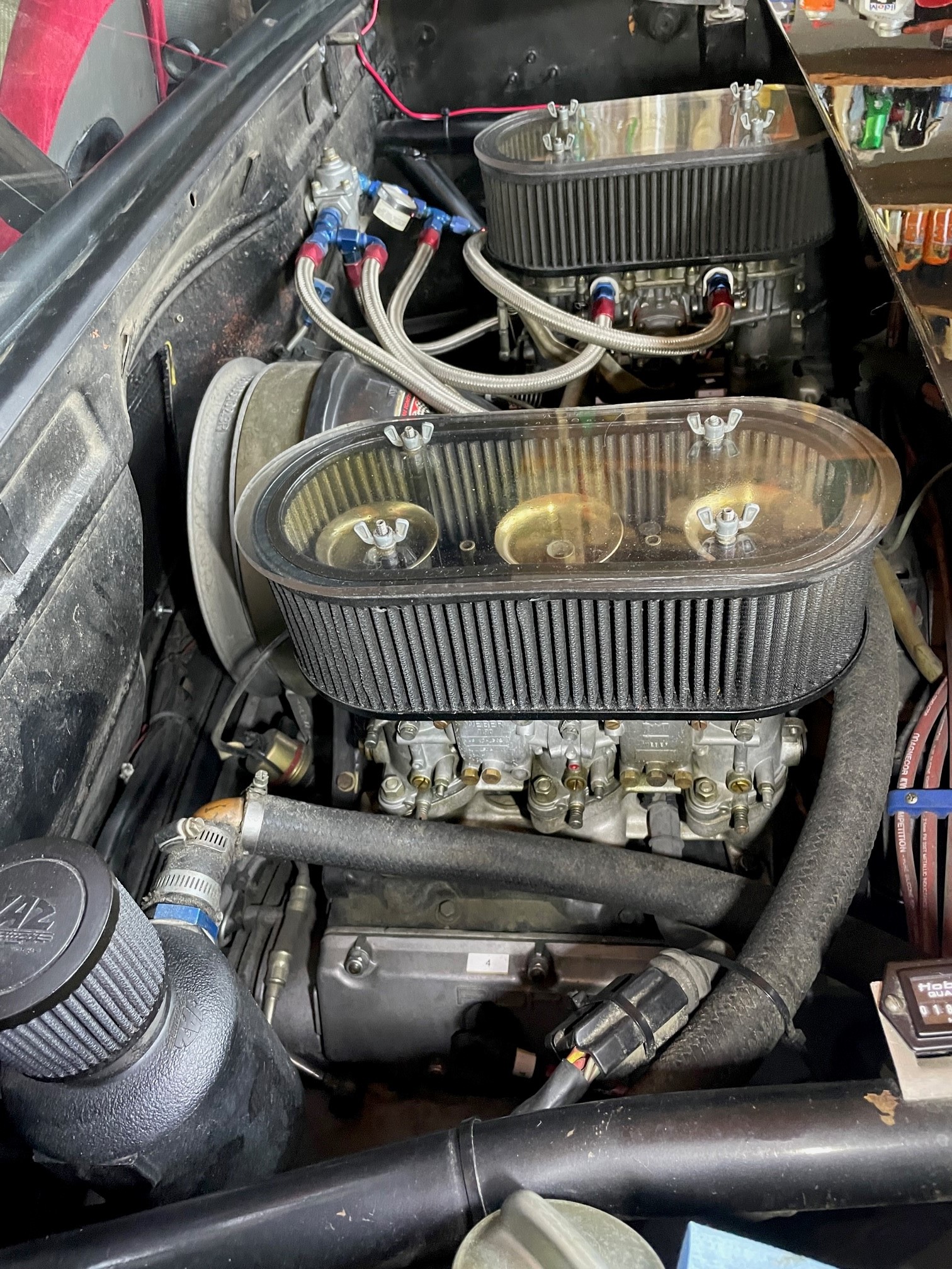

I did a set of Rix clears on my 6. These are the cut down race versions. Pmo carbs with standard height intakes. I have a gt lid but still has the cross beam and fits okay. However the rear firewall was modified (cut down) at some point so that may affect fitment.

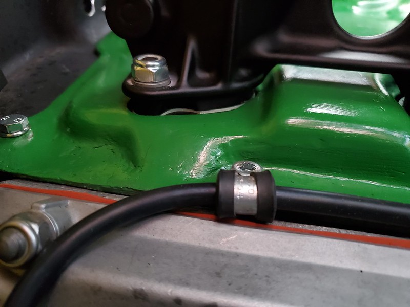

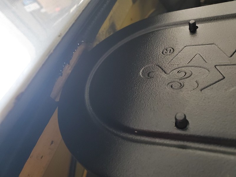

I guess my mount is welded a 1/4" too high OR the phenolic spacers are causing the clearance issue. This is without the filter on. It is right there. With the filter it pushes it up to where I have it cut out. Guess I just need to live with it.
(IMG:http://www.914world.com/bbs2/uploads_offsite/live.staticflickr.com-18763-1654173940.1.jpg)
(IMG:http://www.914world.com/bbs2/uploads_offsite/live.staticflickr.com-18763-1654173941.2.jpg)

FWIW, -6 conversion running Zeniths (with phenolic spacers) and the K&Ns, with rain hats - no clearance problems:
No trunk lid hinge springs either though. Wondering if your motor mount is a tad high? Does the chassis metal line up with side engine tins and seal OK?
- Tony

QUOTE(nditiz1 @ Jun 2 2022, 07:47 AM) *
Thanks Tony, sent you an email requesting a pic of the 1,2,3 side, like I have in my previous post.
Pics sent via email Nick. Let me know if you need more detail, angles, etc.
Comparing to your posted pic (above), I think the forward/aft placement is about the same, just your carbs/filter sits about 1/2" higher than mine. I can comfortably get the rain hats and filters on and off without fuss. Depending on the motor mount you chose (I have a Maddogs item), you may be able to machine up a shim to sit between the chassis mount and the engine mount to lower the motor slightly. Just need to watch clearance on the shift linkage as the motor is lower,
- Tony

Nick with conversions I think it’s where that engine mount is situated. I have a Rich Johnson mount and it’s prolly a little different than other vendors and especially the factory. My 1,2,3 just kisses the rubber seal on the trunk. I actually used glycerin to let the “hats” slide by.
