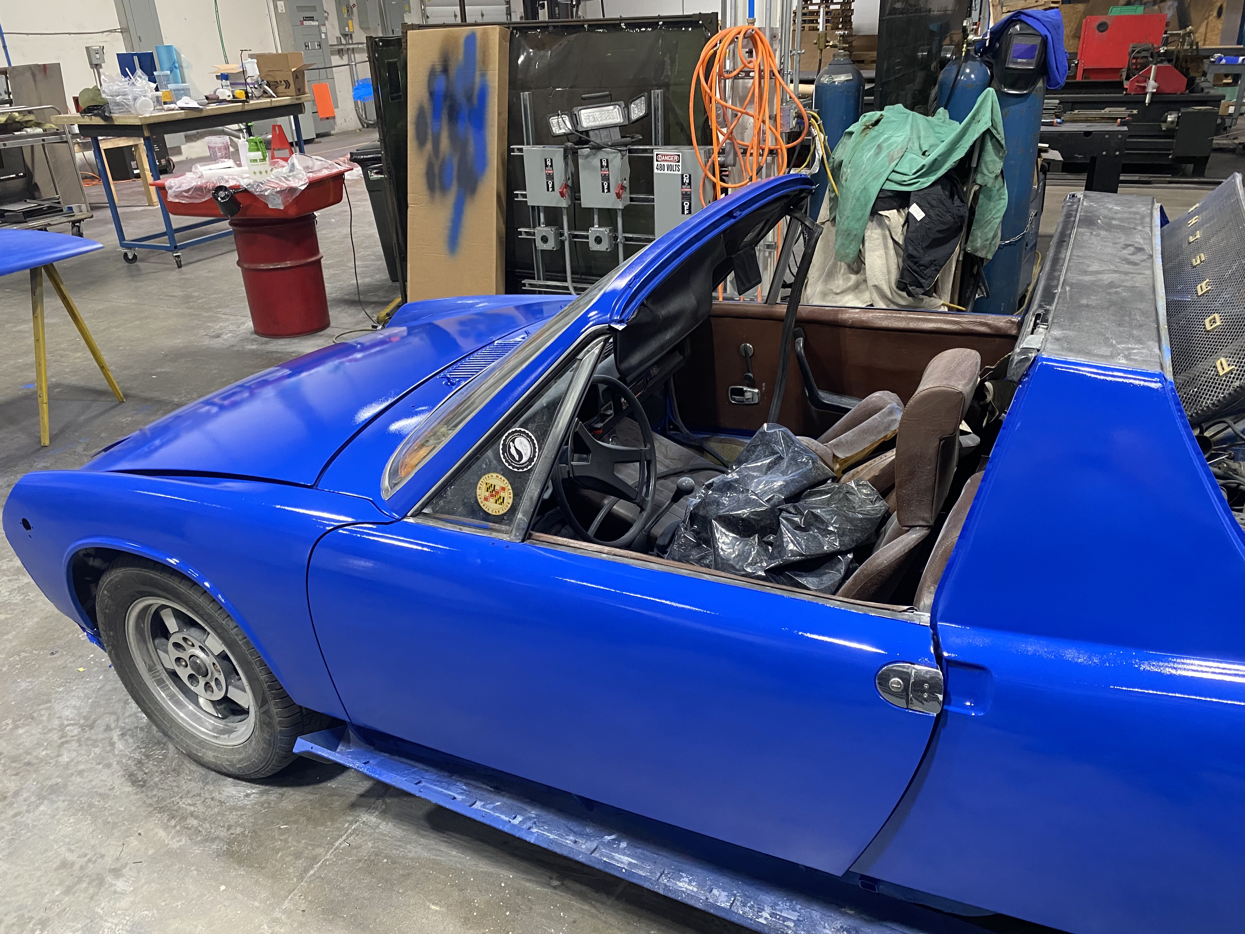

That's with two coats of base / clear coat. It still needs to be polished and waxed to get the orange peel out.

I'll ask him. I'm not sure if you'd get the same price.. haha.. Also, as you can see in the pics, it wasn't a full on restoration. We didn't remove the glass or seats or any of the chrome, he just taped over it.
