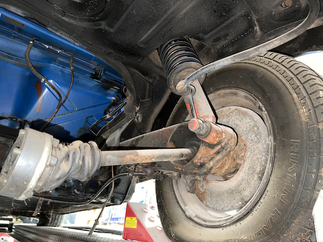

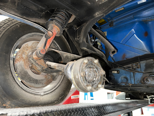

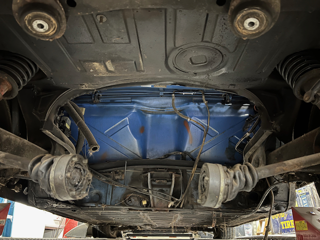

As it sits...
Attached Image Attached ImageAttached Image

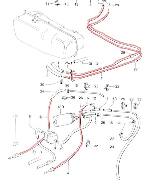

Are the ones highlighted red the offenders?
  • Fuel line Centre Intake pipe: 914-356-530-01 (914-6, -71)
  • Fuel line Centre Return line: 914-356-513-00 (914-6, 914-4, -71)
I don't see those parts, or one that superseded them, available at any of the usual vendors. Are you left to make your own?
