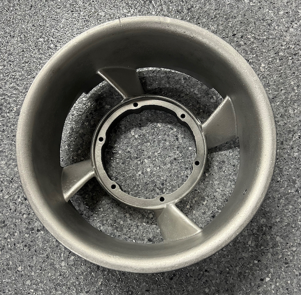

QUOTE(mepstein @ Sep 27 2022, 10:07 AM) *
They were coated with some stuff to help corrosion but it didn’t add any color to the material. Not like paint, powder or cerikote. Basically if you lightly bead blasted and wipe down with WD-40, it will look similar.
Hey mepstein. Here's my after (light glass bead blast) photo. I've been reading some good things about Gibbs Brand Lubricant on magnesium. Any experience with that?

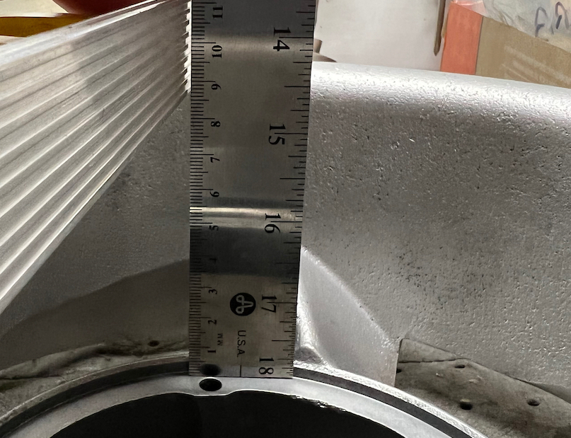

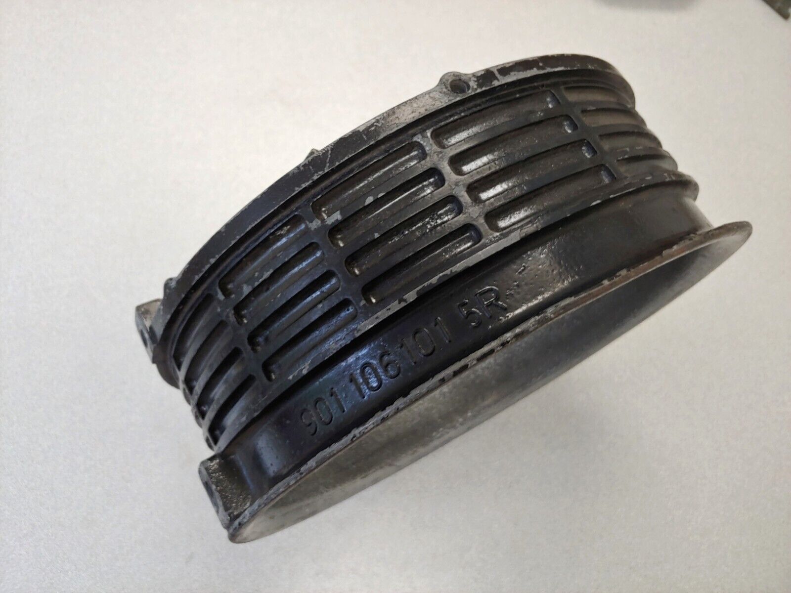

QUOTE(davep @ Sep 27 2022, 04:59 PM) *
The castings can be machined to different depths for different alternators. Make sure of the fit when installing.
Excellent point Dave. Luckily I discovered this when I started investigating the casting numbers. I did a blog post on the variations I'm aware of. My understanding is, if you’re about a 914-6, you should be looking for casting number 901.106.101.5R with a depth of 86 mm (lip to alternator mount face). Please feel free to correct me if mistaken.

QUOTE(DennisV @ Sep 27 2022, 11:19 PM) *
Yes. I used Gibbs on a couple pieces years ago and it’s held up well. It’s just a light coating but it makes it hard for dirt to take hold. Just reapply with a rag as needed.
