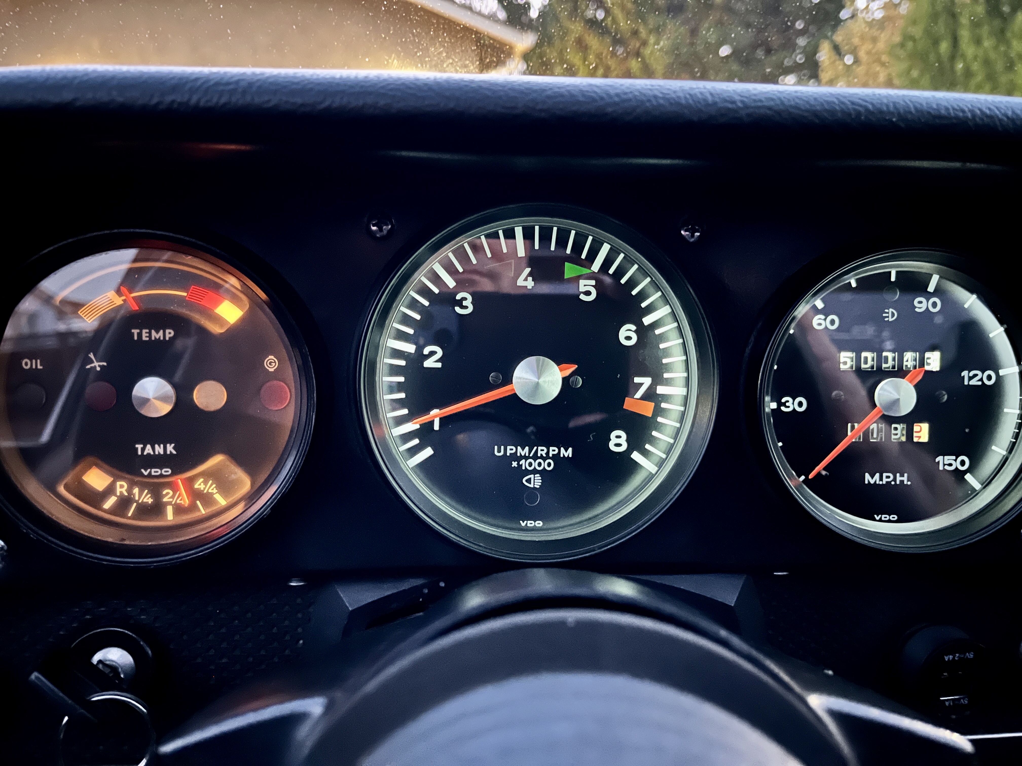

I am in the process of changing the standard bulbs in my gauges to LED bulbs. On the 914-6, the far left gauge has the generator bulb that must stay as a filament bulb to keep the charging system working properly. I want to confirm that only the bulb behind the āGā, on the far right of the gauge, is the only bulb that must stay a standard bulb for the charging system to function properly. Can someone confirm for me.
I am also not sure what the indicator light to the left of the āGā indicates. Please chime in if you know. Attached thumbnail(s) |

Dave_Darling The "G" light is the correct one for the... Oct 5 2022, 02:07 AM

The "G" light is the correct one for th... Oct 5 2022, 06:49 AM
barefoot On my 76 with presumably stock gauge, that white (... Oct 5 2022, 08:00 AM
GregAmy It used to be at http://p914.com/p914_gauges.htm b... Oct 5 2022, 08:26 AM![]() ![]() |
