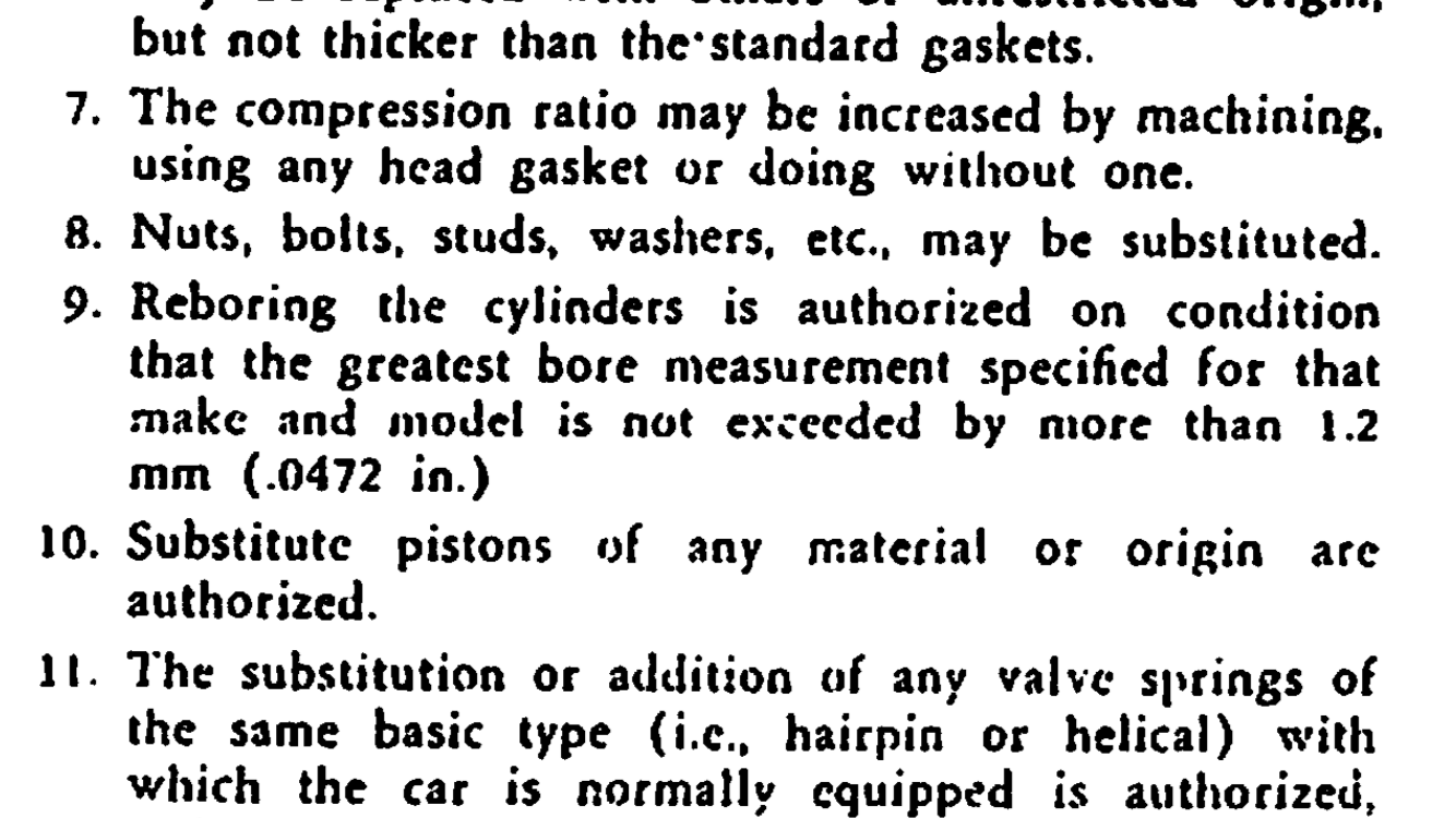

Found it in the 1972 GCR
1.2 mm bore
So a 95mm cylinder would be legal
But not 96
It’s a rule created to allow water cooled cars to salvage their blocks
Not intended to create a performance advantage
The throttle body size is also regulated in the 1972 PCS
But carbs are accepted and solve that problem as well as work with a real race cam/high lift/more rpm. You can buy JE pistons in any compression ratio you want
