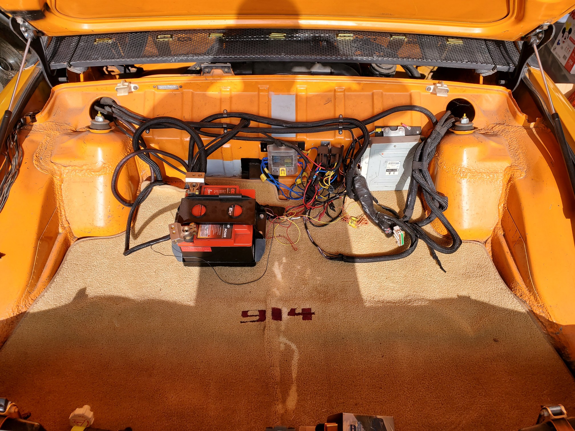

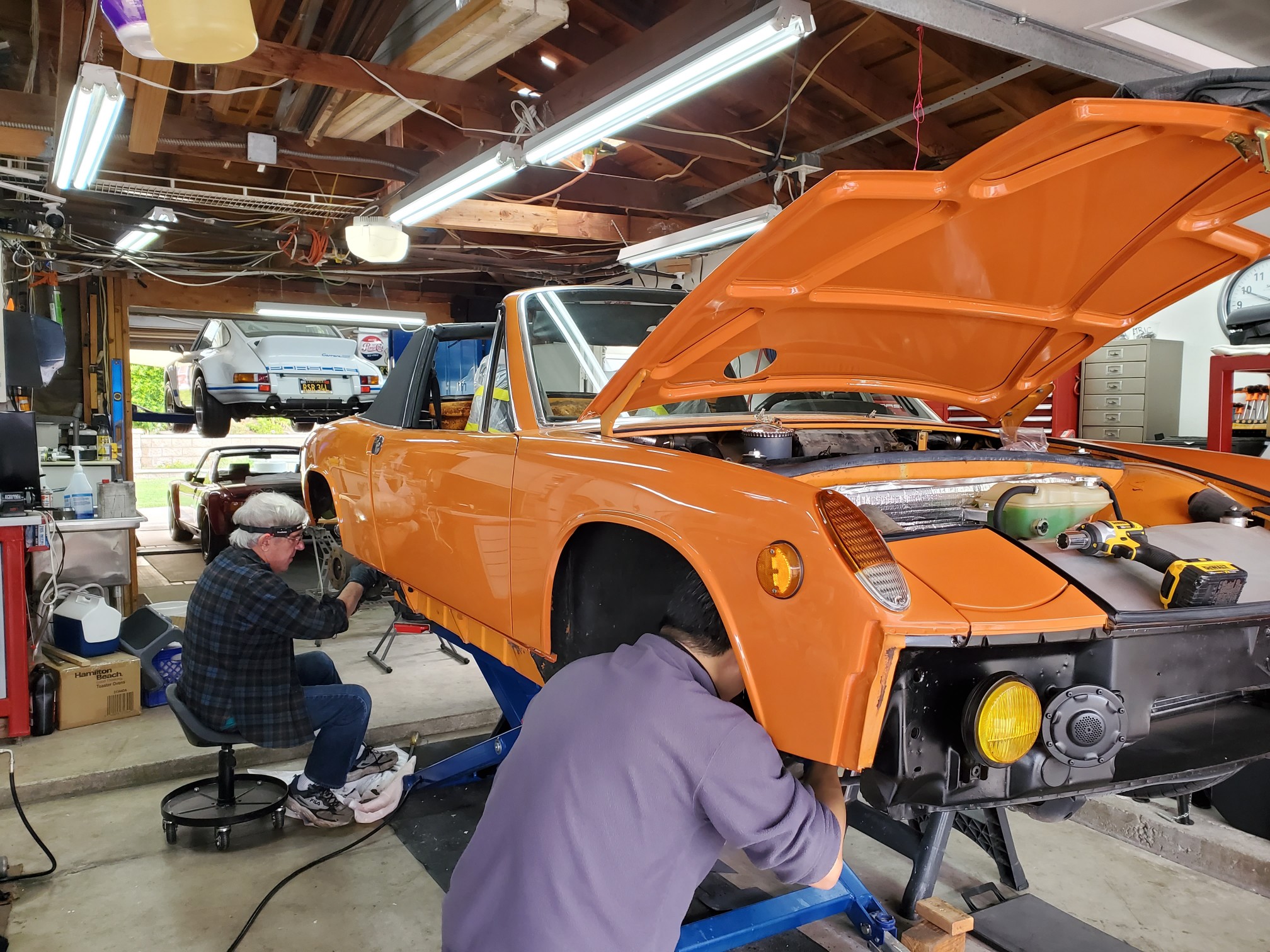

Anyhow, 914 ran well but had an intermittent short that ate up batteries. I decided to paint the exterior of the car before tackling short. Once, painted, Noel and Bruce helped me one Sat with 5 lug conversion.
My goal was to get the short figured out and move the harness and battery bank to the engine bay.

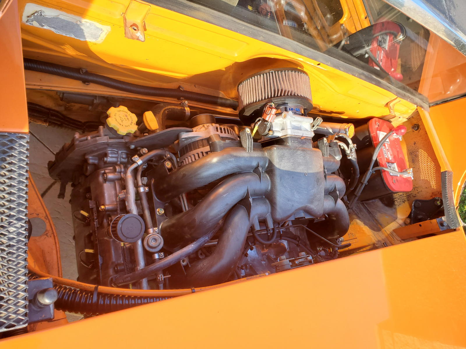

One week later I’m absolutely stunned on what they accomplished. Lots of upgrades to fuel and cooling systems, a new ECU wire harness relocated to engine bay. There is a detailed list of things I’m forgetting that I will post later. In a nut shell, Dyno shows 272 HP with 223HP to wheels. I got a test drive last night and I was totally floored. Super smooth and responsive. I can’t wait to pick it up this afternoon.
Is this a typical HP range for this engine?
Rev limited to 7500 rpm? Is this ok?

BTW…The new wire harness is now 75% smaller and tight…super professional
Bonus, my rear trunk is free on any modifications or loose wiring.

Looks like an awesome car! Would love to see the detailed list of what’s been done. I’m in the middle on an EZ30R conversion on my car and did talk to Outfront about ECU options, so I would love to know what’s in your car. I think these late-gen motors are rated at 240hp, so your 272 sounds great. The redline is higher than the stock motor I think (maybe 6800 stock), so again 7500 seems really good. It was one thing that I wished was higher when I was making my decision, so I’m glad to hear Outfront seems comfortable with that redline increase.
I would also be interested in knowing whether your car has drive-by-wire throttle and whether the variable cam timing is still in place (the feature is run through solenoids on each bank). Must be a fun car!

Super nice Oscar. Watch out; you may find yourself driving rather than towing to events. (IMG:style_emoticons/default/biggrin.gif) I've seen similar numbers on a D model and attributed that to better engine breathing. These engines were originally choked down with 12ft of exhaust. I'm curious which models will produce the most HP when installed in a 914. Since yours was just tuned by "THE Suby Voice of SoCal" I'm going to bet yours is faster than one built by a plumber. (IMG:style_emoticons/default/lol-2.gif) Question; are you experiencing any Rev Hang with the DBW system? I wanted to join your drive this weekend but I'm out of state currently. (IMG:style_emoticons/default/sad.gif)

Nice one Oscar, is there any other place for the battery available? If I built another one today I would throw the T4 out and go Subaru six for sure. My only reason for keeping the T4 in the Martini build was to be able to participate in the local P club autocross events and those have grown into a boring mass of only new cars now.

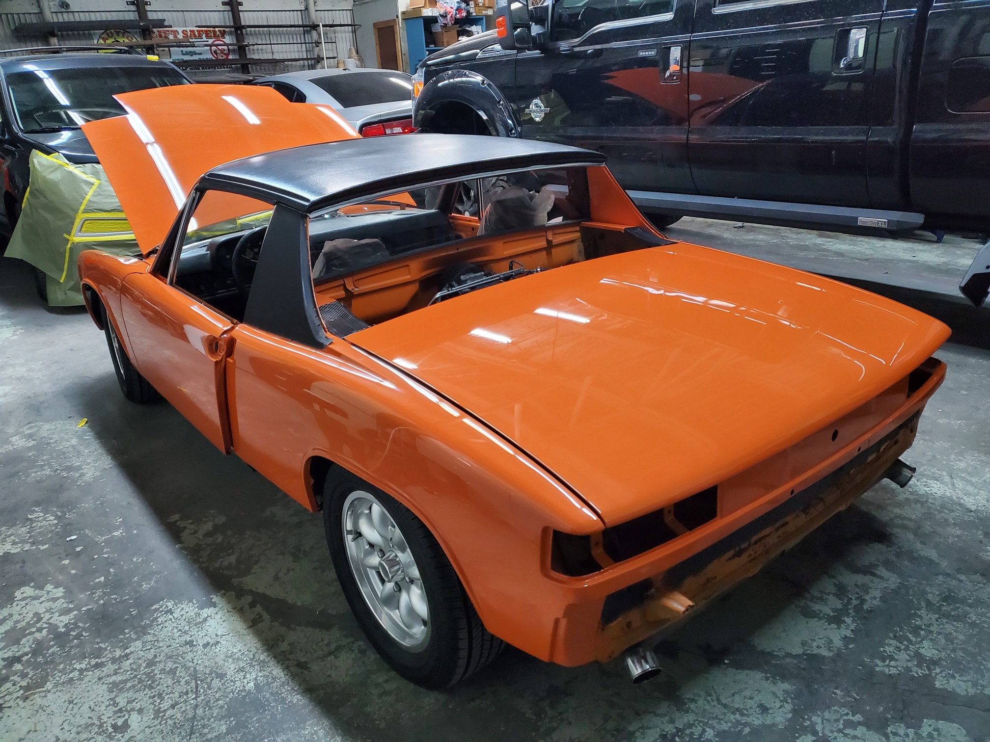

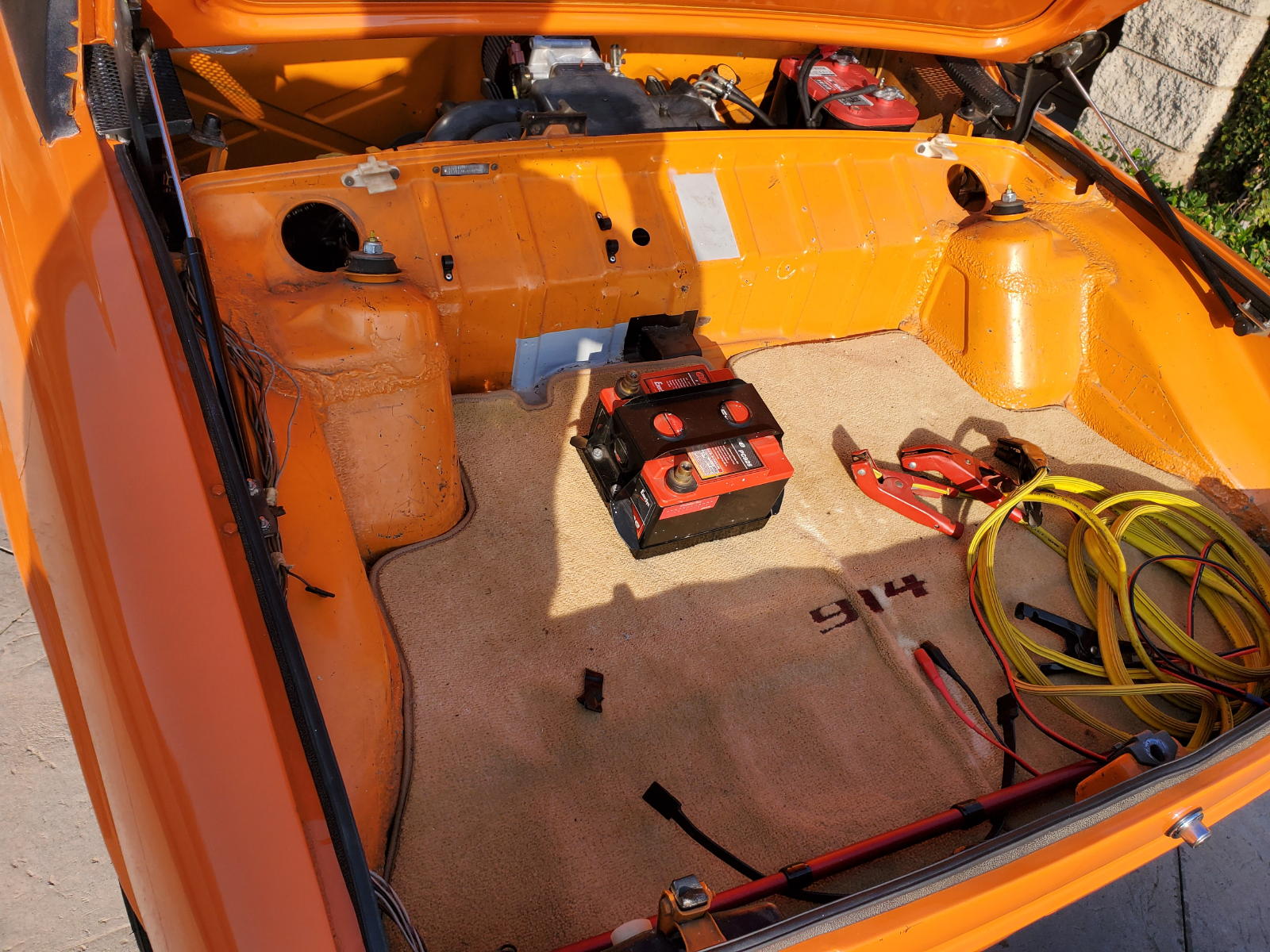

BEFORE PHOTOS
Attached Image Attached ImageAttached Image
nditiz1
post Oct 7 2022, 02:37 PM
Posts: 1,272
Joined: 26-May 15
From: Mount Airy, Maryland
Member No.: 18,763
Even though I have a 6 in mine now, I'm somewhat envious of the subie eng. Oscar how come the PC925 didn't make it in the red optima spot? When people catch their eye on my PC680, they can't believe that tiny bat is up to the task, but it has been flawless.
ValcoOscar
post Oct 7 2022, 02:43 PM
Garage Life
Posts: 2,602
Joined: 19-November 13
From: SoCal
Member No.: 16,669
QUOTE(nditiz1 @ Oct 7 2022, 01:37 PM) *
Good eye (IMG:style_emoticons/default/biggrin.gif)
That PC925 is DEAD, will relocate a new one to the engine bay soon.
Oscar

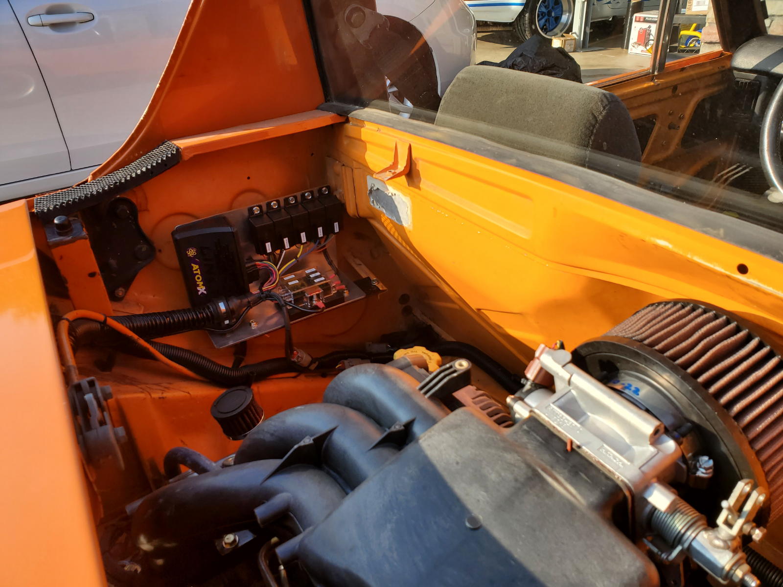

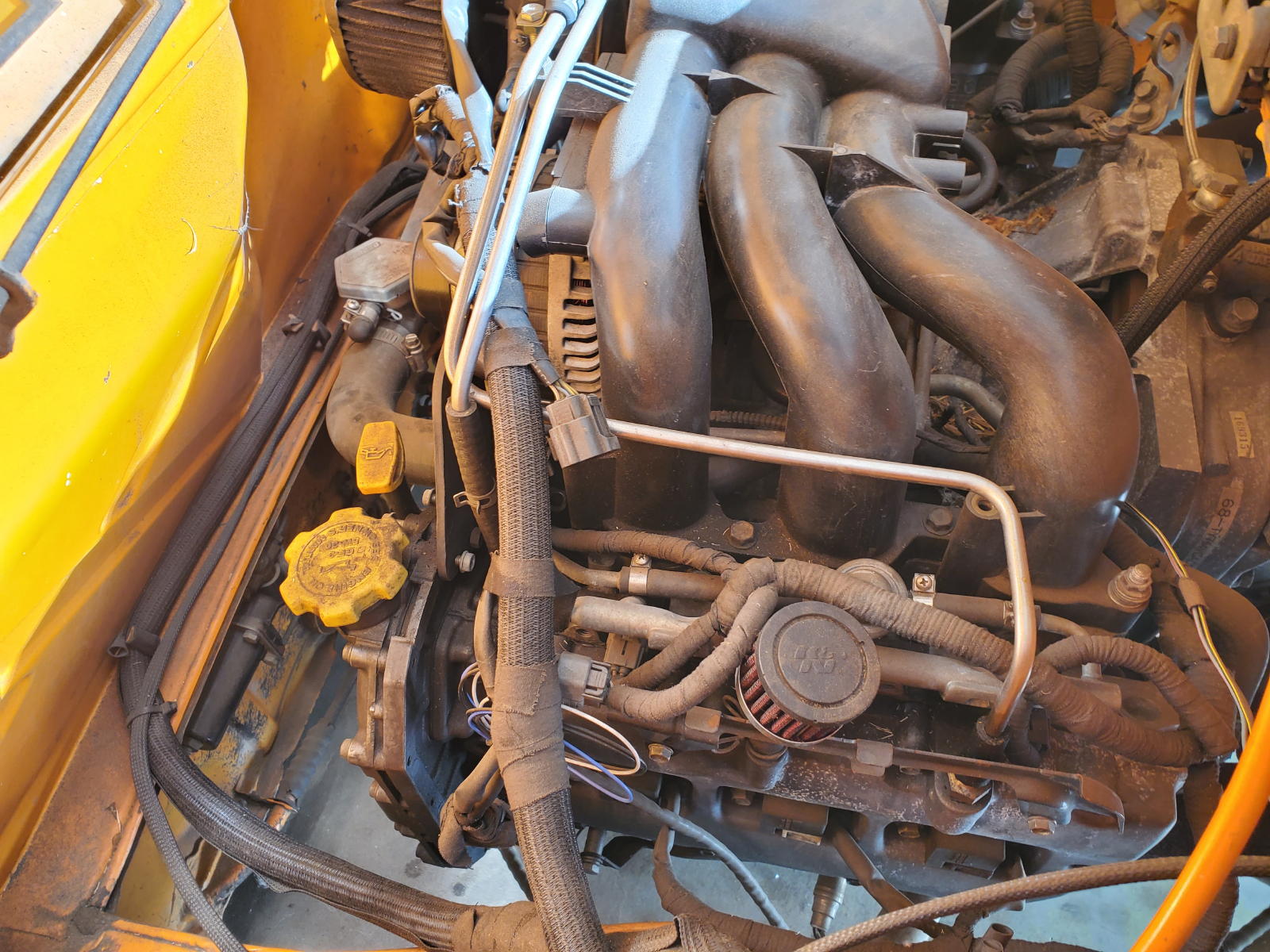

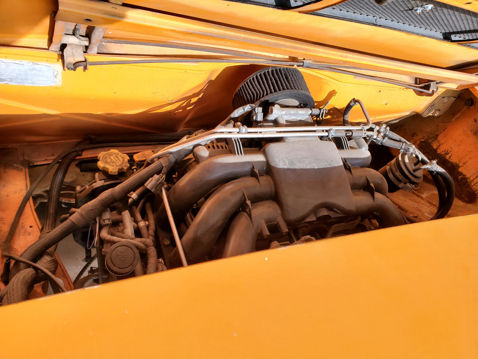

Did they turn the intake manifold 180 degrees?
cali914
post Oct 7 2022, 06:33 PM
cali914
Posts: 458
Joined: 26-April 06
From: Berkeley Ca.
Member No.: 5,934
Love the orange
ValcoOscar
post Oct 7 2022, 07:27 PM
Garage Life
Posts: 2,602
From: SoCal
Member No.: 16,669
QUOTE(rmarx @ Oct 7 2022, 04:52 PM) *
The Intake was turned 180 deg before I took it.
That way no cutting was required to trunk
Good observation
O

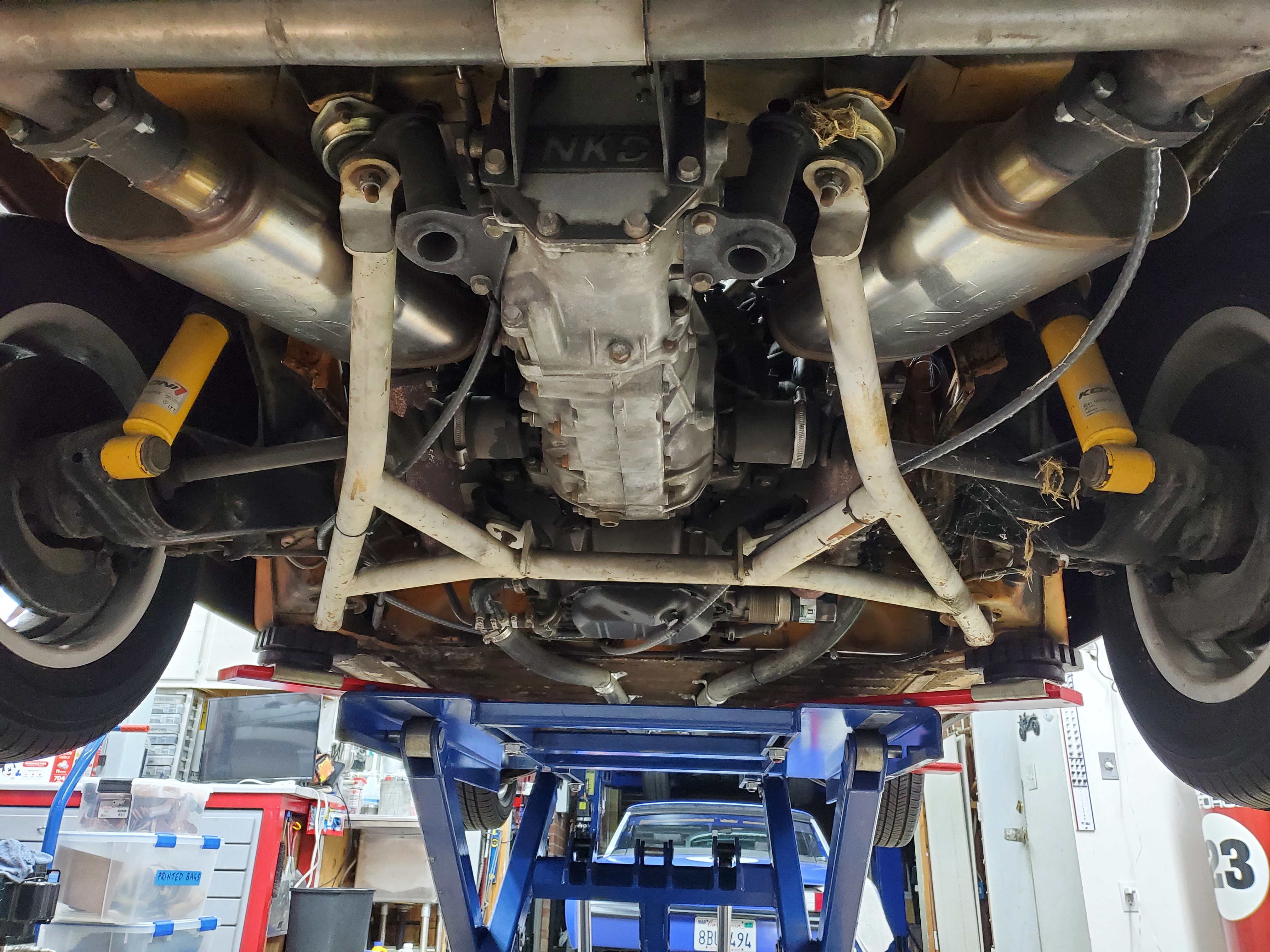

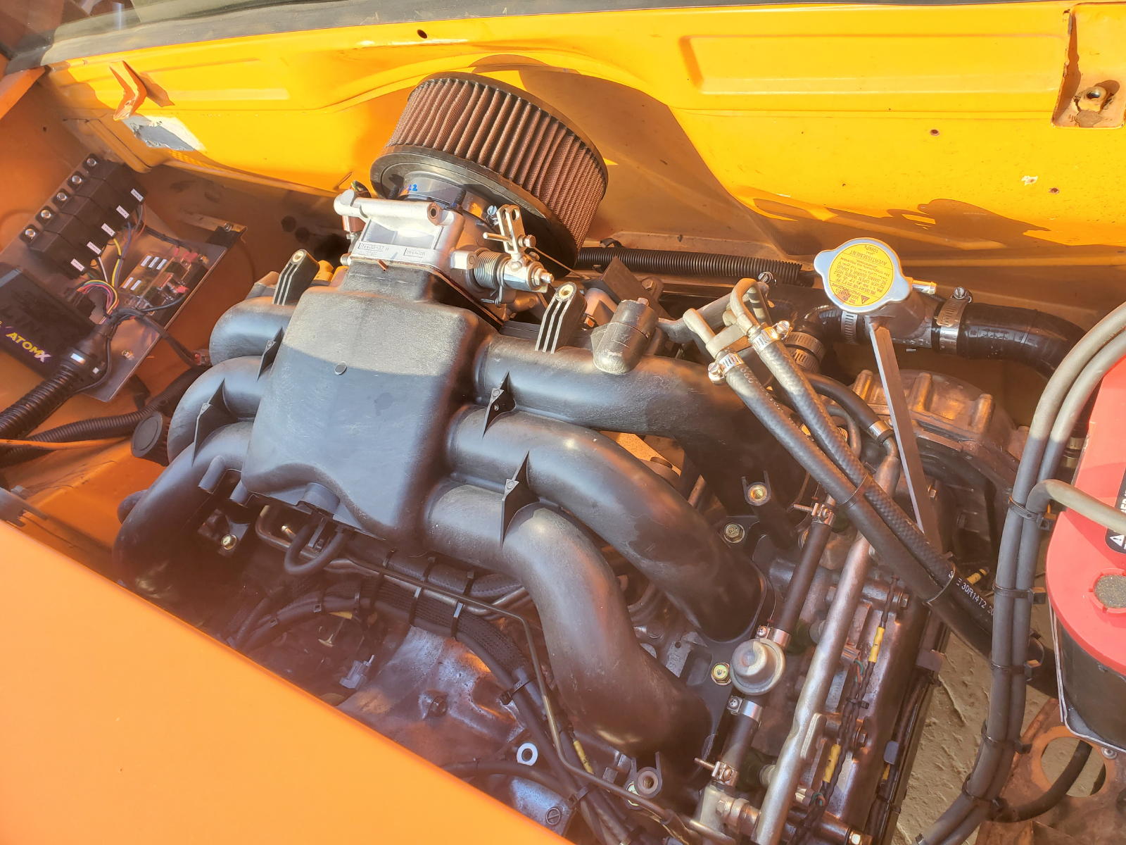

It looks great and it is about the same why I want to go. I will stay with the 4 x 130 wheels but I will see. I will go with the Subaru MT5. How do you like the power ? Does it have the a custom motor cradle or is it a a Coldwater ?
Thanks.
ValcoOscar
post Oct 7 2022, 07:50 PM
Garage Life
Posts: 2,602
From: SoCal
Member No.: 16,669
QUOTE(914GTSTI @ Oct 7 2022, 06:32 PM) *
Thanks.
I love the power but probably won't use it much.
The exhuast note is awesome
Here's a photo of cradle...not detailed yet
O
