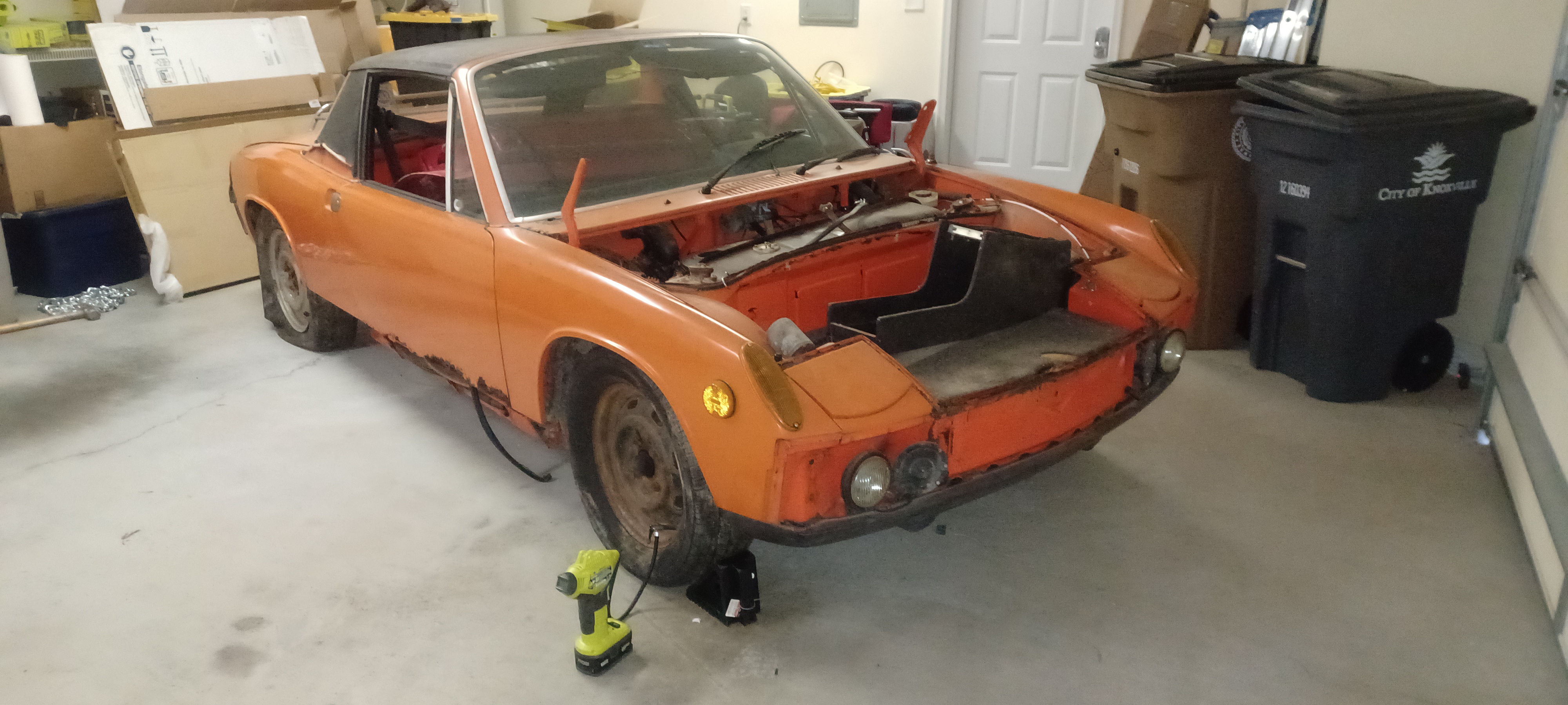

Here ya go! 3+ hour ordeal getting it on the trailer: discs dragging badly, crappy HF come-along wouldn't release reliably, tires wouldn't stay aired, etc., etc. almost late getting back home to U-Haul for the trailer return, luckily it rolled off way easier than it went on.
I discovered this 74 is already in the register. More details to follow.

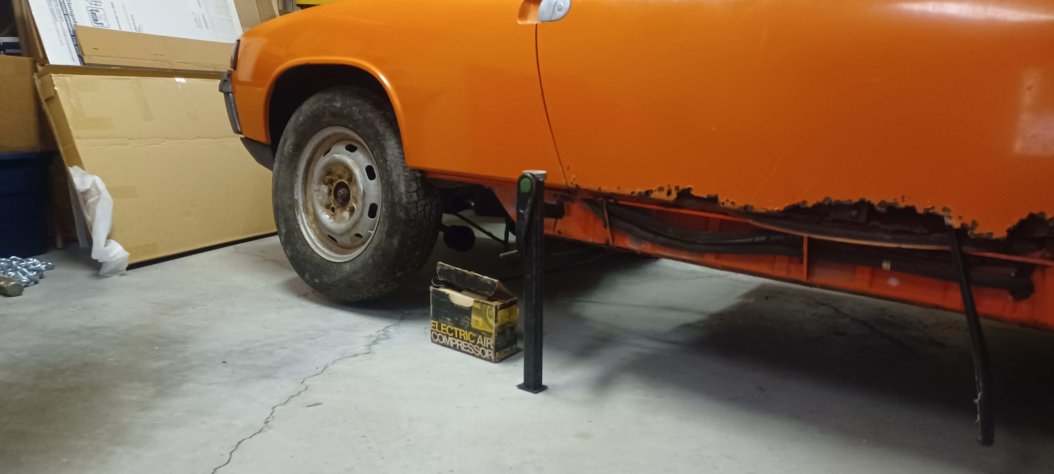

...passed the all important jack test!!

Is that a longish hole in the lower portion of the door? but the long looks good. Glad you made it home in one piece and good luck with the resto
