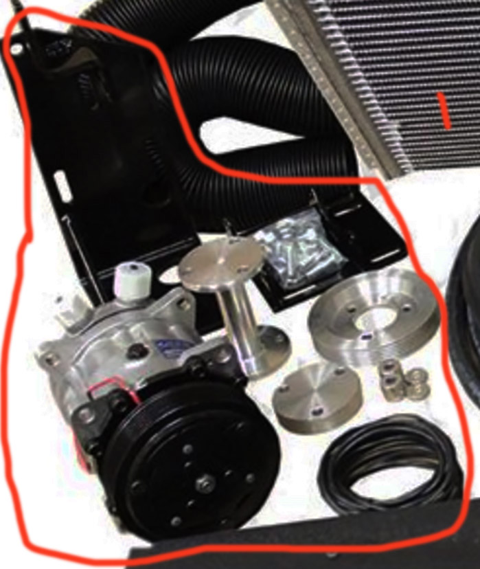

Mark Sonners and I are trying to figure out an elegant way to put AC in his 2170 that is at PMB Performance. Chasing the nonelectric compressor. Lots of great ideas including @Larry.Hubby ideas for air controller in stock airbox. http://www.914world.com/bbs2/index.php?sho...=316728&hl=
One thing is not to put the compressor on Eng in the place the aftermarket guys did for the Porsche dealers but, Thinking of using parts like they are using for 912E Porsche set up. It would go in the same place as the smog pump went in the 75 and 76 cars but without the sacrificial rubber pulley that always breaks when the smog pump freezes and are not only expensive but used ones seen to need new bearings and the parts are very hard to get. This picture shows parts from one of the 912E kits and I think of just using what is shown circled in red. If my bad memory is working, I remember one of our members making these parts but they can be bought from one of the custom / hotrod AC shops.
What do you guys think of this set up on a 2170 type4 end with Webbers?

Sanden compressor. Used by all the Hot Rod AC sellers. They come in a few sizes and mounting points. There is also a generic bracket made for them that can be modified for 914 use. Over the fan is probably the best location if you can make an extended pulley.
All the underdash assm are made in China so no need to spend extra at a Hot Rod specialist for "theirs", it's not unique or better.
Seriously think about mounting the cond under the engine lid. The majority of cooling comes from the fans anyways.

Bob, whatever you do make sure the compressor is a real Sanden.
Sanden "style or type" means a Chinese copy.
Sanden stickers are normally green. UAC stickers are solid blue.
UAC is Chinese crap...
Sanden compressors are NOT expensive. Here's one from Vintage Air for $230...
https://www.vintageair.com/custom/product-p...hp?pn=04808-VUA
You can get it polished for another $55 or chromed for $120.
If you look close at the pictures on the VA site, you can see the green stickers.
Do a bit of searching and I bet you can find a real 508 for less than $200.
Sandens are drop dead reliable. The 508 is the single most adapted compressor in history. Mounting one as you have suggested has been done many times. I found threads this forum regarding exactly this.
You can get a 508 with many different drive pullies and many different end caps (where the hoses connect). This model is definitely the most adaptable compressor that I am aware of.
This is an old school cycling style compressor that has enough load to be obvious when it cycles. I want to avoid a cycling style compressor if possible.
