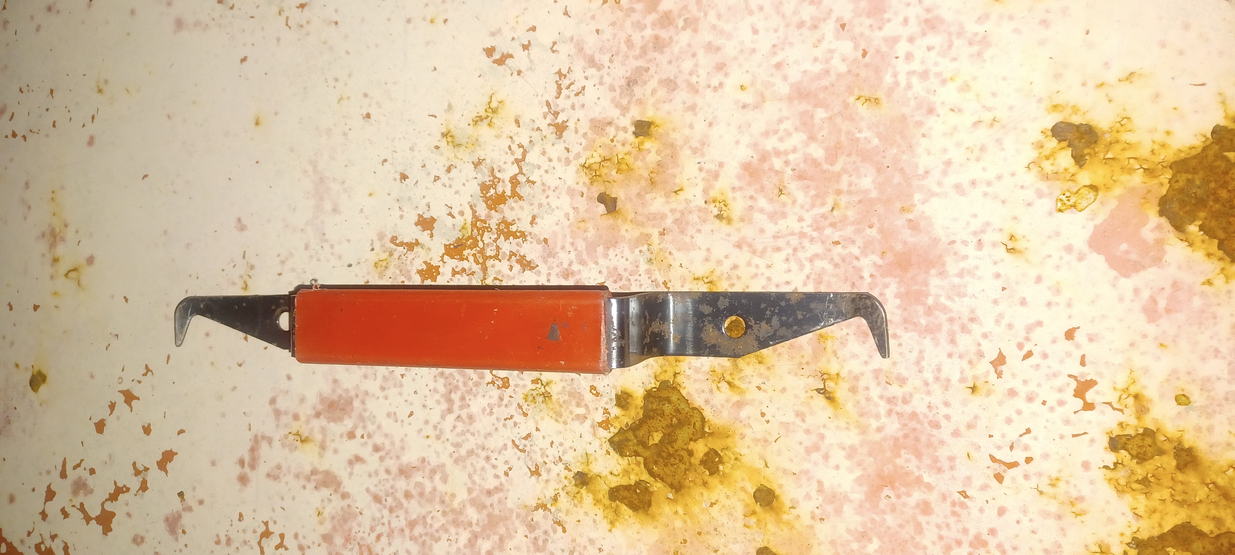

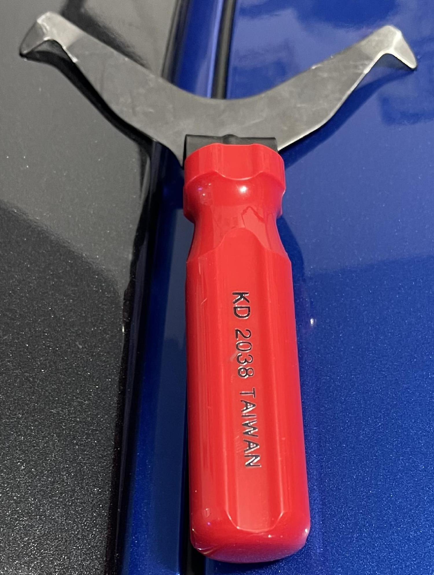

> Is this a trim tool used for 914 windshield trim removal?
914rrr
post Feb 17 2023, 11:51 AM
Posts: 2,038
Joined: 1-July 03
From: Knoxville, TN
Member No.: 874
I bought this tool 30-40 years ago and recently dug it out of storage. IIRC, I bought it from a Mac Tool dealer and it was used for removal of trim and could be used to remove 914 windshield trim. I also think it used to have rubber or vinyl inserts where the holes in the handles are.
Is this correct? Also, are there better / stronger / thinner tools for removing windshield trim?

Cairo94507
post Feb 21 2023, 05:13 PM
Michael
Posts: 10,609
Joined: 1-November 08
From: Auburn, CA
Member No.: 9,712
I do believe that is a tool for 914 windshield trim. It has been a long time since I put a windshield in a 914, but that tool looks very familiar.

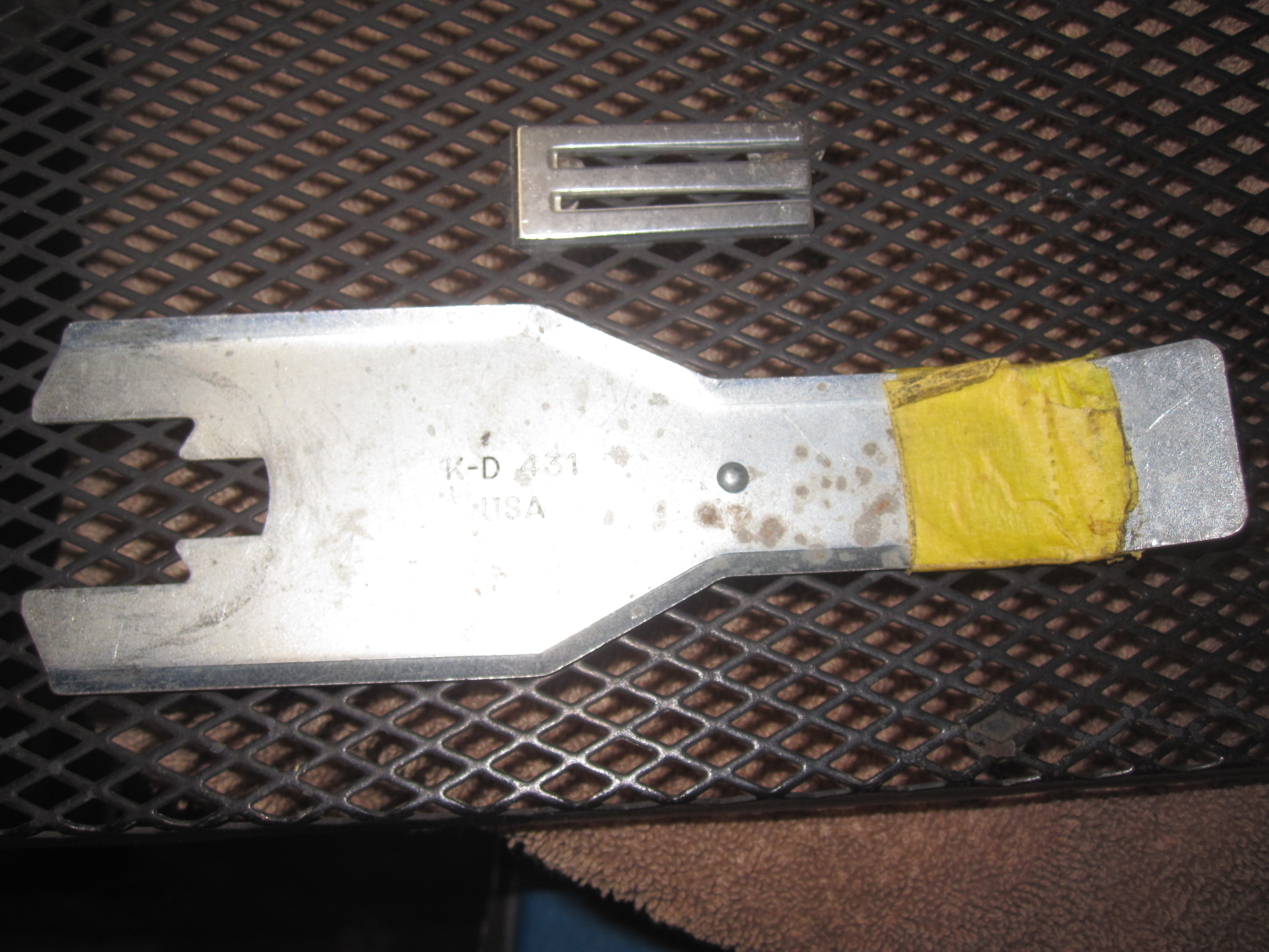

rgalla9146
post Feb 21 2023, 07:16 PM
Posts: 4,950
Joined: 23-November 05
From: Paramus NJ
Member No.: 5,176
This one works for me.
Slip the flat end between the glass and the trim and lever the trim from behind the
clip.
Not destructive and easy to use. Cheap too.
I put tape on it to protect the glass.

rgalla9146
post Feb 22 2023, 08:57 AM
Posts: 4,950
From: Paramus NJ
Member No.: 5,176
DO USE THIS TOOL !
If you need to remove your trim and you are not replacing your
windshield.
OR cut all 19 clips first then discover that they can not be replaced without
removing the windshield. (IMG:style_emoticons/default/smile.gif)
PS; it is just as easy to bend the trim installing it as when removing it........patience pays

QUOTE(Type 47 @ Feb 21 2023, 06:36 PM) *
I got mine from 914 Rubber $21
Now that I see this, the one I have may originally had "bent" tips on both ends vs flatter tips. I saw the bent tip and assumed I'd (mis) used it and bent the tip on one end.

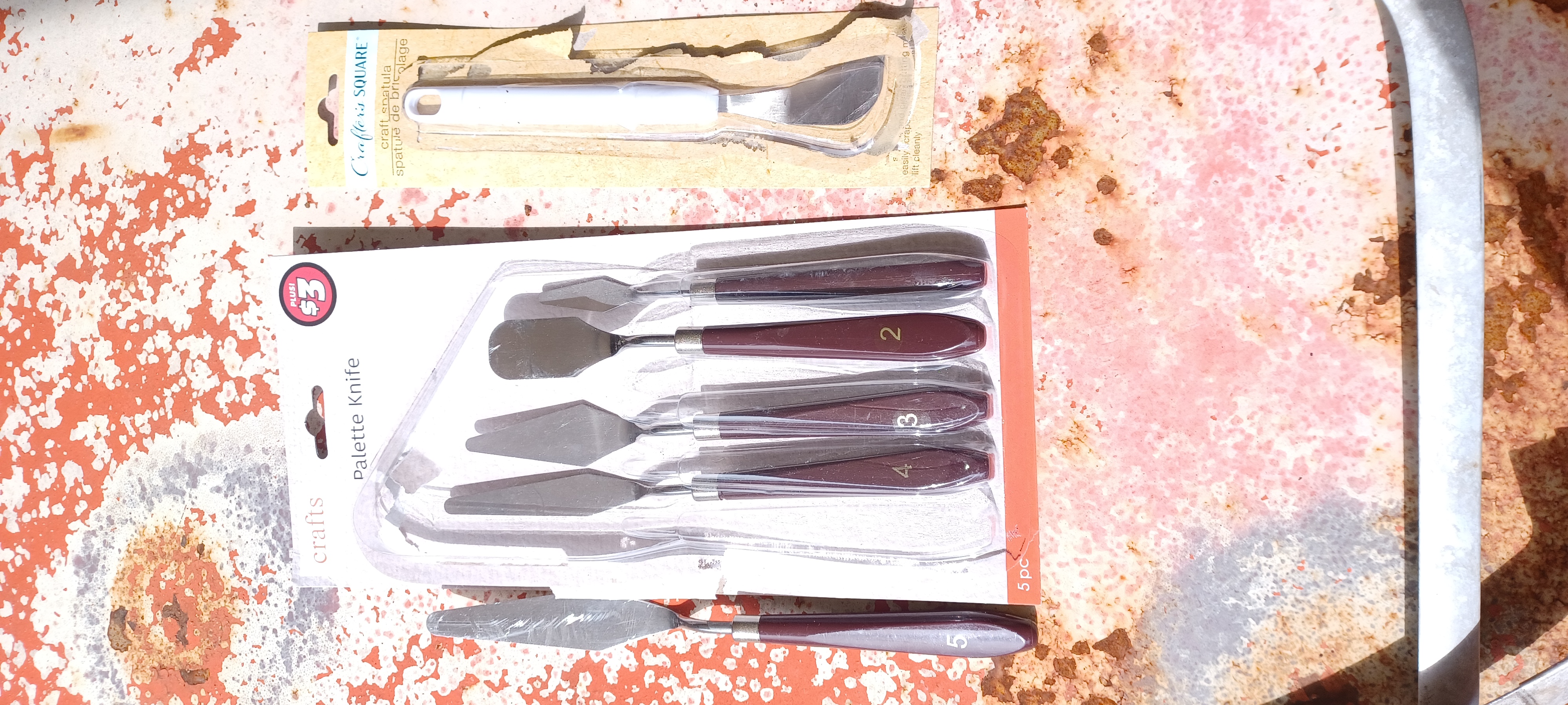

I successfully removed the windshield trims on both cars recently. I used the pallet knives and craft spatula I bought at Dollar Tree (DT) pictured below to get things started / loosened up a bit and went back with the larger trim tool to remove them the rest of the way.
BTW, DT has a heavier duty hook pick with a white handle like the craft spatula. My wife hates it when I go to DT un-chaperoned as I rarely walk out with less than $25 worth...
