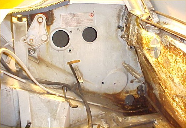

read through those long post
Hey! (IMG:http://www.914world.com/bbs2/html/emoticons/dry.gif) Here's a nugget from mine...
Vellios Aluminum tank. Factory location and large capacity.
KT

Factory location is an easy choice... All holes are marked ( almost ). (IMG:http://www.914world.com/bbs2/html/emoticons/wink.gif)
Easy install.

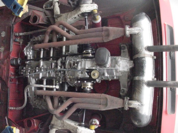

SS braided hoses are a leak waiting to happen. Look racy, though.
What?
Perhaps the cheap-o ones are a leak waiting to happen, but I only use teflon lined ss braided hoses for oil lines.
I go to the hydraulic hose store and they happily make up hoses for me with proper hydraulic fittings instead of those aluminum ones I see so often.
We went with a round tank and mounted it up front (Peterson Enterprises I believe).
It even has a drain on it. (I would recommend getting the sight gauge for it)

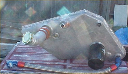

Hey!  Here's a nugget from mine...

I am running the same tank as Trekkor. Bought it new about 2 years ago for around $375. Sat around for another year before I got a 914 to do a conversion on. Good tank, has baffle, fits in stock location, uses later oil filter, already set up for AN fitings. (IMG:http://www.914world.com/bbs2/html/emoticons/cool.gif)

The only tanks I'd use would be the (priced as though they are gold plated) factory tanks or the aluminum fabricated tanks that GPR makes. The GPR tank is the lightest oil tank made for a 914-6, uses factory fitings or AN, and bolts up in the stock location. You can use all the factory tank boots, which makes for a very clean install. The factory filler neck fits perfectly too.
I think Veli-hose is out of business, which is just as well. The cast aluminum tanks have some advantages, but are heavy, and then there is lack of customer support, blah, blah. You can't use the factory boots, and they don't fit against the inner fender as well as the factory tanks, or the GPR tank. Also the factory filler neck doesn't fit right either.
Yes you can use a aftermarket "generic" tank, and many have done so sucessfully. My opinion is that in the overall scheme of a six conversion, a few hundred dollars more for a oil tank that fits right is spit on the griddle.
The dry sump system is the life blood of your six engine so be sure you do it properly.
