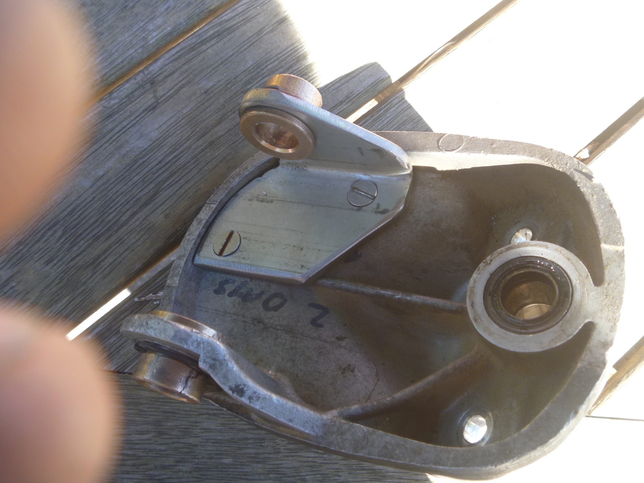

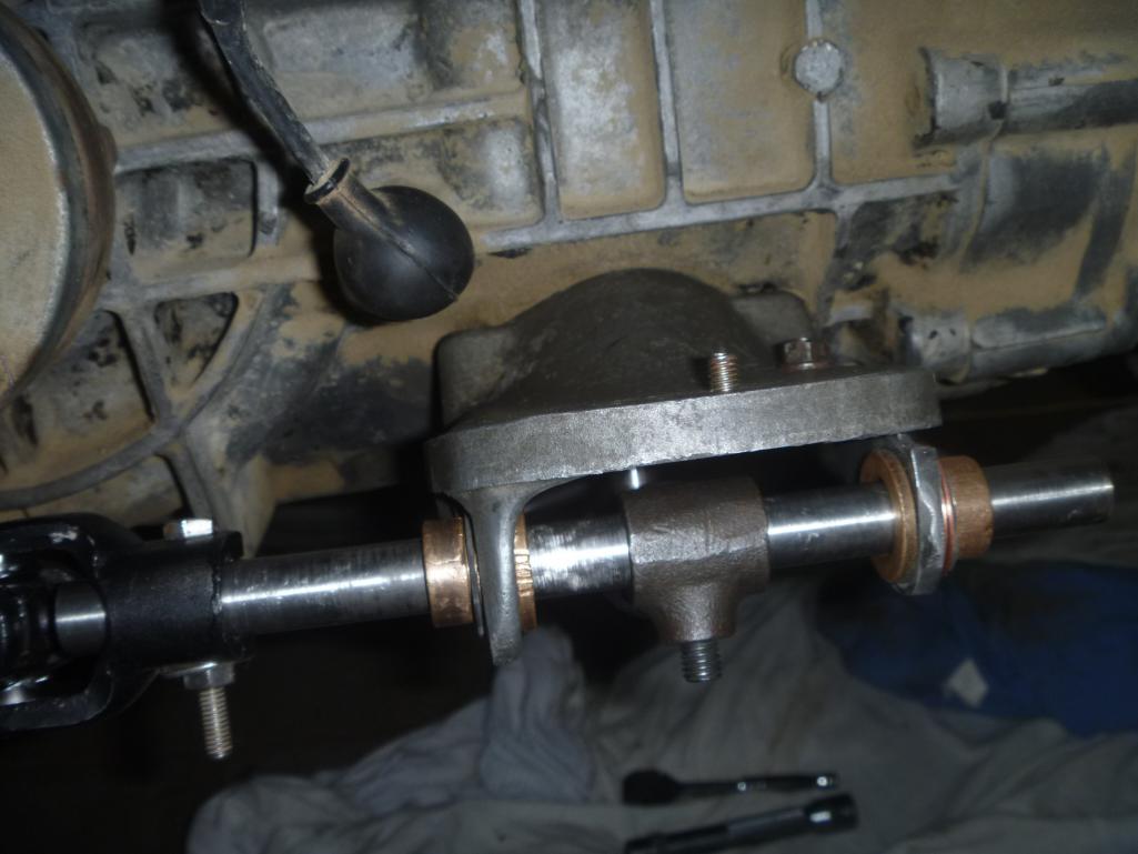

I use them on almost every car in the shop. I feel like they do help improve the shifting but only marginally. Another benefit is they won't deteriorate as quickly. I've seen shift bushings go bad/warp/elongate/etc. after only a few years in service.
https://www.pelicanparts.com/More_Info/PELB...6&DID=41219
I also use a bronze bushing at the side-shift connection.
http://www.914world.com/bbs2/index.php?sho...=342046&hl=
And if I really want to go all out, I use the Tangerine Racing spherical bushing too.
https://tangerineracing.com/shop/ols/produc...ift-rod-bearing

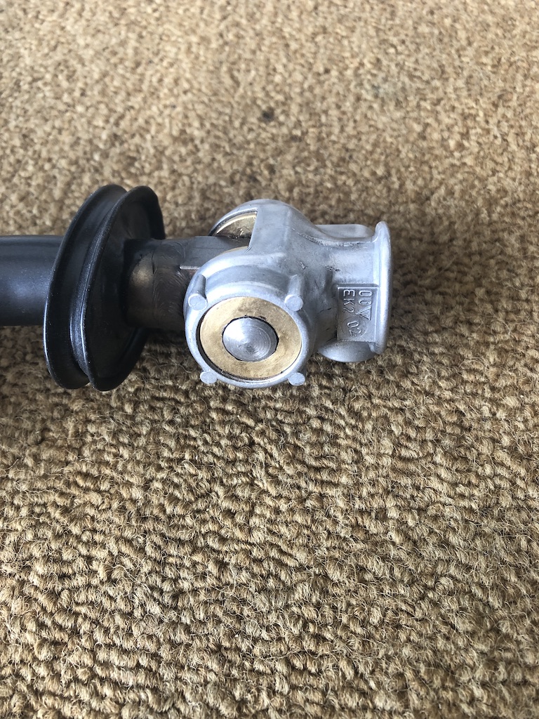

(IMG:style_emoticons/default/agree.gif) that makes them go it the fit is still rubbish even if the hole isn't flogged out,went to Tangerine FW bush first off ...real improvement ,got carried away after that and went with FW uni- joint then metal bushes and custom console shift mount and second uni-joint works a treat as per Tangerine set up.

Here is mine with late 911 reinforced shifter coupler. Please be aware you will HAVE to size the brass bushing (polish it down) to fit.
