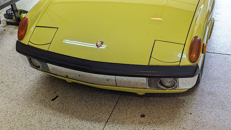

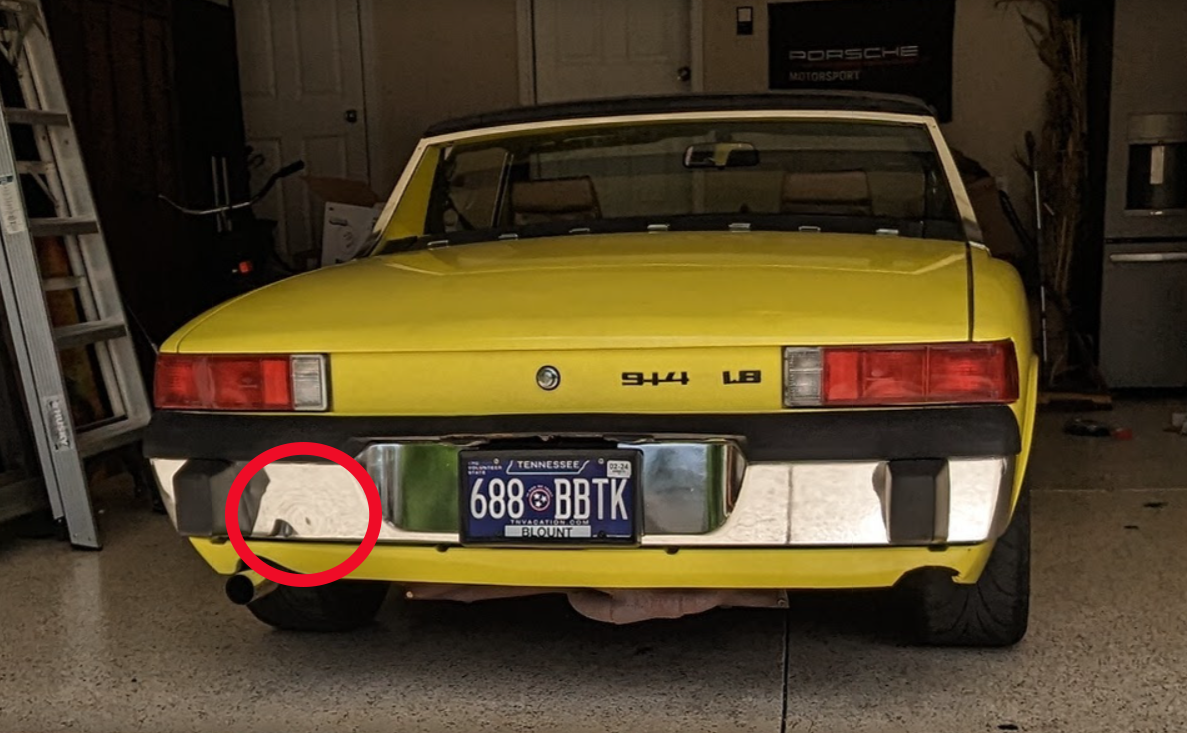

I wrapped mine - it turned out way better than I expected.

Yeah - it will stick to bondo. I had a little dent in my back bumper that I honestly never noticed when it was black. But, of course it shows up now. In fact - the chrome wrap will show EVERYTING under it. So, if your bumper is painted or powder coated and has the slightest texture you'll have 'orange-peel chrome'. I had to wet-sand both bumpers.
But - for $20 on amazon..... c'mon. (IMG:style_emoticons/default/smile.gif)

Yeah - thanks. For the cost, is was worth it to give it a try. There was a little trial and error, (and my wife helped with a second set of hands). It helps to use a hairdryer too to soften it up around the corners.

wow! that wrapped looks like a real chrome. Probably if you want just to try chromed bumper for the body color you have, this is a good test how it will look.
