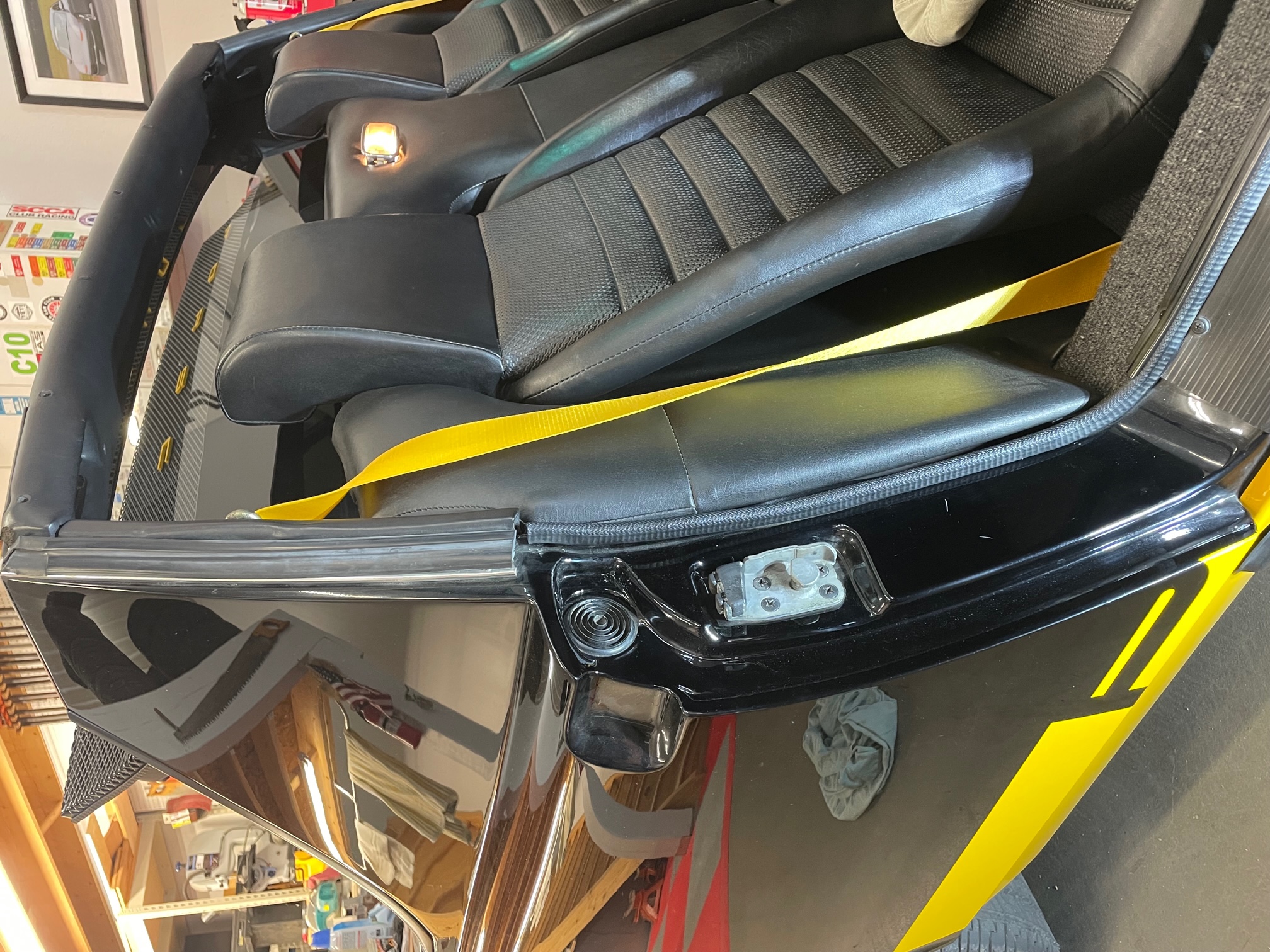

peteinjp
post Jun 23 2023, 06:08 PM
Posts: 212
Joined: 15-July 21
From: Japan
Member No.: 25,723
A pic for reference.

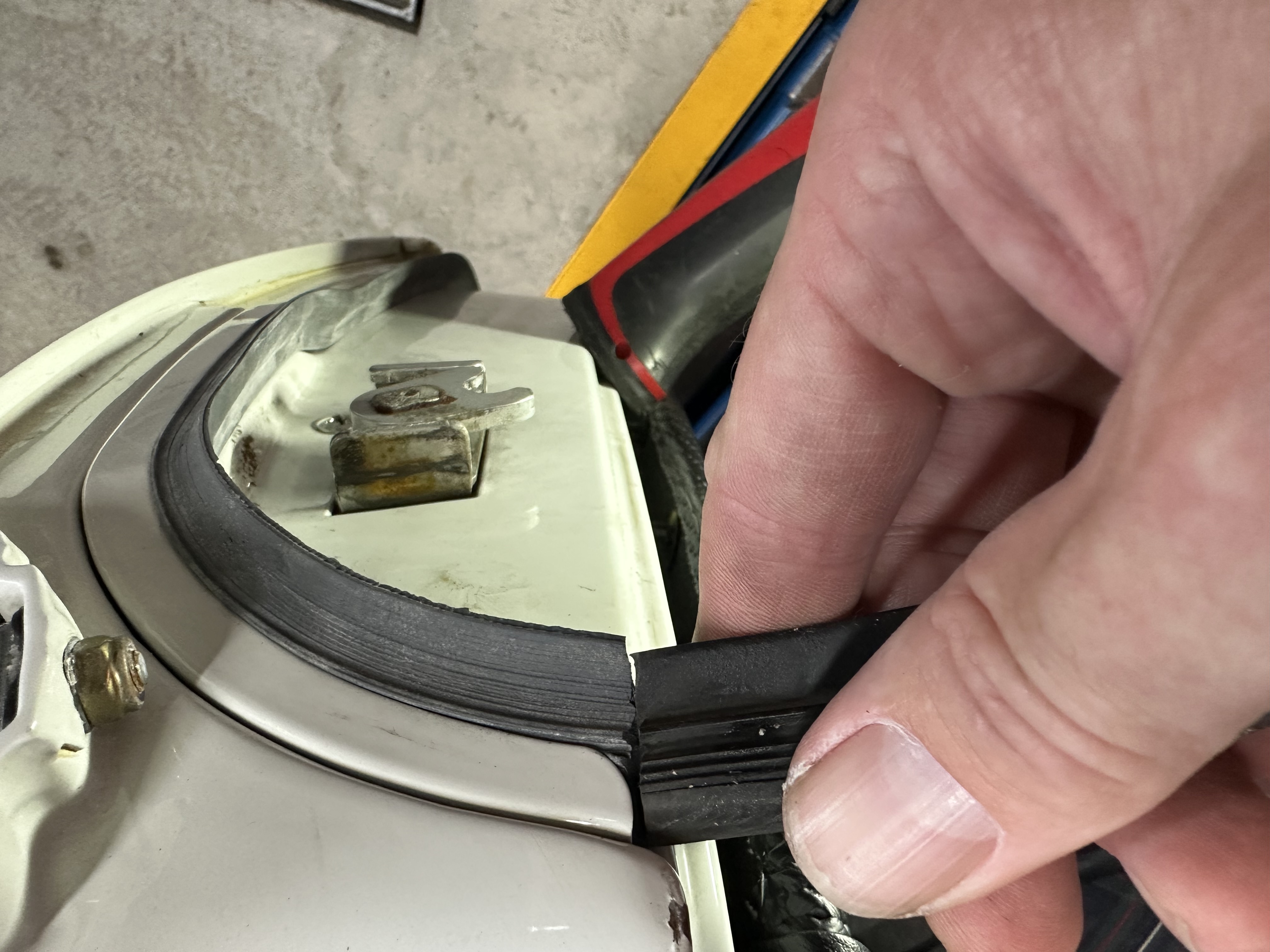

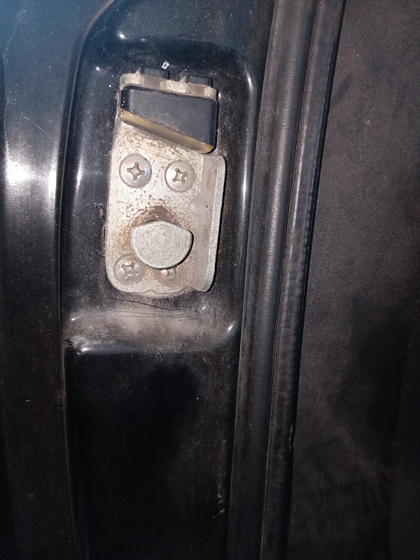

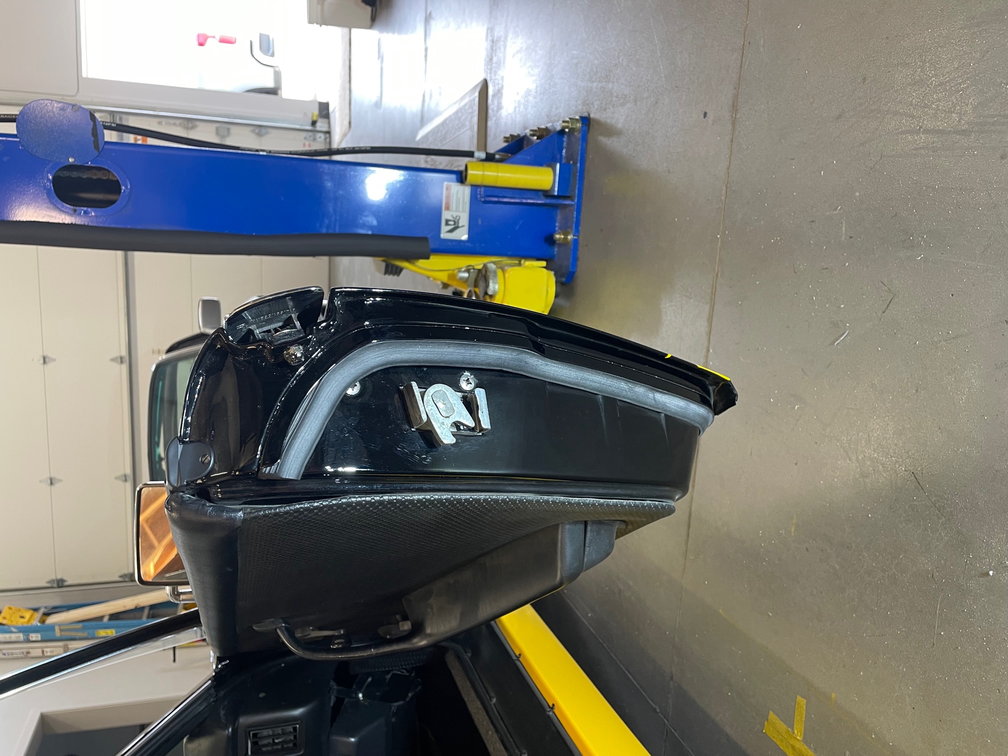

Thanks Rick! So, I sent some pics to the Dr. And your photo confirms that the door seals on my car were installed backwards, and evidently there should be a seal on the door frame as well, and my car has none.
The PO spent quite a bit of money having a shop restore this car, I've spent two years finding and fixing things just like this. Terrible what some shops get away with.

The door seals are backwards. The door rubber is not the reason you are having noise.
In fact we make one that is actually quitter. The material is a neoprene at 25 durometer. It will not hold water like the OEM and actually makes a nice heavy thud when the door is closed letting you know the rubber is making contact and the is ZERO air noise when you drive form the door.
Given the timing of the restoration I would guess you have my door seals. You can tell pretty quickly as they are heavier (due to the density of the material). and are NOT a foam rubber. Meaning that when you look at the end cut, there are no "bubbles" - it is a solid homogenous material.
DO take them out and flip them around. The material will not require glue. You push the edge in at he triangle window seal, and stretch it to make thinner, them push into the channel. When you release the tension, the rubber expands. This holds it into the channel nicely. I think you may find this will solve your problem. (IMG:style_emoticons/default/biggrin.gif)

The inner door also has no seal bulb on it. It should be this -
https://914rubber.com/inner-door-seal-set-1
Notice yours has no bulb whatsoever!.
