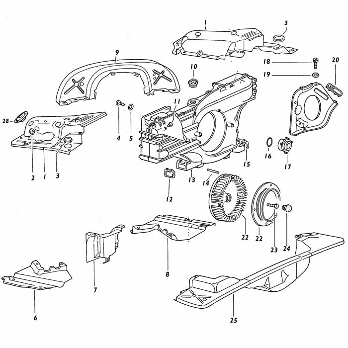

Don't you hate it when PO's take things off the car!!!
When I bought my car (I never really sat in a 914 before let alone work on one) I thought it was pretty much complete. Boy was I wrong. It was missing alot that I didn't know even exsisted. Most of the engine tin was gone but I found that out when I got an old seized-up 1.7 out of a field and saw what I was missing.
Today I was sitting on the throne, going through my Haynes manual and noticed two pieces of engine tin that go on the bottom of the engine.
Air Guide Plates
Item numbers 6 + 8 for a '72 1.7. This would explain why I take so long to get the engine up to temperature.
Does anyone have a couple they would like to sell?

The tin that I was refering to are the ones that go over the push rod tubes, they attach to the block and the HEs. From Doug's reference to the AA site I think those are what he is talking about.

hum, i don't see why you could run the warm air guides with headers ...
Maybe just for the simple reason that they attach to the HEs (IMG:http://www.914world.com/bbs2/html/emoticons/confused24.gif)
Reference pic so Mike can send me the right ones when he finds them (IMG:http://www.914world.com/bbs2/html/emoticons/laugh.gif) # 6 & 8

"wise one....." lmao -- sorry, didn't mean to come off as pretentious.
unless i'm thinking of a different pieces, the air guides attach in part to the heat exhangers. my euro race header interferes with their placement. yeah, i could probably rig something up, but then again, i've never seen a 914 with headers AND these "warm air guides". so i left them off -- i've probably got the set around from my '75 if any wants them (free) -- might take a couple days before i have the time to dig through my stuff and find 'em. i THINK they'll only bolt up to late model HE's, but probably easy enough to modify.

QUOTE (Rhodes71/914 @ Jan 22 2005, 10:41 PM)
i'm baffled ...
i was under the impression they mount to the case/heads ...
but then again, i never had any, so i'm just going on my foggy memory ...

In that image, there are two that are not shown which go directly under the midpoint of the cylinders and attach to the case (2 cheeseheads) and head (1 cheesehead). Heads will not come of engine without removal.
#6 & 8 are well below the others and attach to the case and HEs.

Ok you guys SLITS and ANDY are thinking of a different part. not having those parts installed will over heat a motor very quickly.
Warm Air Guides go under the engine. Drivers side has a bend in it for the shift rod. Also has an attachment point on the back of the thermostate. Passenger side is flat. each is mounted to the lower part of the case oil sump. and also to the HE's. I have a drivers side and ended up making a passenger side out of aluminum. Does it help anything???? Don't know don't have any scientific measuring devices.

In any case, I don't have parts numbers 6 & 8. (and my car takes forever for the cold start valve to close so they can only help in warming up the engine)
For those of you that don't use them, I would like to buy a set.

Doug, I have a set that I can sell. These parts are one of the most rust prone on the car. Does that say something about why they are missing so often?

Well, just to throw my $20.00 in, check your year and engine size as they were different for a lot of the cars. The late model ones are different that the early and the 1.7/1.8 are different from the 2.0 liter. I went through this when I built my 2270 and had to go looking for them. They are also different from side to side. I like the idea of making my own from aluminum as Joe said. I will do that on mine next time if they are missing.
I think this is the route I am going to go. With the combo of 2L engine and 1.7 HEs I would have to modify anyway. Shouldn't be to difficult.
