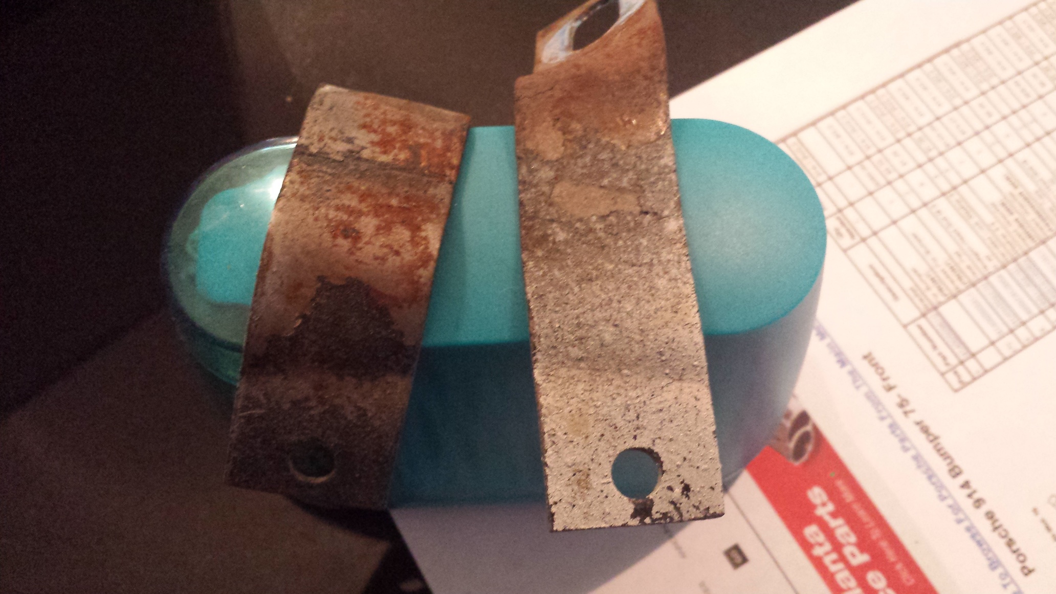

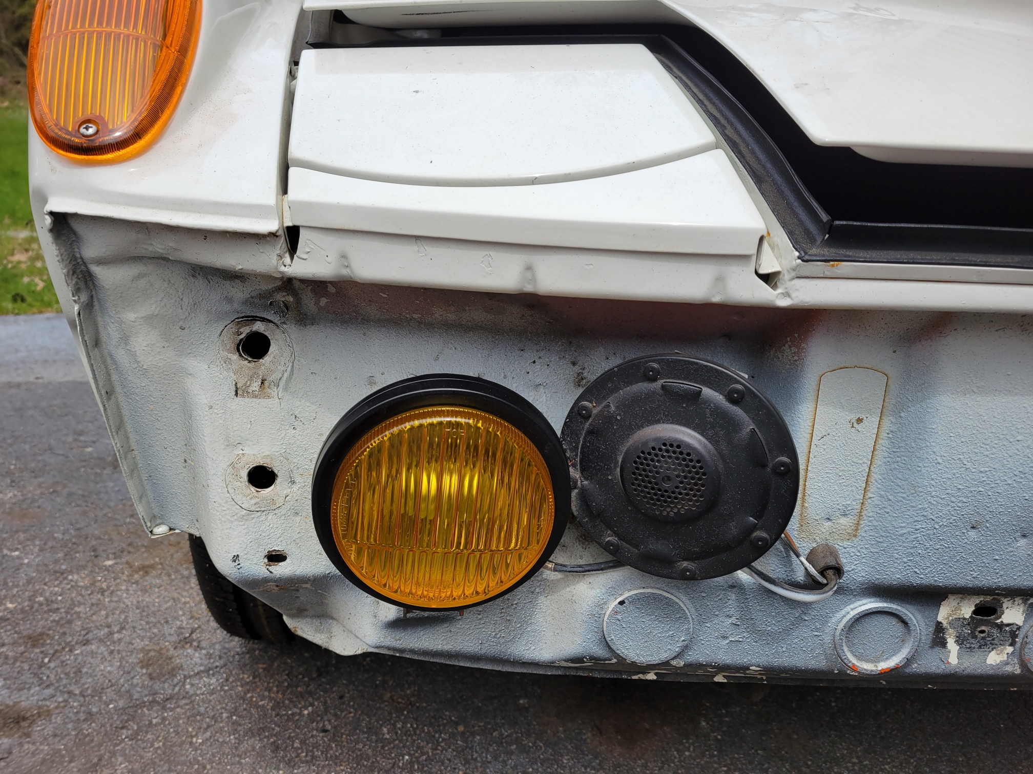

Sometimes I find my lack of "mechanical common sense" appalling. When recommissioning my 914, I wondered why Porsche would install the spoiler so that you needed to almost remove the bumper to get it off.
As my spoiler was long gone I had no template and assumed they fastened from the outside in.
In retrospect inside out makes more sense as you can see in the far lower left, and far lower right, there are slotted cutouts in the "latch panel" to allow some variance to align with the captured speed nut locked onto the spoiler.
I used thin bits of rubber on each side, of each spoiler mounting point to reduced vibration fracture possibilities.
While my spoiler was unfortunately long gone, who ever put the cow catcher on as a replacement was a little to lazy to fully remove the original supports.
Like Jeff's example mine had slanted creases on the bottom which I suspect ever so slightly allowed for better alignment to the spoiler when properly installed L/R.

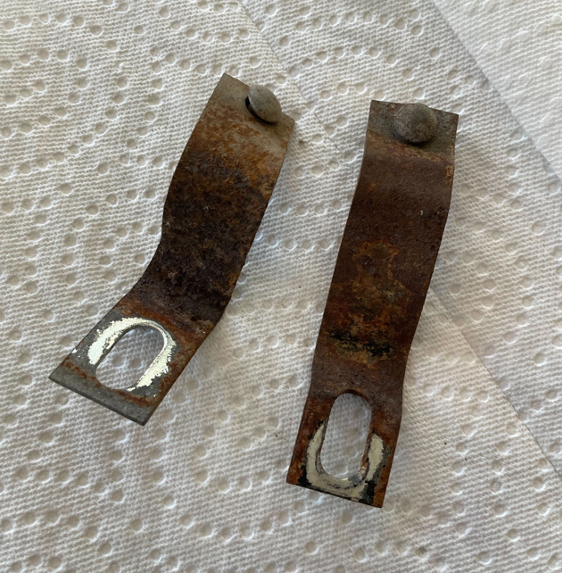

(IMG:style_emoticons/default/popcorn[1].gif) My LE's spoiler wasn't original but I think the hardware was. Now I need to go find the box that I stored them in and check.
UPDATE: Here are mine. They look original but who knows. I will clean them up and get them looking that way thanks to this post.

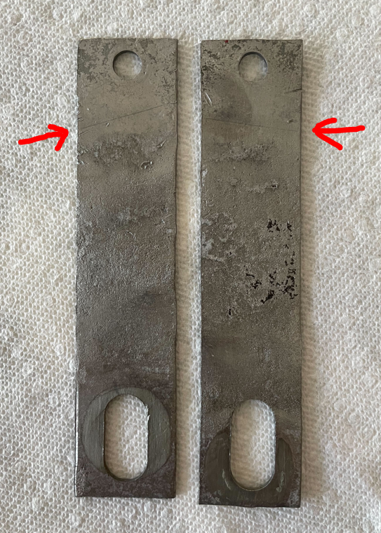

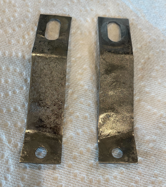

Ok, this is definitely original hardware. Once I got the rust and old paint cleaned off, you could see the crease lines (arrows). I went ahead and bent the pieces back to something close to original. I'll finish prep on them later. I know they'd zinc plate but I think painting them might be the better option.

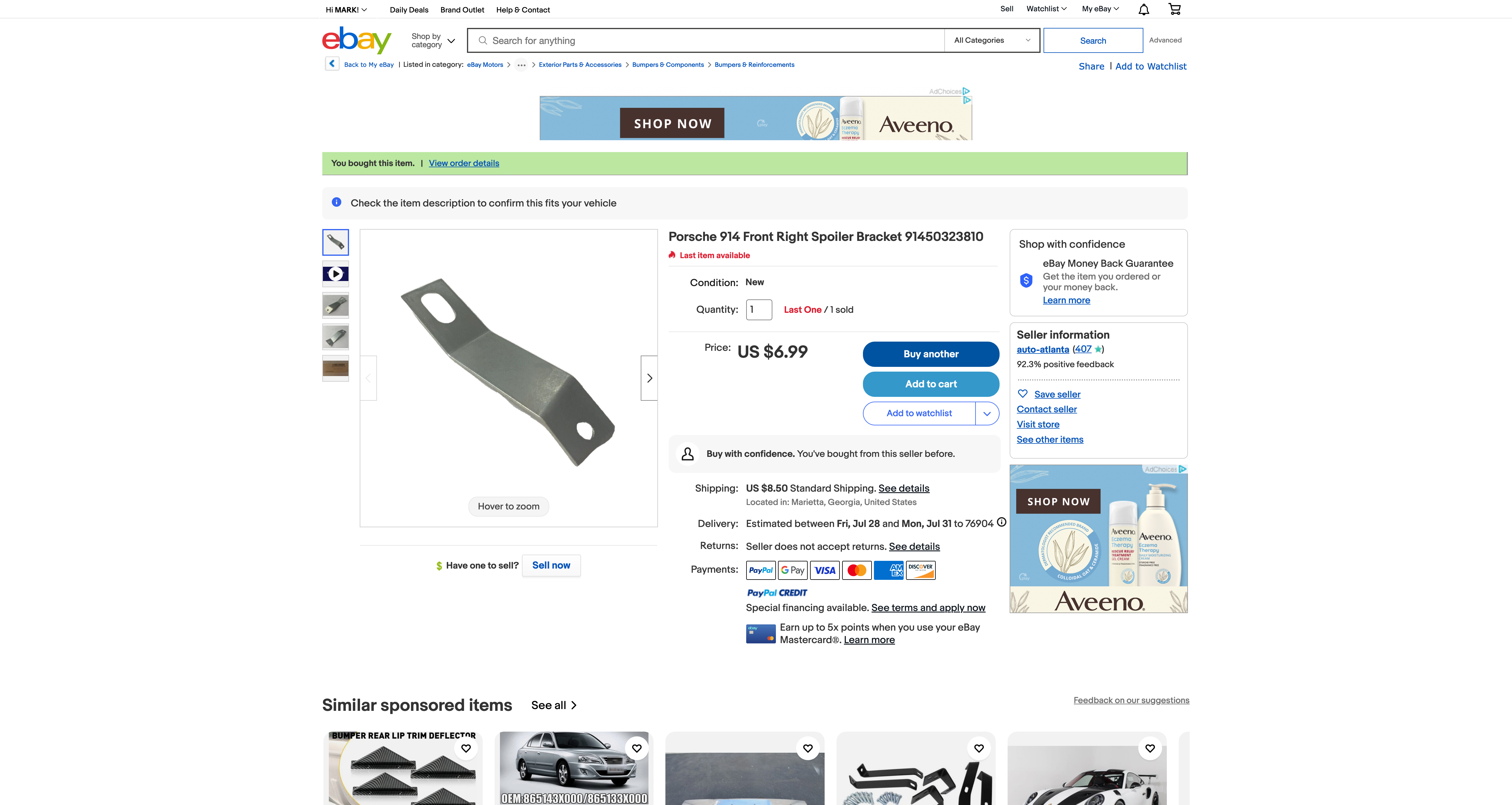

where did you get them Mark?
914Sixer
post Jul 25 2023, 10:38 AM
Post #28
Posts: 9,453
Joined: 17-January 05
From: San Angelo Texas
Member No.: 3,457
George, I got them from you. They were listed on Ebay. One right side left still I think.

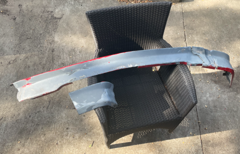

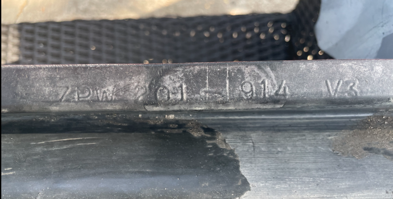

Not to hijack this thread too much but I had a question. I'm under no illusion here. I realize that my LE Spoiler is NOT original. While it's in pretty bad shape, I did notice it had a serial number on it: 7PW 201 914 V3. Does this mean anything to anybody? I was going to trash it but if it's worth saving I might consider repairing. I'm sure I can get this looking new again but it'll be a lot of labor. To me this is junk, am I correct?

That’s the vintage VPC aftermarket LE-style spoiler. A nice example is prolly worth a Little more than todays reprise but not much more. I have details on my Classics site .

Thanks for the info, Jeff! Is the "classic site" the LE registry? Or, something else? I may go ahead and repair it.

My Classics page link is in my signature block.
https://bowlsby.net/914/Classic/
Accessories page, about half way down.
