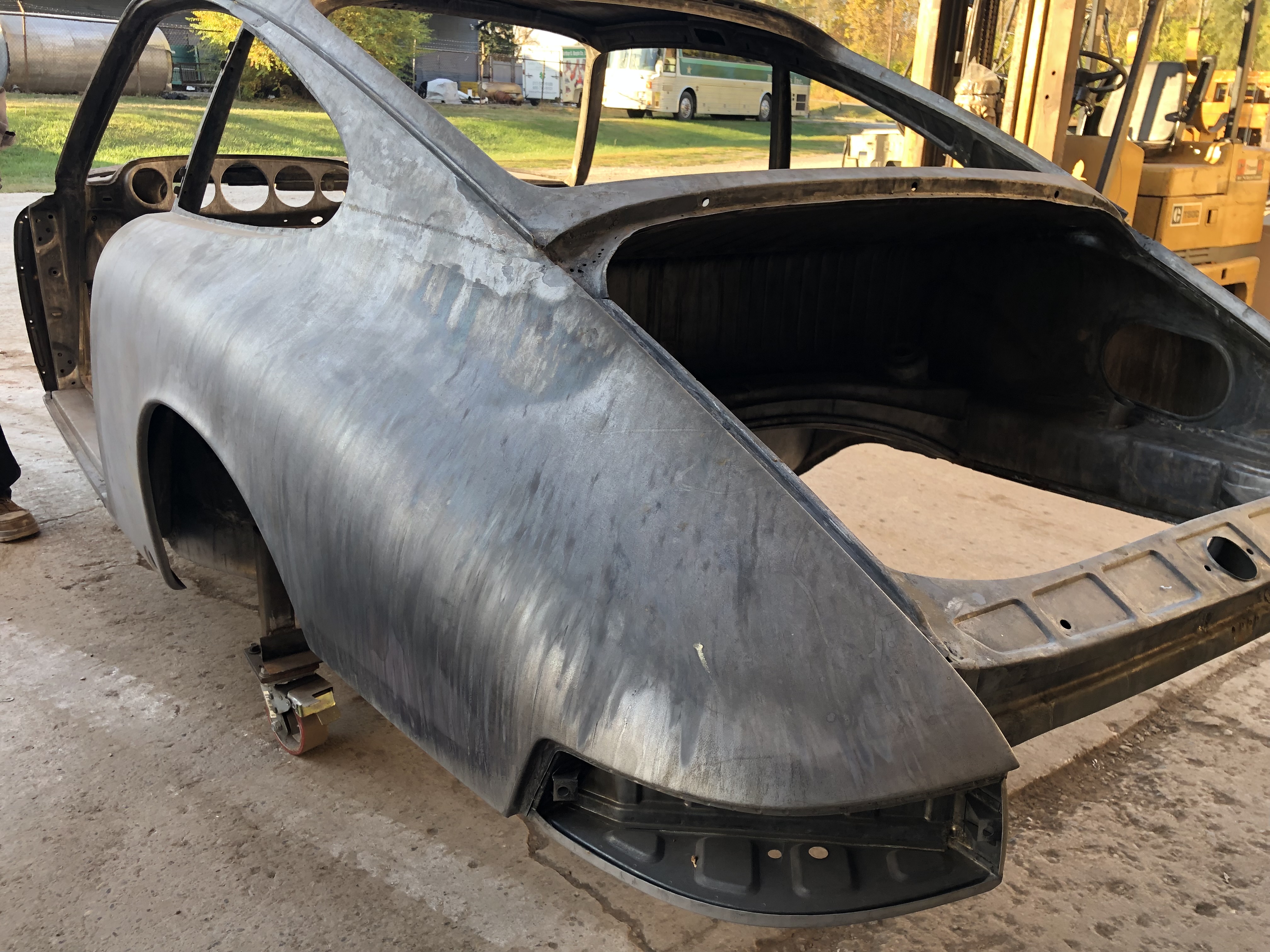

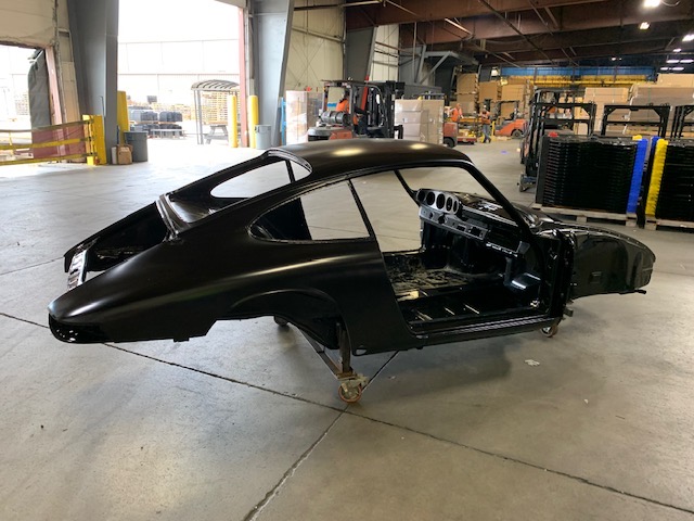

I’m a big believer on getting the car chemically dipped. It’s the only way to clean up all the inside layers of metal. Our cars really do rust from the inside out, particularly where the seams were spot welded. Any time you weld metal, it’s going to burn off all the protective coatings. However, once you dip the car, now it’s 100% raw metal and you have to e-coat it to get that protective layer back on every seam and inner layer. Sprayed on primer and paint won’t recover the metal that the chemical dip exposes. So plan on another $3-4k to get the e-coat done.

wow thats really cool, pretty good for a 50 year old car, i guess some work was done in the past before the repaint, with that brazing etc, that will be a super nice car when completed, hope the do the e-coat like Mark said. will be better than new.

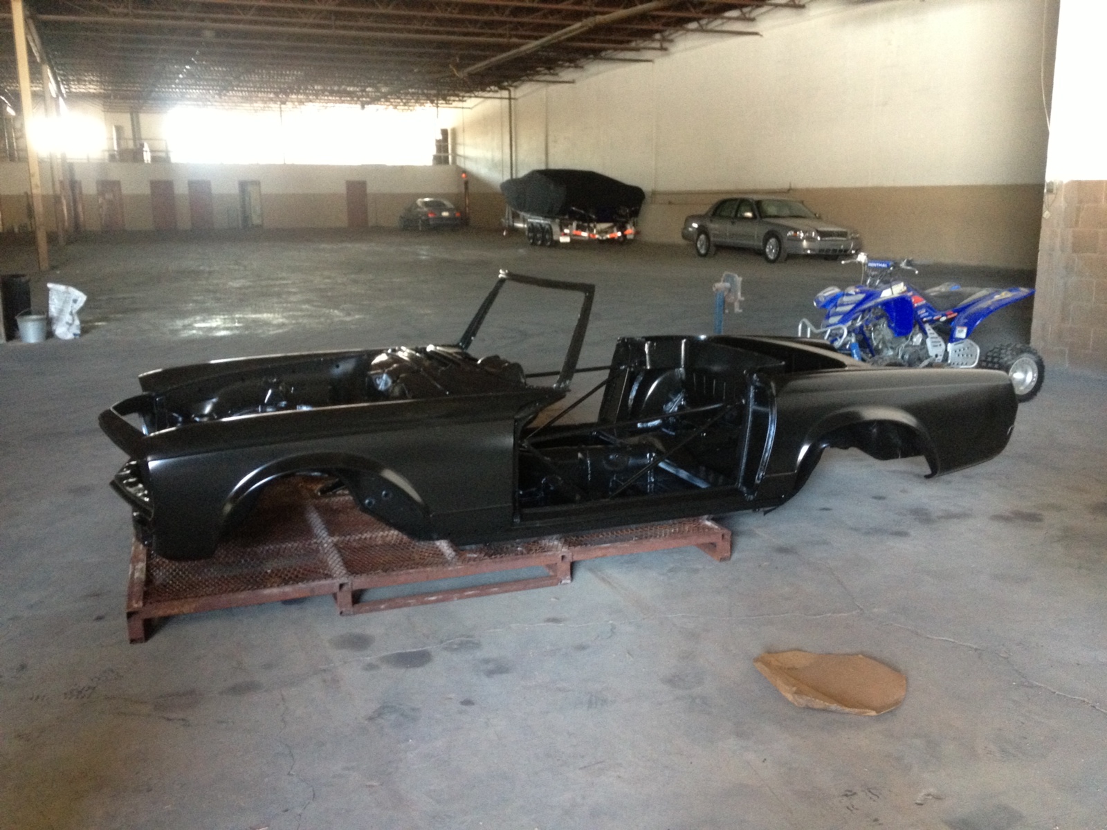

I agree with the E-coat process. I did this Mercedes for a friend.

The only car I've had dipped was a 356. I remember they had to drill a few holes in the fenders to let air escape. A major process for certain.

Yea, they drilled a hole in the roof of my 67. They told me ahead of time. Jared filled it in for me.
