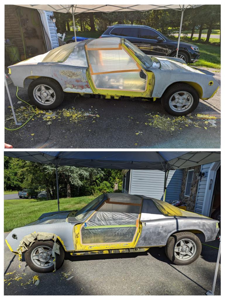

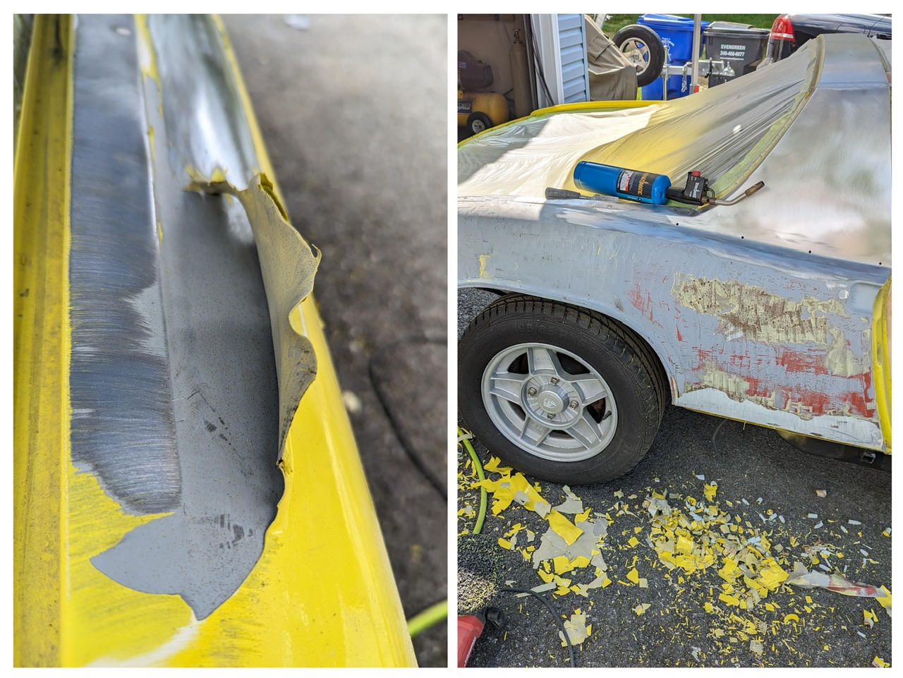

After laboring through the gummy nasty second layer of paint on the driver side rear quarter, a funny thing happened on the passenger side. I noticed a small section delaminating as I was working with my coating removal disc. So, I pulled on it a bit while it was still warm.
My instinct was correct, the paint was not at all bonded… anywhere.
So, I took a torch and chisel and stripped it like old house paint lol! Unfortunately, I found a terrible excuse for dent repair that was rusting away underneath. Because I have all the records for this car, I know exactly when and who did this “repair”. What I didn’t know until today, was the extent or quality.
I suppose one silver lining is that this was the fastest I’ve ever stripped the paint off a car lol… and dust free!

at this rate when i touch down in dc to check out the lunar module in the smithsonian - i won't get a ride. (i'm really going to check out the plywood german flying wing from WW2! (IMG:style_emoticons/default/smile.gif) and the Bee five two if they have one? (IMG:style_emoticons/default/biggrin.gif) )
@StarBear will have to come to the rescue with his bernardsville vicinity original so i can relive my wasted youth enjoying your fine country back in the late 80s.
i shoulda stayed, married the girl and become a citizen.
then i could drop in and help you rip the paint off.
keep going. it will be great.
esp if you can reproduce that fantastic undecideable yellow or is it green.
same as phoenix red or is it orange. (IMG:style_emoticons/default/beerchug.gif)
its still a good car despite the minor prang in its distant past of being (IMG:style_emoticons/default/driving.gif)
i'll be demanding an up close special clearance inspection of an F117 if i have to stand around your car on jack stands drinking a beer.

Wonki I noticed that the left and right side photos show the color change perfectly. Bright yellow in the infrared and yellow green in the UV shade. The blue light from the awning definitely helped it slow up on camera this time.

Paint delaminating is what lead me to paint my '76 too! I was able to strip the lids and large areas in other spots with a scrapper and a couple of boxes of razor blades. In retrospect I'm glad it happened or I would have missed the (IMG:style_emoticons/default/stromberg.gif) qtr panel repair. What is a coating removal disc Van? @wonkipop you might consider adding the Space and Air Museum in San Diego to your travel plans. https://www.sandiego.org/members/museums/sa...ace-museum.aspx

@76-914 I use these bad boys in 7” diameter on my polisher.
https://www.3m.com/3M/en_US/p/d/b40071650/
Doesn’t gouge into the metal unless you get on the edge accidentally. And with a polisher you can slow it down to control the heat you put into the panel.

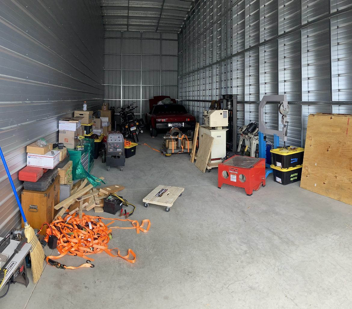

(IMG:style_emoticons/default/WTF.gif)
The last time I looked at this thread you and Wonki were talking about furniture (IMG:style_emoticons/default/screwy.gif)
Now I check in and the car is torn to bits and missing paint. (IMG:style_emoticons/default/stirthepot.gif)

Sadly . . . No. Mine is buried in storage while it awaits its new home to be built. It’s even more buried than this once I got all my parts and shop equipment in there
I’ll have to live vicariously though your project (IMG:style_emoticons/default/happy11.gif) .

I got some of those but I didn't know the name and I don't have any that large. I've got some 4" ones that go on an angle grinder and 2" roloc style. I wish I'd known of the 7" that fit my polisher. (IMG:style_emoticons/default/headbang.gif)

quite a multi storey shed you got there mate.
you could really bury a 914 under a lot of sedimentary layers of "kipple".
i think that is the word phillip K dick used........for stuff or .......whatever.
its kind of like where i live.
no windows.
but i am top lit.
(IMG:style_emoticons/default/beer.gif) (IMG:style_emoticons/default/biggrin.gif)
