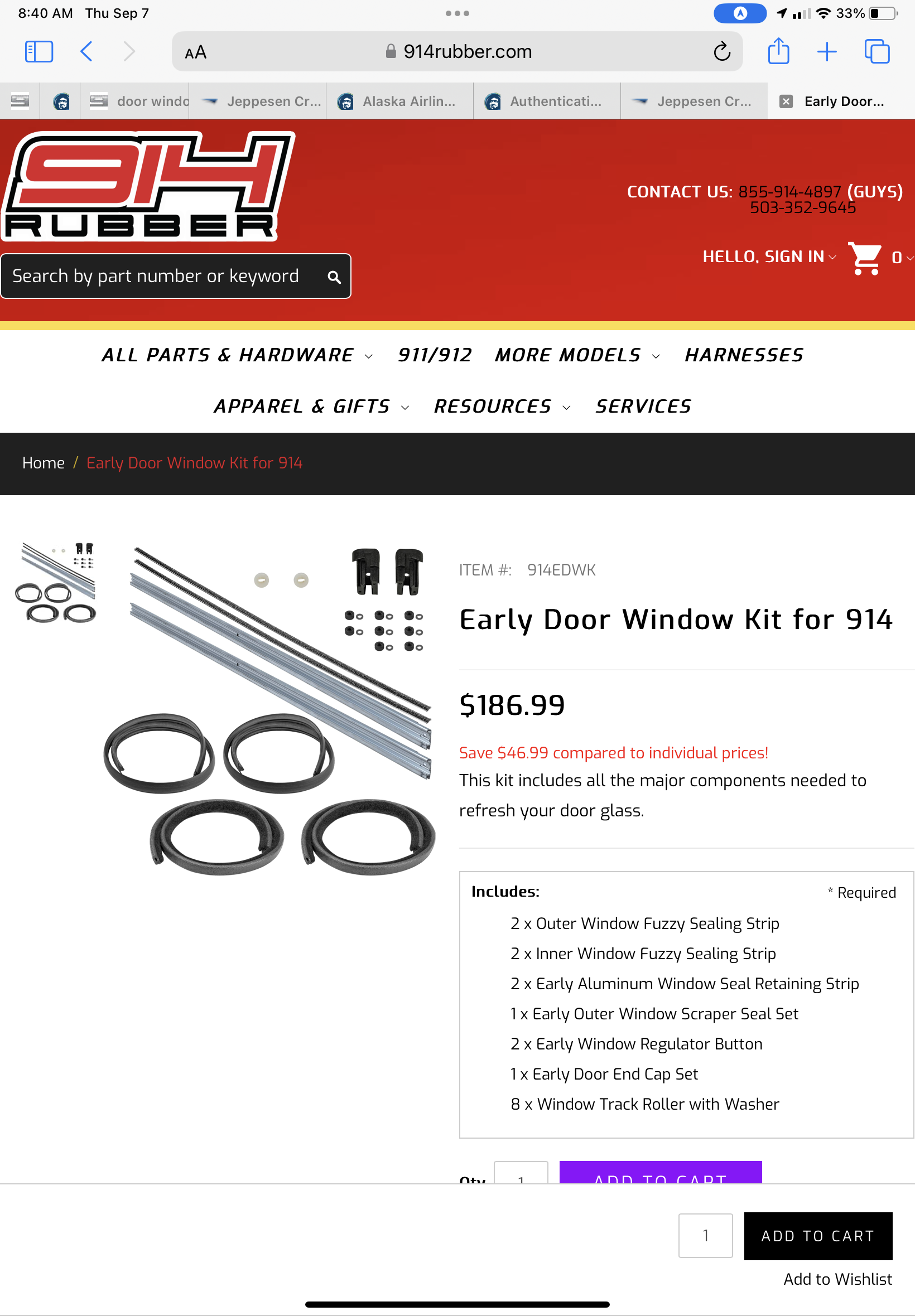

post Sep 7 2023, 09:47 AM
The rubber man
Posts: 12,772
Joined: 27-December 04
From: Hillsboro, OR
Member No.: 3,348
Here is a picture and link to the entire kit. You may not need all of it but you can see what the parts are.
You are looking at the top of the inner door fuzzy closest to the driver.
There are several parts to look at while you are there, the kit takes care of most of them.
https://914rubber.com/early-door-window-kit-for-914
Do note the window buttons, as it’s a great time to change them out.
The only other thing as a while you are there item would be the door cam actuator. (IMG:style_emoticons/default/biggrin.gif)
