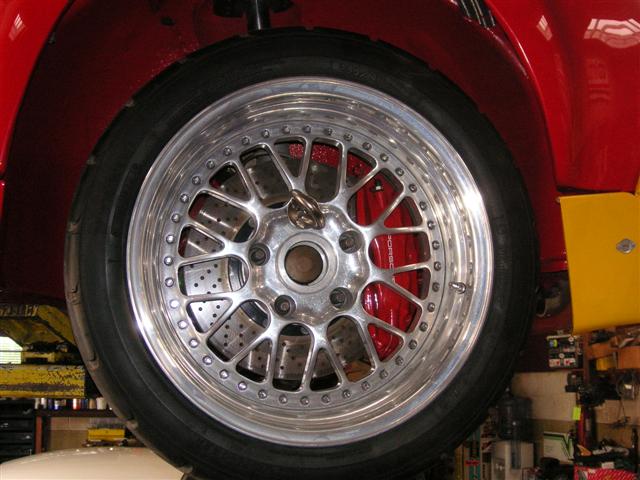

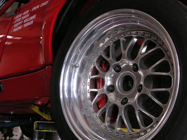

Mike,
I am using a 993 Twin Turbo front on my Teeners front
xitspd
post Feb 16 2005, 10:05 PM
Post #36
Technology and Tradition 3.6 and 914-6
Posts: 1,305
Joined: 17-November 04
From: Foothills of Mt. San Jacinto, CA
Member No.: 3,136
QUOTE (xitspd @ Feb 16 2005, 08:04 PM)
Mike,
And a 993 Twin Turbo rear on the rear with good results.

QUOTE (xitspd @ Feb 16 2005, 09:04 PM)
Mike,
nice.... (IMG:http://www.914world.com/bbs2/html/emoticons/drooley.gif)
according to a chart I've read....the piston area of your front calipers are 2X larger than the rears (IMG:http://www.914world.com/bbs2/html/emoticons/smile.gif) ...they have the most amount of front bias than any other P-car (production)..... 2:1
love your car (IMG:http://www.914world.com/bbs2/html/emoticons/pray.gif)
