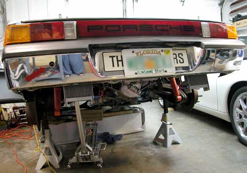

I got some bigass jackstands. They are rated at 6000 lbs each but mainly they go real high. So those I put under the rear control arm points. I can pretty much sit upright under the car.
The front I jack all at once using a 2x4 and aluminum plate that spans the front suspension pickups.
I lift the rear of the car all the way up using a big jack on the motor mount bar, right where the shift rod opening is.

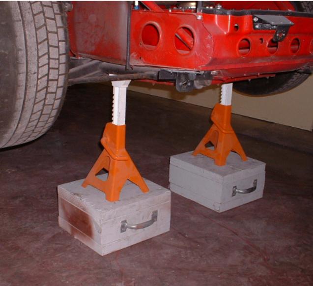

I made these blocks....

QUOTE (URY914 @ Mar 6 2005, 08:41 AM)
Nice crafstmanship Paul, looks like Fred Flintstone's luggage (IMG:http://www.914world.com/bbs2/html/emoticons/biggrin.gif)
Actually the deal with jacking the front with a 2x4 came from one of your posts a while back.

I found it is important to keep the car level when on the j-stands.
Much easier to lower the engine when the car is level. The mounts slide off the bolts and don't bind in the holes.
Once the engine is resting on the jack and out of the car, than jack the ass of the car up and lower the front stands so you have more room in the rear to get it out.
I would always take the wheels off if not using ramps, of course. Gives you more room to move around and access.
Also go slow. You're not at LeMans trying to get back into the race.(IMG:http://www.914world.com/bbs2/html/emoticons/driving.gif)
