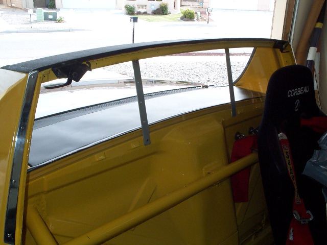

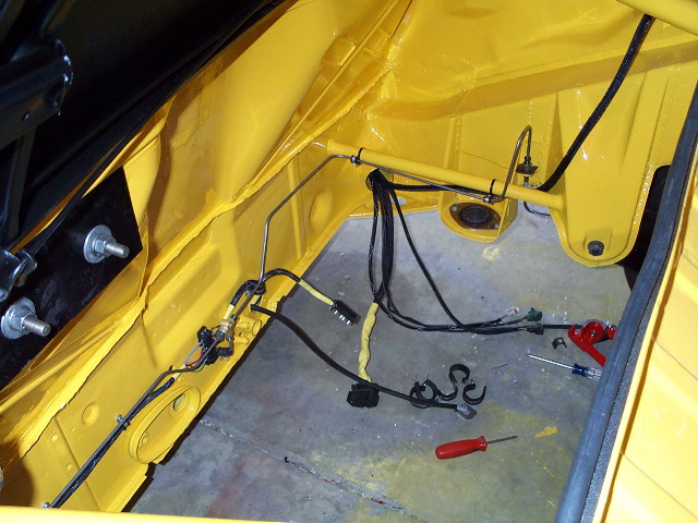

Remove the window, mount it on the inside of the targa bar? or tube a rod halfway up between the sails inside?
Thanks for the pics 914RS and Dave... I kind of dont like the idea of boring holes through my firewall... But they'd be just big enough for the bolts, i can manage. Then leave the insulation there. And most of all, I don't like the DickBelt™ idea (5th/6th belt between the legs). I'd rather maintain my nuts in the event of a crash. This is something I was looking at doing in the near future for safety. In (local) race events you don't get dinged for safety features like a tube frame rollcage, harnesses, bigger brakes...

One of the priorities for my setup was that no holes had to be drilled. (My fire extinguisher mount, too!) I used the stock factory-supplied mounting holes for all of the belts. The shoulder belts are attached to the harness bar, and the lap belts and sub straps (AKA DickBelts) are attached to eyebolts in the factory lap-belt holes. I also kept the stock three-point belts for street use.
Note that some sanctioning bodies do not allow you to attach the shoulder belts to the harness bar. And more of them do not allow you to attach two belts to the same chassis attachment point.
