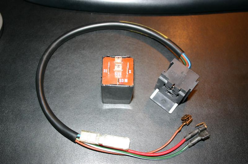

Here is the entire harness and the relay...

i can make that..... just need the relay socket..... and a relay... what does it plug into?
have a schematic?

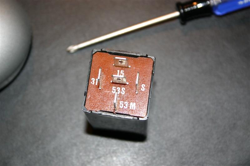

Here is a close up of the relay...
Here is the connection order starting at the top and going clockwise.
I am looking at the bottom of the relay where the pins are...
Pin 15 (top) goes to red
Pin S (3 o'clock) is not connected
Pin 53N (6 o'clock) goes to blue/black
Pin 31 (9 o'clock) goes to brown
The center pin 53S goes to white.

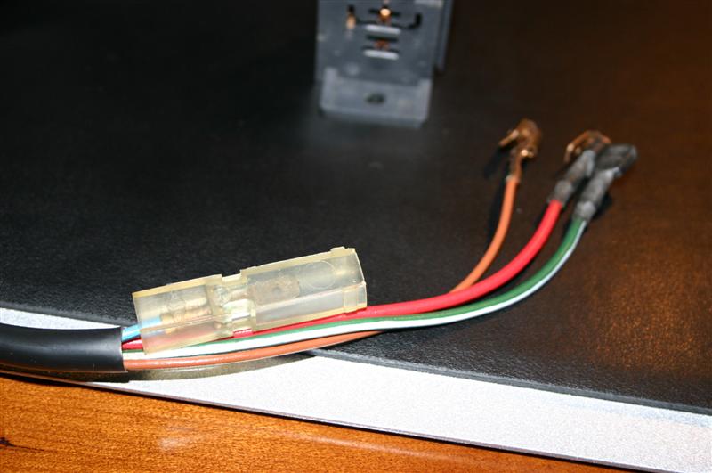

Here are the end connectors...

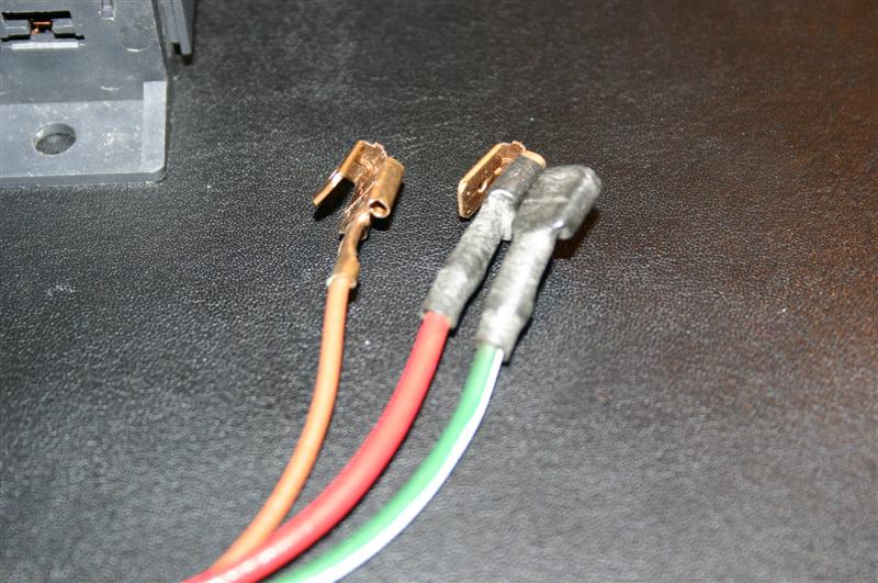

Another...

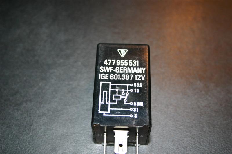

The harness is part number 914.612.148.10
The relay receptical on the harness has the following part number on it 3 334 485 008
The relay is shown below...
