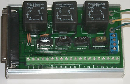

here is a picture of the relay board I'm going to use (I think)
the one pictured has the ground/12vdc switch/12vdc main power lines soldered to the board, I don't like that so I am looking for something I can more solder to the board so I can use terminals or the like......

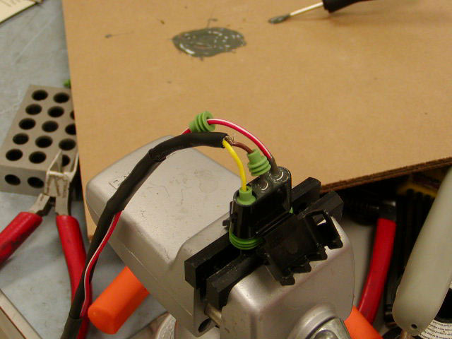

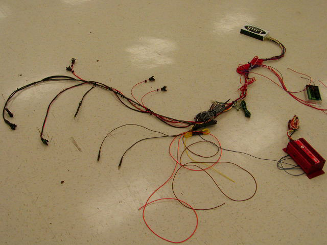

spent some time tonight on the new harness...oh boy, what a bunch of work....
Mueller

it'll take a few revisions to get it perfect (IMG:http://www.914world.com/bbs2/html/emoticons/wacko.gif)

for the GM Weatherpack connectors, I added a little bit of potting compound to ensure a watertight fit (IMG:http://www.914world.com/bbs2/html/emoticons/smash.gif)
yes, the little rubber gromments are backyards on this one...no big deal with the potting compound (IMG:http://www.914world.com/bbs2/html/emoticons/screwy.gif)
