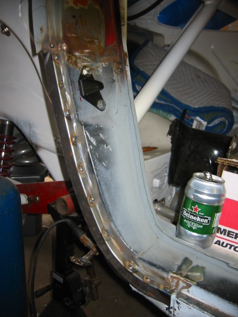

On my 911 I cut part of the door jambs off to allow access for rust repair, Then I needed to recreate part of the door jamb to support the glass quarters I was hanging on the car..
this pic show the top and bottom part of the door jamb, I have to recreate the bottom half of the door jamb...

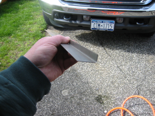

First I think 22 gauge is more than sufficient, so I bent a piece, a 90 deg 3/8 X 1"

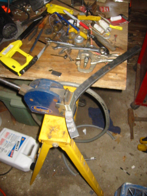

Then I used the shrinker/stretcher to form this piece to match the door jamb

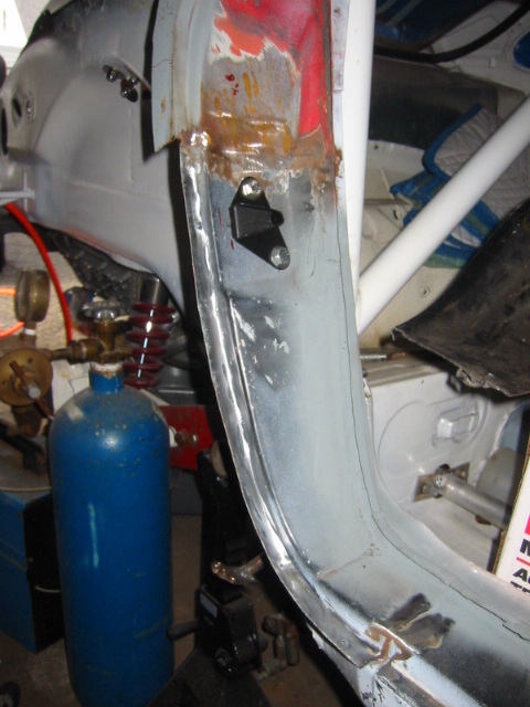

Here Ive welded the piece in

Shoot some zinc primer to hold it

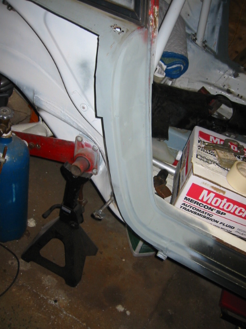

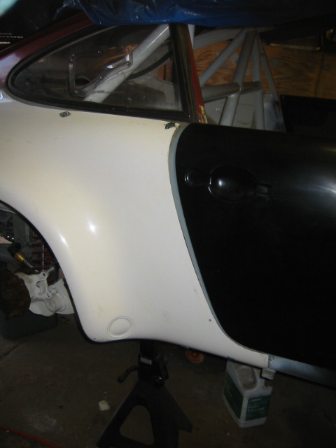

door and quarter panel rehung

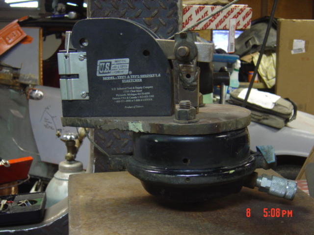

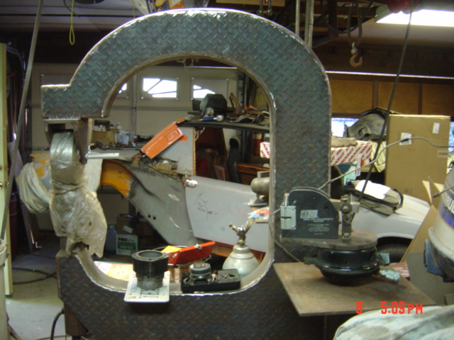

I might suggest one mod to the shrinker you will love!! This is a FRONT air brake off of a truck, with the shinker on top. You will have to make a mounting plate to bolt the shrinker to, then bolt the plate to the air brake. Lengthen the arm on the shrinker and fab up a mount for the piston on the air brake to bolt onto the shrinker arm. (I used the clip that came on the brake, already threaded, just had to cut apart and move the arms out some.)! (IMG:http://www.914world.com/bbs2/html/emoticons/biggrin.gif)
scotty b
post May 8 2005, 04:23 PM
rust free you say ?
Posts: 16,375
Joined: 7-January 05
From: richmond, Va.
Member No.: 3,419
In an effort to keep things compacted (as you can tell I have little werking room) I put an upright arn on each side of my E-wheel with a vise on one side, the shrinker on the other and when I get time to werk on the monstrosity again I will put a removable arm on the backside for my Beverly shear and any other future items.

Ive seen shrinker/stretchers with rams etc that power them, I prefer to run them by hand, I like to have the "feel" of how the metal is responding to my inputs. I think that will be lost if the tool is pneumatically aided

oh yea, wish I had an english wheel.. you fabbed that frame yourself?

QUOTE (TimT @ May 8 2005, 05:14 PM)
Yup. 3/8 diamond plate with 4" spacers running through the inside and a 4" x 4" box frame under it. Been werking onit for 2 years and still not happy enough with it to paint it (IMG:http://www.914world.com/bbs2/html/emoticons/wacko.gif)
