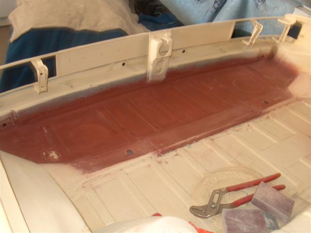

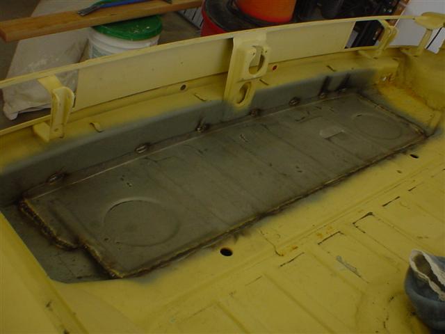

rdauenhauer   Posted on May 19 2005, 11:20 AM Mark did you lap or Butt weld that piece to the cross brace?
I know this was directed to Mark, but I just did my trunk panel too, I trimmed all but a half inch off around the center brace edge, ground the lip flush on the rear panel, and then lap welded.
Lou W

Another
