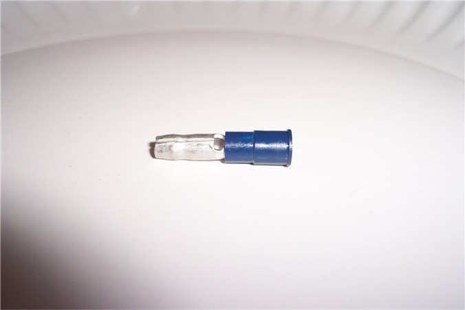

I found this at a local FLAPS. It was still slightly loose so I squished it a little with pliers.
Ed
